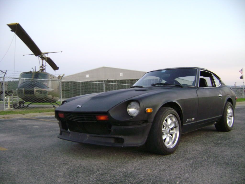

z-ya Posted July 12, 2010 Share Posted July 12, 2010 I'm running Eibach springs with 225-50R15 on 15x8" zero offset wheels. No rubbing. Quote Link to comment Share on other sites More sharing options...
FlatBlack Posted July 12, 2010 Share Posted July 12, 2010 (edited) I'm running Eibach springs with 225-50R15 on 15x8" zero offset wheels. No rubbing. x2 [but Tociko not Eibach, and a +4 offset] Edited July 12, 2010 by FlatBlack Quote Link to comment Share on other sites More sharing options...
