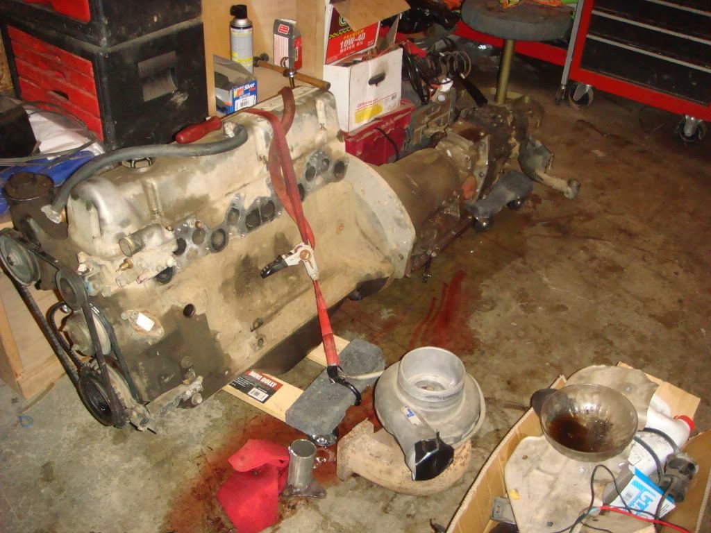

zcar? Posted July 26, 2010 Share Posted July 26, 2010 (edited) I'm looking for an individual that did a conversion who is from the northwest. I have done it, I'm in portland oregon, its not all that hard to do really. I still have all my prints I think. let me know and I will look for them. here is what my conversion looked like: Edited July 26, 2010 by zcar? Quote Link to comment Share on other sites More sharing options...

zcar? Posted July 26, 2010 Share Posted July 26, 2010 AHA!! I was hoping you'd chime in. I would be very interested in any info you're willing to share. What transmission did you use? What did you do for a converter and how did you manage the convert mounting? Thanks again for any info you can provide. Bernard After a search on your posts I see that you're willing to make another adapter so that's the way I'd go if you're still up for it. I would be more than willing to make another run of adapters. where are you located? in the northwest I hope. I used a th350 but you can use any trans that came behind a sbc. and the converter just bolts to a stock flexplate from gm. pm me what you want to do and we can talk about it there. Jeremy Quote Link to comment Share on other sites More sharing options...

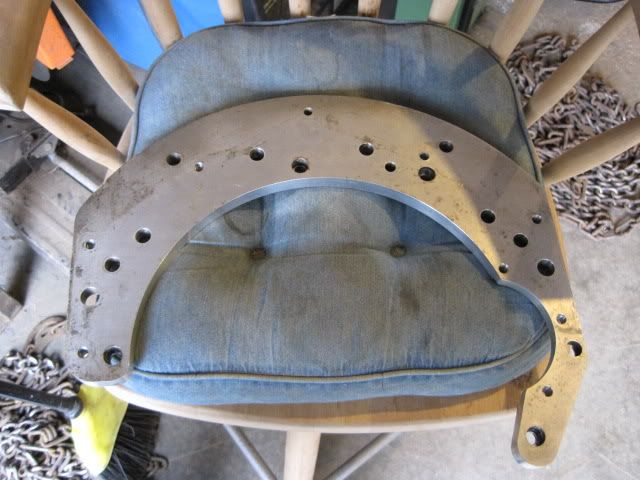

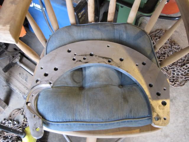

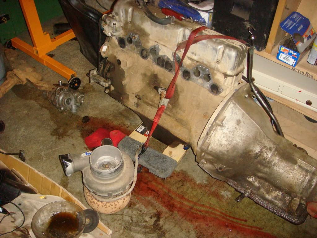

240Z Turbo Posted November 7, 2013 Share Posted November 7, 2013 (edited) I had to dig, but I thought I would provide what information I still have on the swap. If "Zcar?" can get the adapter plate in 0.5" aluminum (I think that was the thickness of my old adapter, Spork can verify) you can then use the following information. I used the following company to manufacture the flex plate adapter from steel as well as the ringless flex plate...http://www.wilcap.com/ Below is a picture of the flex plate adapter and here is the drawing file name "flexplate_adapter.prt.4" in the following folder...http://www.eng.fsu.edu/~jthagard/3liter/pics/trannyadapter/ (please verify it is the same dimensions as the picture below) Use the above folder to see the pictures for how the setup was installed, which I will show below... Flex Plate adapter First step was to install the adapter... Next install the OEM flywheel, which I think was from a maxima I then installed the flexplate adapter I then installed the Wilcap flex plate At this point the back of the L28 will mirror a Chevy engine so you can use off the shelf converters and transmissions. Edited November 7, 2013 by 240Z Turbo Quote Link to comment Share on other sites More sharing options...

240Z Turbo Posted November 23, 2013 Share Posted November 23, 2013 Once you bolt up the transmission, you simply pull the converter forward until it seats on the ringless flexplate. There is a 0.5" gap between the OEM flexplate and the ringless flex plate, which allows sufficient space to install the converter bolt. You then rotate the crank and access the next bolt until you are done. Quote Link to comment Share on other sites More sharing options...
