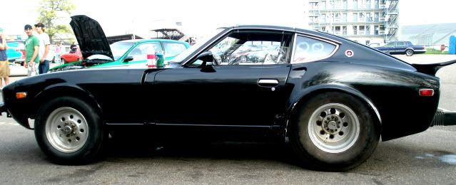

mnmkiv Posted July 29, 2010 Share Posted July 29, 2010 ok so i am trying ot part out my drag car and it has what i am told is a california Z wide body kit. now i know i can simply un bolt the front fenders but my question is can i some how remove the fender flares in the rear??? not the best pic but at least you can get an idea what i am talking about. any advise on how to get it off?? thanks Quote Link to comment Share on other sites More sharing options...
GOTHALOSISM Posted July 30, 2010 Share Posted July 30, 2010 If they are molded in the best way is probably to use a cutoff wheel and be very very carefull. To bad your not close to me in vegas I would help you and then buy them from ya. Quote Link to comment Share on other sites More sharing options...
Chartoo Posted July 30, 2010 Share Posted July 30, 2010 Hope you dont find anything nasty under the fibreglass. I found expanding foam under mine which had soaked up water and started to rust. Quote Link to comment Share on other sites More sharing options...

cygnusx1 Posted August 31, 2010 Share Posted August 31, 2010 (edited)  Yes that's the Cali Z Kit sold through Jim Cook Racing back in the 80's 90's.  You might try leaving them on there and selling the shell intact with the kit, if the shell is usable. Edited August 31, 2010 by cygnusx1 Quote Link to comment Share on other sites More sharing options...
ModernS30 Posted September 10, 2010 Share Posted September 10, 2010 Judging by the tires, that car is tubbed, if that is the case, the factory fenders will be cut and won't look factory. Quote Link to comment Share on other sites More sharing options...
mxgsfmdpx Posted September 22, 2010 Share Posted September 22, 2010 Judging by the tires, that car is tubbed, if that is the case, the factory fenders will be cut and won't look factory. Is the cali Z kit actual fenders with flares, or were the flares a separate piece molded on? Quote Link to comment Share on other sites More sharing options...
19762802+2 Posted September 22, 2010 Share Posted September 22, 2010 Is the cali Z kit actual fenders with flares, or were the flares a separate piece molded on? Flares were a seperate piece so you would have to cut them off or you could just cut the whole fender off. Quote Link to comment Share on other sites More sharing options...

sticky280zx Posted September 22, 2010 Share Posted September 22, 2010 guy, i will trade you a very clean 280z shell for that car...that way you dont have to hack it up...im sure alot of other people wanting to stick a v8 in these would be willing to trade as well. Why cut up a car if its already done instead of just getting another shell and swapping whatever you want/need from that car over? Quote Link to comment Share on other sites More sharing options...
