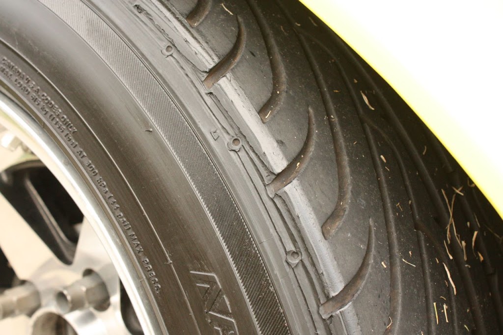

BLOZ UP Posted September 17, 2010 Share Posted September 17, 2010 I just picked up some 16x8-0 XXR 513s for my '77. I'm putting some 225/50 tires on all four (since I had them laying around). Oh noessssss I have stock suspension though. Quote Link to comment Share on other sites More sharing options...

BLOZ UP Posted October 7, 2010 Share Posted October 7, 2010 Yup, I got them on and I'm having the issue only on the DR fender. That strut is also seized I believe, so it doesn't rebound properly. I picked up some newish rear struts. Also have a disintegrated mustache bar bushing right now, so it'll be a while till I get around to 205s and see. Ugh. I don't want to fork out money for 4 new tires... Quote Link to comment Share on other sites More sharing options...

BLOZ UP Posted January 21, 2011 Share Posted January 21, 2011 I think I'll just trim the fender, it only needs a couple mm. Then I'll roll it just slightly. Quote Link to comment Share on other sites More sharing options...

BLOZ UP Posted January 25, 2011 Share Posted January 25, 2011 For me, it's only one wheel that rubs. I'd go different tires before rolling fenders. Quote Link to comment Share on other sites More sharing options...
ashintar Posted January 25, 2011 Share Posted January 25, 2011 For me, it's only one wheel that rubs. I'd go different tires before rolling fenders. Sounds like a tweaked frame. Quote Link to comment Share on other sites More sharing options...
BLOZ UP Posted January 25, 2011 Share Posted January 25, 2011 Sounds like a tweaked frame. Sounds like, but isn't. Quote Link to comment Share on other sites More sharing options...
ashintar Posted January 25, 2011 Share Posted January 25, 2011 Sounds like, but isn't. Something might be tweaked in the lca maybe, that or QC on the wheels might have the offsets varying. Have you tried to switch wheels to see if it has any effect. I know with my set of konigs the offset varied. Quote Link to comment Share on other sites More sharing options...
