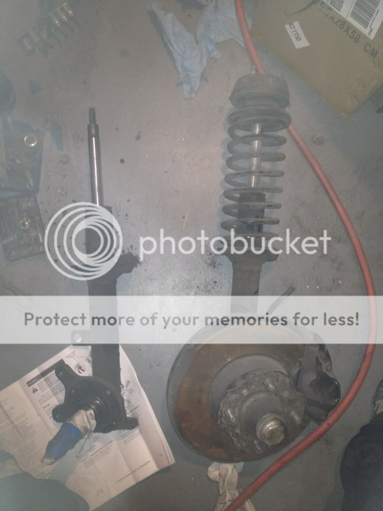

seattlejester Posted January 10, 2012 Author Share Posted January 10, 2012 Haha, should have seen that response coming, looking forward to seeing another Z . I've heard that most aftermarket truck places have a huge press that makes our spindle pin look like a joke so that's my end solution, going to try the 20 ton press I have access to if my little 12 ton doesn't do the job, still really considering not messing with it on this suspension set. Planning on purchasing another set to section and coilover, but that's in the future so maybe leave it alone till then. Well my car needs pretty much all of the weather stripping so a kit is still up there, there's one partial on craigs list that I'm considering, but it doesn't have the super expensive doors or windshield . I'm gonna make a run up to the junk yard sometime soon for a honda wiper motor and some weather stripping, I'll keep an eye out for the wiper arm assembly for ya. Progress: Finished sealing the floor and engine bay, started by using a flux brush, but ended up using a gloved finger, turned out much better than a brush, went through probably 20 pairs of gloves, only took 1 tube of seam sealer, still have 2 tubes left >.<. Seam sealed the bottom of the car and the rocker, definitely looks like the rocker was replaced at some point has specs of gold which I'm guessing is copper or brass brazing? Will probably have to be replaced eventually, let's shoot for 5 years from now . Plugged some holes, I have the rear strut bar to make, the horizontal bar for the front strut brace, and the gap lid left to weld. Engine bay just needs clear coat before I start putting stuff back. Interior hasn't been touched as I wanted to take care of any potential floor welding before, so interior is next. Exterior, putting the car back to black before squirting on the white, body filler was grey/red/yellow/white; couldn't figure out how to take off the trim pieces, so just taped them off for now. Mini projects: Found some matte clear, so thought I'd compare white paint with matte clear, versus satin paint with gloss clear, vs satin paint with matte clear on the roll bar/strut bars. Tempted to order fender mirrors and the front chin to give my car it's face it's been missing for so long. Still have a few dents in the door and fender to deal with, the fender is off of one of the models that had the chrome stripe, so the pin holes need to be welded shut. Questions: What are the holes on the bottom of the rocker used for? I can only imagine it was used to drain water or solvent when the car was made at the factory, is it safe to plug the holes up? Quote Link to comment Share on other sites More sharing options...

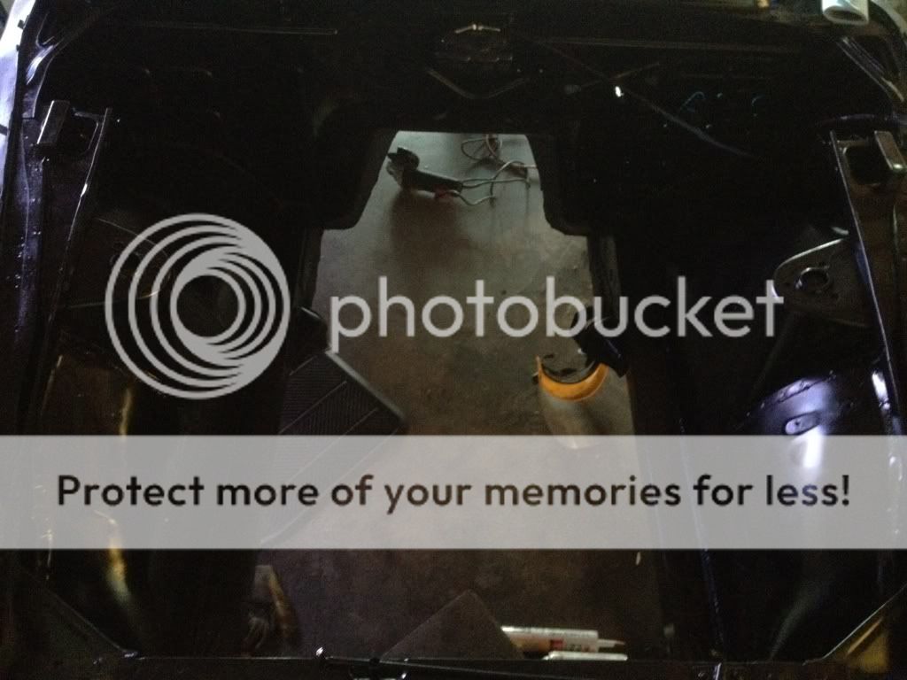

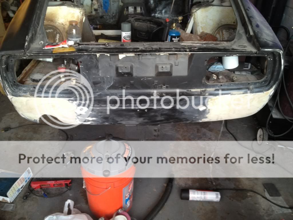

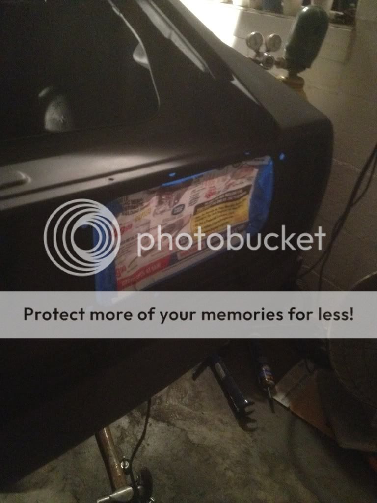

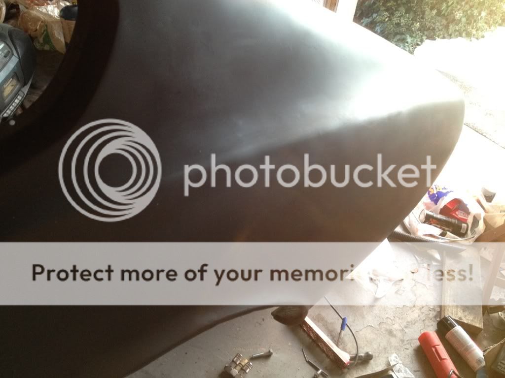

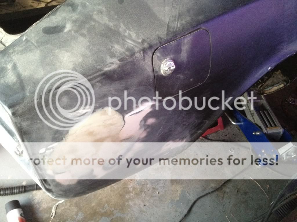

seattlejester Posted January 22, 2012 Author Share Posted January 22, 2012 Sorry just ran down and snapped a few pics so forgive the lighting/quality Rocker repair, not complete, but on its way. How the passenger side looks. And how the driver looks! Smooth and beautiful. The engine bay, just waiting some clear. The little flap. Before for reference Quote Link to comment Share on other sites More sharing options...
seattlejester Posted January 23, 2012 Author Share Posted January 23, 2012 PO story for ya'll, if you look at the license plate you can see white paint, the car's original color. The PO had sprayed primer on over a layer of dirt, so a little rubbing and off it came. Don't be a bad PO, stay in school . Quote Link to comment Share on other sites More sharing options...

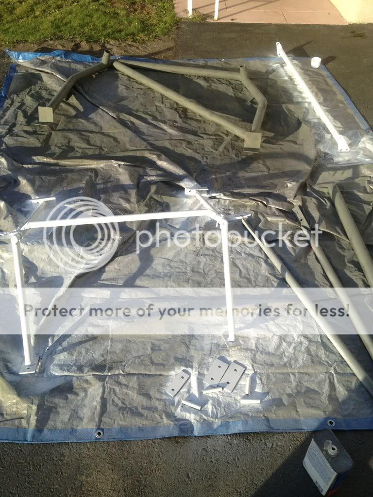

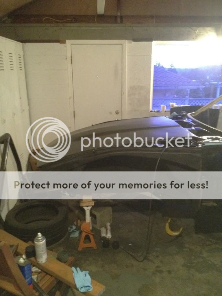

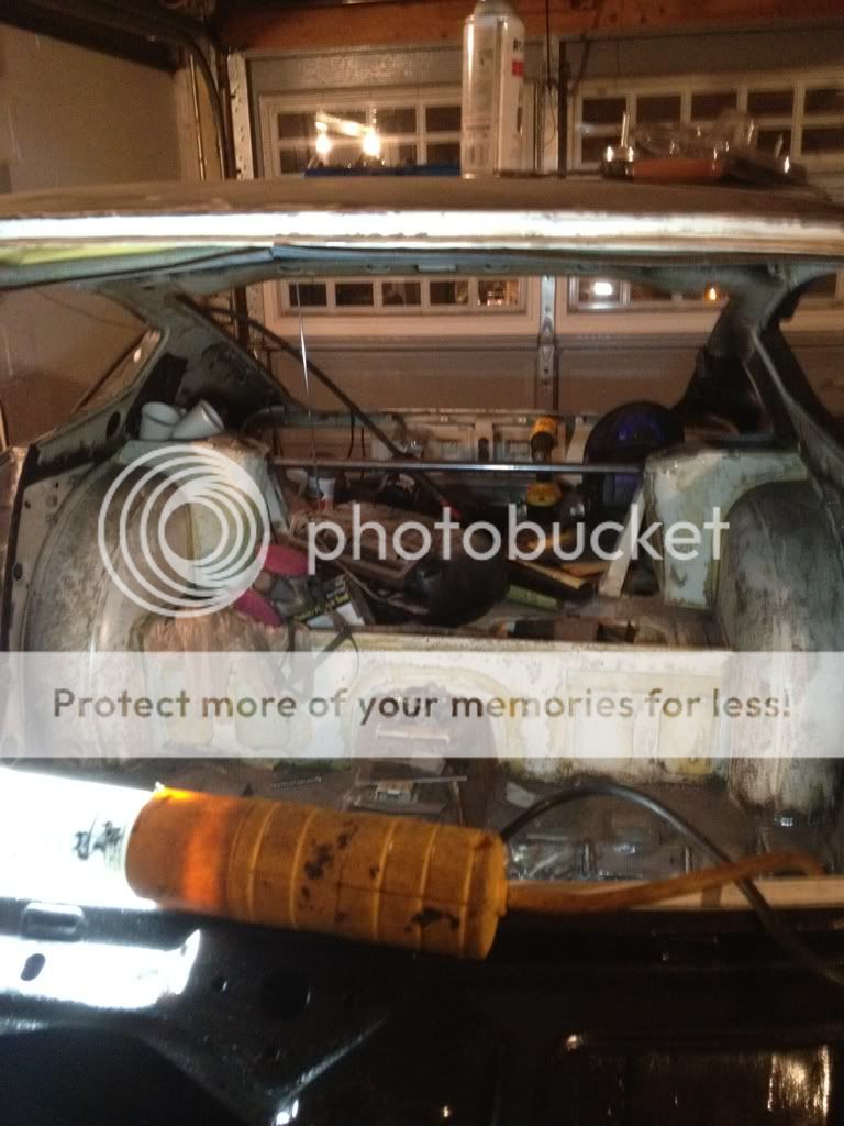

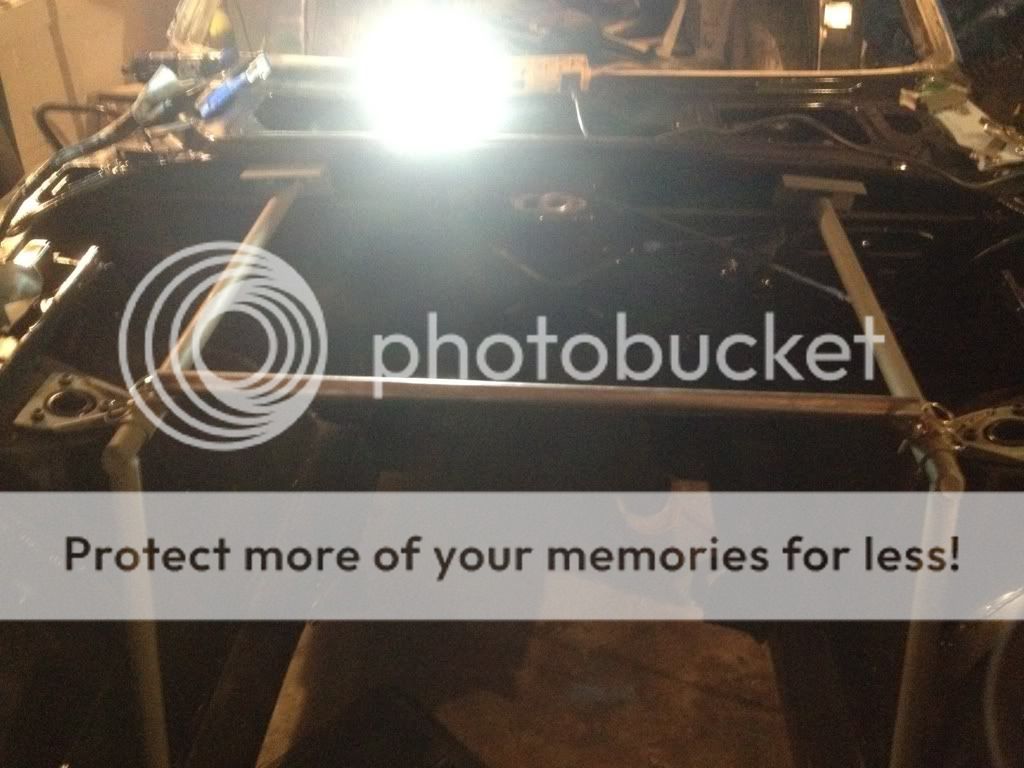

seattlejester Posted January 26, 2012 Author Share Posted January 26, 2012 (edited) Update . Probably should have waited for another hand, ended up scratching the fresh paint, but nothing a new coat won't fix. Put the hood on to check for clearance. If anyone has a Z I can check out, I need to see how the hood closes, not sure where it rubs. Then voila, hopefully everything clears, haha. Then decided to just tack in the rear strut bar, don't think it will ever need to come out. Edit: Twas a nice day, so I decided I'd paint all the bars going into my car. There was a slight cross wind, so I had to get closer to compensate, ended up running a lot more than I wanted to, I'll have to setup a paint booth inside to avoid that. Had my first run in with reactive paint, the primer reacted to something on the roll bar and bubbled off quite a bit of it, will need to sand and repaint that portion. Blah blah, more work more work. Edited January 29, 2012 by seattlejester Quote Link to comment Share on other sites More sharing options...

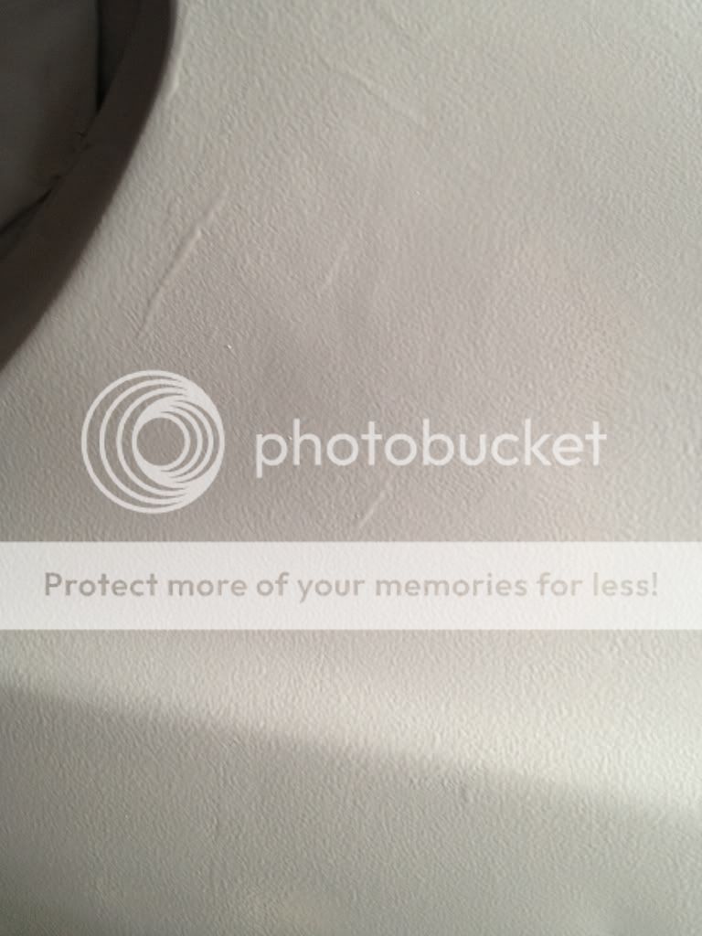

seattlejester Posted February 26, 2012 Author Share Posted February 26, 2012 (edited) TheMission: Yea, I think I'm just not cut out for paint, at least without a dedicated area with controlled air flow and dedicated equipment. Your cars always look great, now I know your secret . Basically I think there was too much acetone in my paint, so the parts I sanded down to get level, would leave an edge, letting the acetone pick up the edge. Trying to get that off, led to sanding, which left deep scratches, blah blah blah. Basically wanted one even coat to put on the car before I cleared it for the meantime. Don't ask me why this came to mind, but decided a roller would be a good idea. Figured if I could get enough paint on the car, I could sand it smooth. Left a bumpy finish that I wasn't happy with. but just stopped by and looks like gravity took it's toll and everything is flattening down. Since the car was drying I decided to work on the suspension a bit. Had a little trouble separating the hub from the brake rotor. And couldn't figure out how to get the bearings out, so called it a night. Will look up and hopefully tackle it sometime next week. 2 more weeks of school! And had a question for ya'll. The strut cartridge is held in place by a huge nut, the problem is that mine isn't hexagonal like I've seen on other cars, it's actually a circle with 4 square indents. Anyone know the proper tool to use? Edited February 26, 2012 by seattlejester Quote Link to comment Share on other sites More sharing options...
