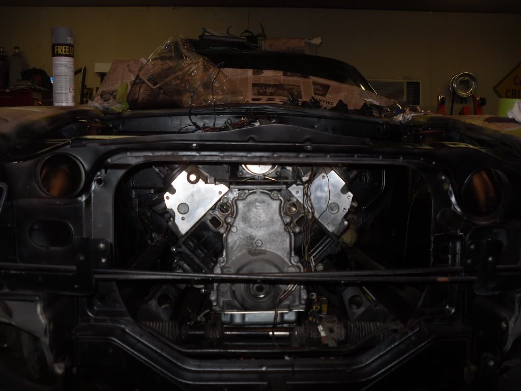

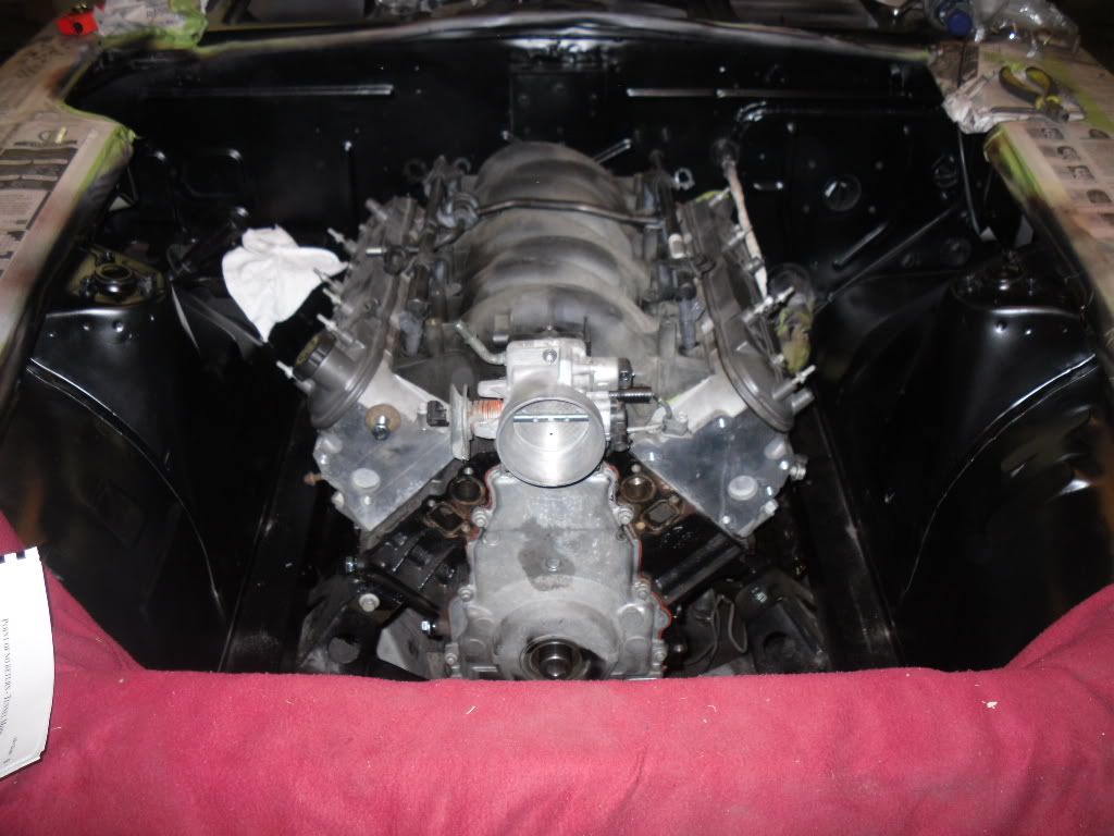

SUNNY Z Posted December 20, 2010 Author Share Posted December 20, 2010 Well I have the engine mounted, however, it's not permanent. I still have several things to torque on the internals, and some other stuff. I'm in the process of planning a transmission cross member to build, and working on the horendous cracks in the dash. A new set of Autometer gauges is on the list to be purchased in the NEAR future. Thats all I have for now! Quote Link to comment Share on other sites More sharing options...

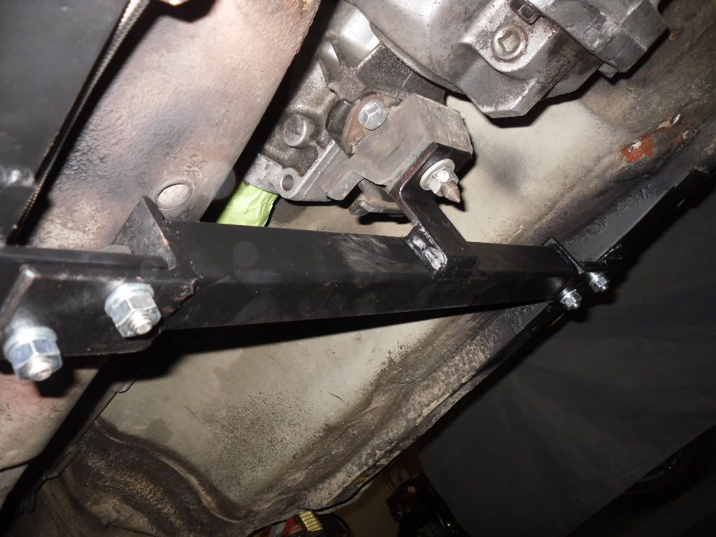

SUNNY Z Posted January 3, 2011 Author Share Posted January 3, 2011 Transmission cross member is built! I'll be removing the engine / trans today hopefully, so I can finish a few more things, and pretty it up some more. No real huge updates, with the holidays, and me being back with my parents to help around the farm, I don't have very much time to drive the 3 hours here to work on her. Quote Link to comment Share on other sites More sharing options...

SUNNY Z Posted January 20, 2011 Author Share Posted January 20, 2011 UPDATE! I have had the tranny mount built for quite a while. I'd say total time it took me about 4 hours, largely in part due to the fact that I was working by myself and also had to take the tranny out and clearance the tunnel before starting to build it. Picked up a set of ebay shorties from a friend, and this is how it looks now. (see ebay header thread for more pics) There is a large possibility that I'll be going turbo in the not so distant future. Since I don't like to buy parts twice, I thought this would be a good opportunity to make a header purchase. I have decided that I'm not gonna use the truck accessories (in the pic). I picked up an ls1 water pump, alternator and bracket, and I had the crank pulley, so I'm just impatiently awaiting their arrival. Being that there has been like 10" of snow the last couple days, I've been severely un-motivated to leave the house. I did go get my dash, and I'll probably be working on that this afternoon. Also, made the executive decision that I'll be using White Autometer gauges. Well I think.......... lol. I'm gonna order those today also, hopefully. Quote Link to comment Share on other sites More sharing options...

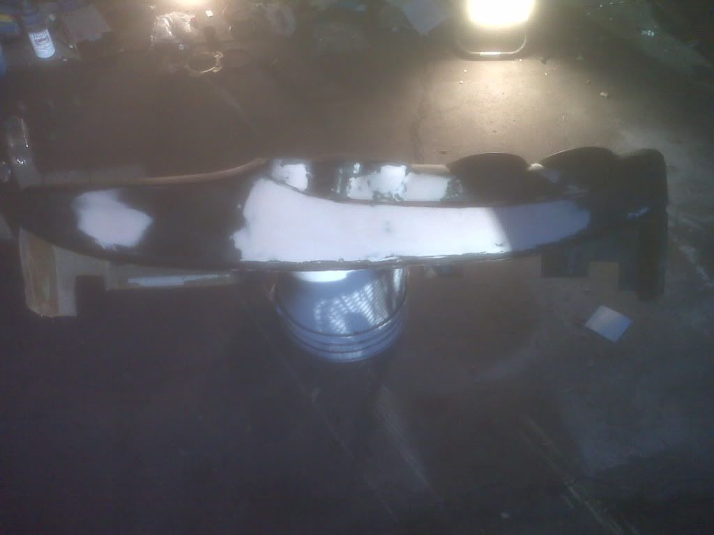

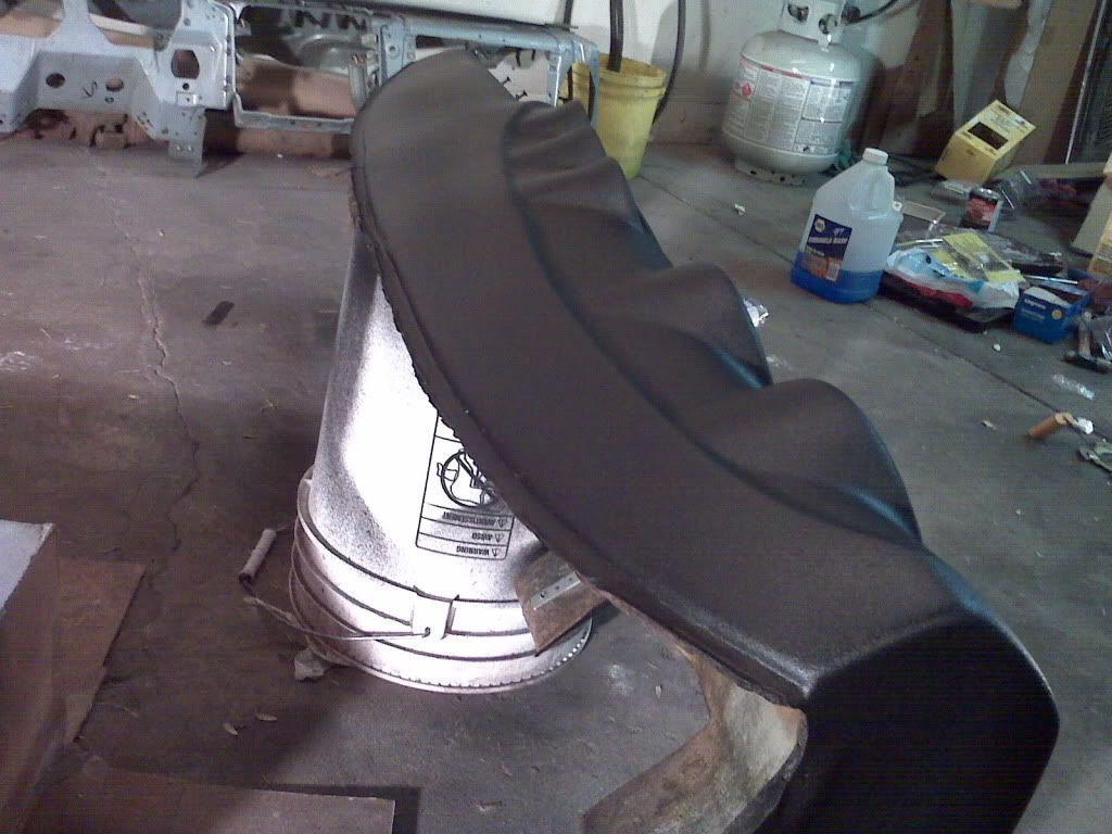

SUNNY Z Posted January 22, 2011 Author Share Posted January 22, 2011 (edited) Started work on the dash last night. It was ROUGH. Had at least 3 cracks the entire way through, all the way from the windshield to the gauge cups. Here it is after filling the cracks with Great Stuff foam, and trimming them, then prepping and smearing on some 2 part epoxy. Its a work in progress. Edited January 22, 2011 by SUNNY Z Quote Link to comment Share on other sites More sharing options...

SUNNY Z Posted January 24, 2011 Author Share Posted January 24, 2011 (edited) That dash repair is so cool, beats the hell out of a cover, cheaper, too! Thanks! Spending a bit more time on the dash today. Here is the progress. 1st coat sanded After the 2nd coat of epoxy Second coat sanded Third coat Backside Finished the 3rd and final coat. It's sanded and ready for the plasti-dip. Stores were closed by the time I thought to go get some, so its gonna have to wait till tomorrow! Edited January 24, 2011 by SUNNY Z Quote Link to comment Share on other sites More sharing options...

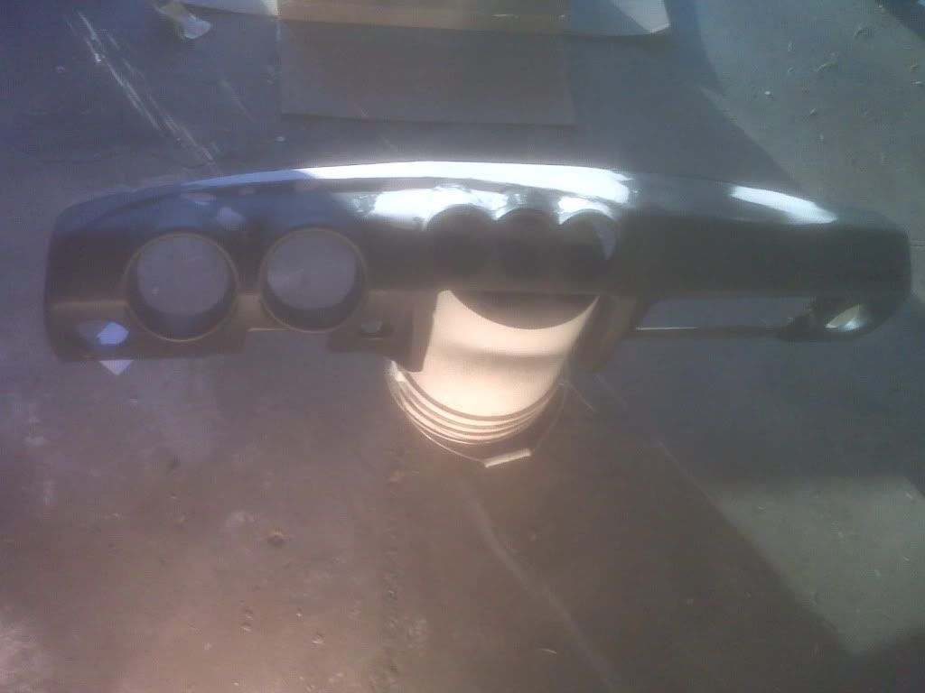

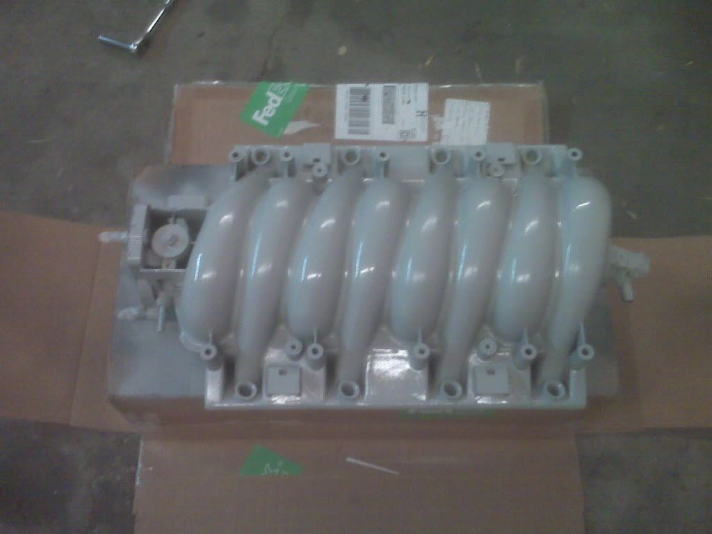

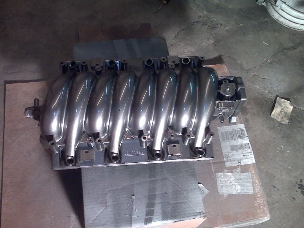

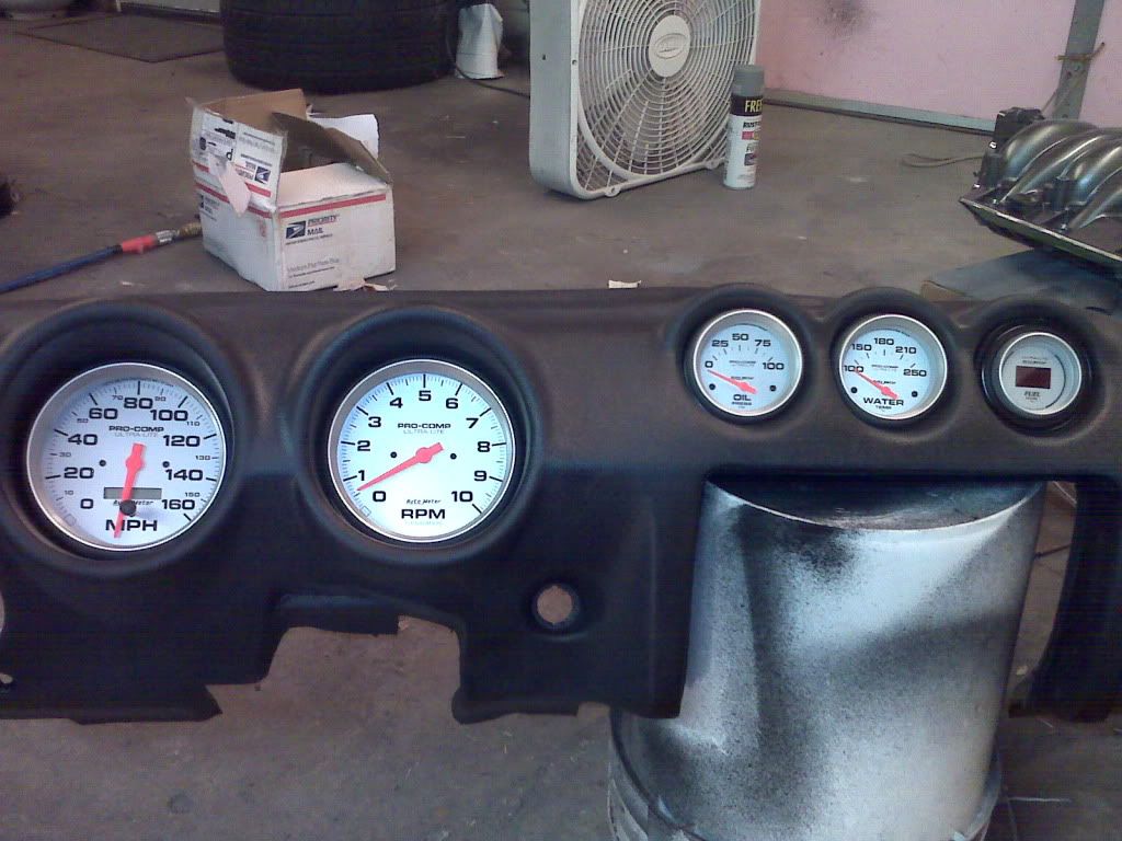

SUNNY Z Posted February 14, 2011 Author Share Posted February 14, 2011 Well i still have yet to find my camera. So I used the ol blackberry. The camera was kinda dirty in the first couple pics, so please excuse that. Here's the dash after I topcoated the problem areas with some good ol bondo. and again Then after two coats of Duplicolor Bedliner (400 scuff between coats) As you can imagine, I was VERY happy with the results. Labor intensive as it was, it was definitely worth it. note: not for those who don't like sanding, and don't have patience I then took it upon myself to mock up the Autometer Pro Comp Ultra Lites I also got bored with my LS1 intake. It was kinda dingy, and I wanted it to look fresh. SO, I sanded off the casting marks with 80 grit, then 220. 3 coats primer, wet sanded with 400 in between, 2 coats base (gunmetal metallic), wet sanded 400 in between, and here it is after 1 coat of clear. (gonna do at least 2 more) Quote Link to comment Share on other sites More sharing options...
1 tuff z Posted February 14, 2011 Share Posted February 14, 2011 both dash and intake look awesome! how much do you think you have in the dash? i'm thinking about the same with the project z dash... Quote Link to comment Share on other sites More sharing options...
SUNNY Z Posted February 14, 2011 Author Share Posted February 14, 2011 both dash and intake look awesome! how much do you think you have in the dash? i'm thinking about the same with the project z dash... Thanks! Evercoat Maxim Urethane adhesive ~$40 Wax and grease remover ~15 Sandpaper~ 10 Duplicolor Bed Coating - 2 @ $10 each = ~20 Bondo - ~ 10 Misc supplies ~ 5 I'd say a Benjamin would get you there. I don't wanna know how many hours of sanding, etc. I have though. My guess is 12-15? I'm a bit of a perfectionist though. Quote Link to comment Share on other sites More sharing options...

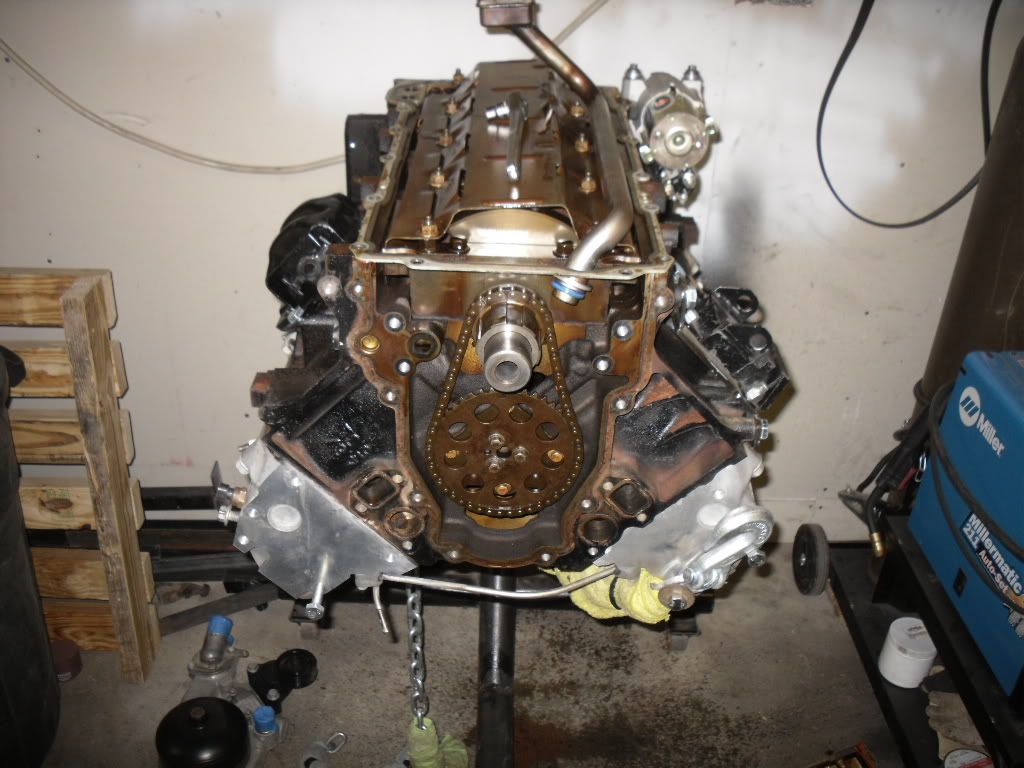

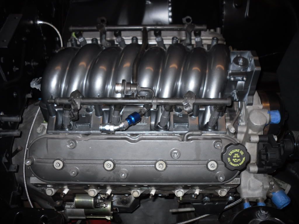

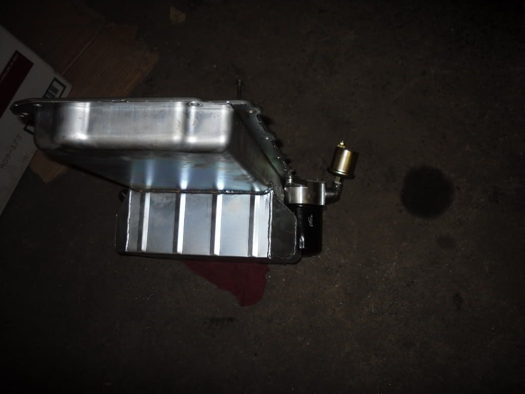

SUNNY Z Posted February 28, 2011 Author Share Posted February 28, 2011 Alright, Update time! Had a pretty good weekend. Here's a pic of my fuel rail mods, with fittings to meet my needs. Don't mind the valve covers, they're off for paint right now. Fuel line is still waiting to be fit for a couple reasons I then had a couple buddies over, and within about 20 minutes, we had the engine and tranny back out, and the engine on a stand. I was torquing the cam gear and the rest of the valvetrain, along with some other stuff. While it was apart, I took the liberty of taking the oil pump off for some cleaning, and to shim it. Here is the exploded view Pic of the bulky autometer oil pressure sender installed THIS LITTLE BASTARD. It was one of the manifold bolts that was snapped off when I got the engine. I drilled it out, (broke a drill bit doing it) then, luckily had another bit the same size, and went ahead and heated the head, and finally got it broken loose. Here's a shot of the final install of the gauges. Turned out nice if I do say so myself. and the backside.... Here's the valvecovers as of now Front cover cleaned and ready for paint Aaaaaand I trimmed the tunnel a touch to clear the shifter Thats all for today! Hopefully gonna be making a couple key purchases this week, and start wrapping this thing up! Quote Link to comment Share on other sites More sharing options...
