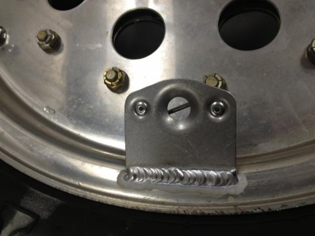

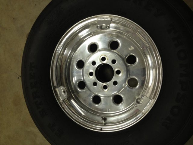

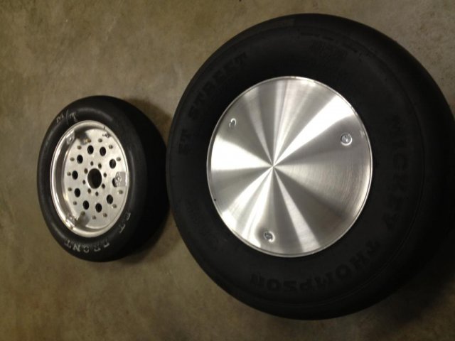

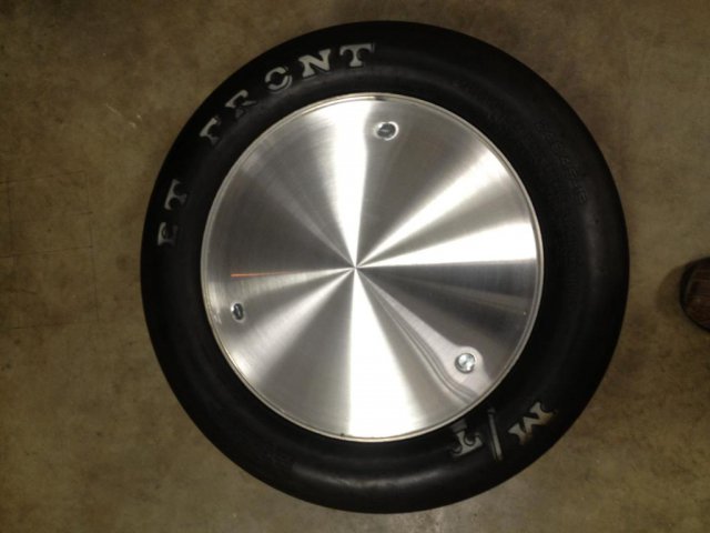

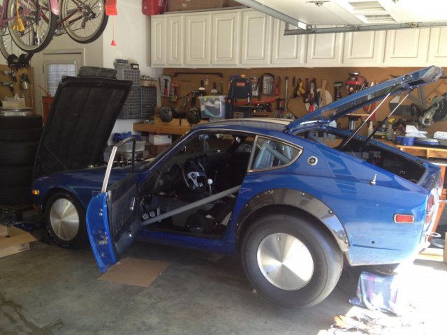

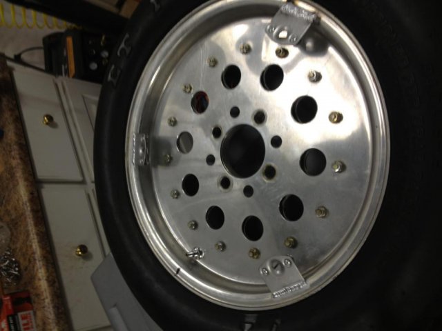

RebekahsZ Posted February 5, 2015 Author Share Posted February 5, 2015 Car is still at fabricators to have fatigued sheet metal at the lower hinge repaired. His mom just died so it may be a while. The garage is coming along with doors hung and interior painted. It is bricked about 1/3 of the way up. Next is to get the gas in and install the heater, house fan, lights, etc. Worked on my landspeed wheels and tires today. Almost got that knocked out but one of the front 2-piece wheels leaks and needs to be re-siliconed. Hope to finish that before the weekend is over. Quote Link to comment Share on other sites More sharing options...
texis30O Posted February 5, 2015 Share Posted February 5, 2015 You better make sure those are balanced with the covers on....... check out monoprice for some audio and automation to be thrown into the garage. ( I just did a whole home system for the house 6 zones) They have some good on the cheap stuff. I am interested to see how you turn out on the landspeed stuff. I have to go out and buy my splitter materials. I have one figured out I just have to buy the stuff...... Quote Link to comment Share on other sites More sharing options...
RebekahsZ Posted February 5, 2015 Author Share Posted February 5, 2015 Ah, I'm gonna trust them to be fine. I don't intend to try to keep up with which wheel goes on which side or which disc goes on which wheel. That just exceeds my level of interest. I'll let you know if I have one wheel hopping down the track! Quote Link to comment Share on other sites More sharing options...

RebekahsZ Posted February 20, 2015 Author Share Posted February 20, 2015 (edited) Got new slave cyl put in the truck. All went well until part way home and 5 th gear starts whining more than I recall. Smoked the tires a few times cause it does it so well. Then, 3rd gear starts popping into neutral if any significant torque is applied via go pedal. So I've gone from a bad slave to a bad trans. I can't get a break. Maybe if I could keep my foot out of it. I gotta start on the Z NOW. Can't let truck delay me any longer. Plan is to limp it as long as I can and get the Z up on jacks and start getting it ready for ECTA May 3. Crunch time. Edited February 20, 2015 by RebekahsZ Quote Link to comment Share on other sites More sharing options...

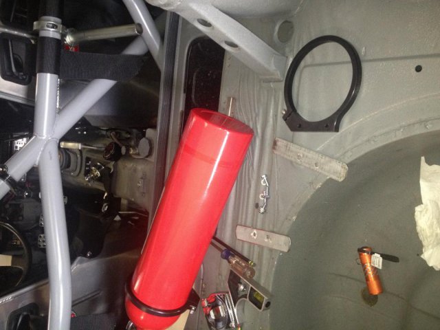

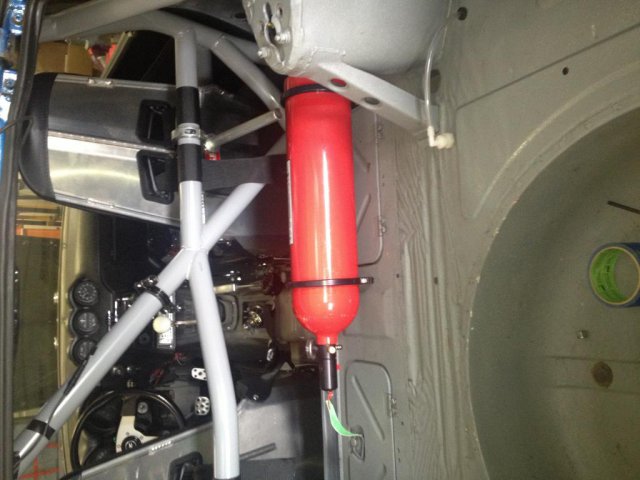

RebekahsZ Posted March 8, 2015 Author Share Posted March 8, 2015 (edited) Ok, truck is back together, no longer leaking trans oil and full of oil again, it looks like the trans is fine. I even fixed the heater, so I'm golden for the moment on the truck. So attention goes to the Z for a last minute thrash to get my winter list done before May 1. Doesn't help that I have a wicked cold. Put Z up in the air and dropped the gas tank. Installed new metal battery box with 3/8" bolts passing thru the "frame" per NHRA rule book. Box still needs vent hose located and cables redone. Found location for 10# fire suppression bottle (damn it is big! And heavy!). Gonna go borrow a buddy's NO2 bottle tomorrow to see if I can leave room for that future mod. Planned out location of master power switch and fire exstinguisher handle. Need to make a bracket to locate them both. Hoping to finish fire system and electrical mods before April 1 in order to leave all of April for doing the bell housing swap. Got on the scale, and since Nov1 Ive lost 10#. 20 more to go. Still wont make up for that fire system! Edited March 9, 2015 by RebekahsZ Quote Link to comment Share on other sites More sharing options...
RebekahsZ Posted March 15, 2015 Author Share Posted March 15, 2015 (edited) The Firefox 10# bottle is mounted with the brackets that came with it plus some backing plates that I cut and drilled from some flat stock so that the bolts are less likely to rip thru the flat sheet metal should I ever have a nasty upside-down off-track excursion. Due to the stock gas tank and spare tire well, the package tray was the only viable location for mounting it, since the big flat area on the right is reserved for the battery box. In the photo you can see the vent tube for the "sealed" battery box that is to come next. I have made big backing plates for the battery box mounting bolts since the same issue applies here with the battery being secured only to the flat sheet metal floor. I did manage to position the battery box such that one of the bolts passes thru a "frame rail," which on reality is only a box section of sheet metal in the unibody. Sorry, it looks like the photos are sideways coming off my cell phone. Made bracket for fire suppression handle and master power shutoff. This bracket will go between my seat and the trans tunnel river nutter to the tunnel. Edited March 16, 2015 by RebekahsZ Quote Link to comment Share on other sites More sharing options...

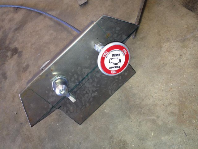

RebekahsZ Posted March 30, 2015 Author Share Posted March 30, 2015 Battery box in. Driver's emergency panel in with cable and switch mounted. Hoping to get cables made up on Thursday. Hoping to be done with the shiny side a week from today. Sorry photos are sideways. Quote Link to comment Share on other sites More sharing options...
