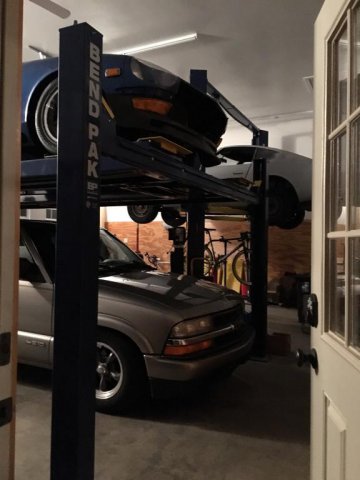

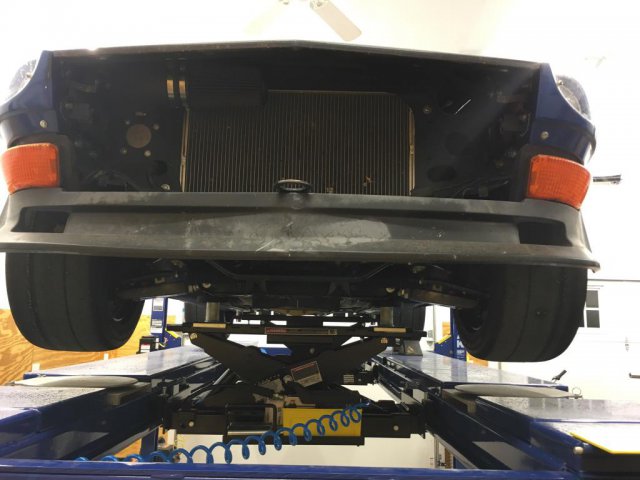

I have the front crossmember slotted and most of the parts here to put the front end together.  Just a matter of making time.  Have ordered a couple of lifts for the new garage-one of which is an alignment lift.  Hoping to use that when the front suspension is put back together.  Don't know how long the lag will be between ordering the lifts and having them installed and ready.  Have bothered Rockland Standard Gear a bunch trying to learn about their custom-ratio T56 Magnum-they dont have a good way to make 6th gear a .75-ish ratio, so it looks like I'm staying with my current transmission.  I'm gonna be going with a 3.18 rearend ratio to take the car to 200mph.  Between that diff ratio and an S1 sequential shifter, dollar per dollar, it will be a break-even with getting a T56 Magnum, and perhaps less work, I was just really hoping to come up with a clutchless transmission.  I'm pretty sure all those Liberty, G-force and Jerico trannies use external shifter linkage, and I'd really like to stay with a top-loader style for simplicity/reliability.  I may be the first guy to buy one of the S1 Sequentials (really just a vertical gate shifter), but I don't want to bother them until I have the funds to commit.  I may still waste some time talking to Liberty about face-plating for my spare tranny.
Edit:  looks like a 3 week lag time on the order due to the size of the package (the lift, not mine).  Time to go review my aircompressor advice thread and start working on that.  Then all the big items are done.

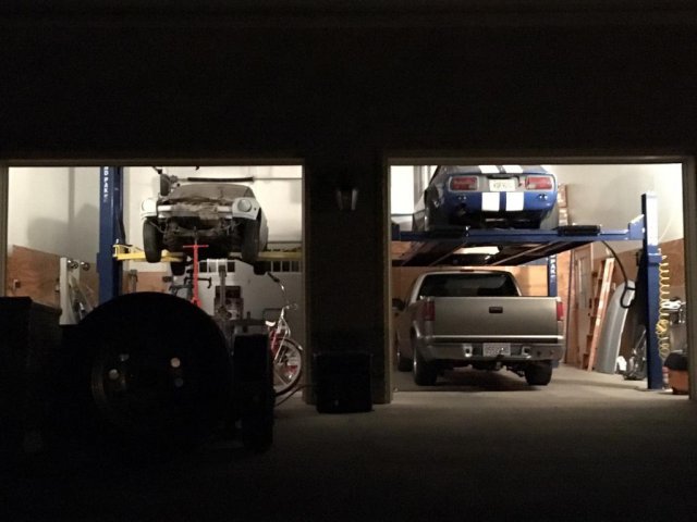

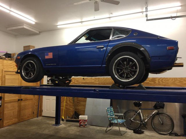

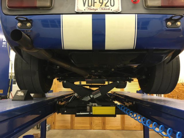

Car off stands and reassembled. Aligned on new lift. Ran autocross Saturday. Car did fine. Driver was average at best. Always lots of fun. Used lift to help fix a buddy's Mountaineer after church. Z is up on lift to pull gas tank for mods anticipating need for second fuel pump and to allow fabricator to instal parachute mount/trailer hitch. Gonna call him today to see what his backlog looks like. need to get chute on hand and rear spoiler installed prior to sending it off to him. Next milestone is Ohio Mile or GA 1/2-mile in Sep.

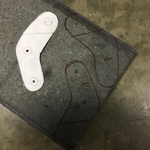

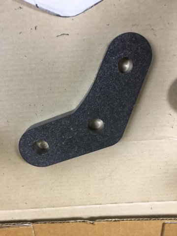

Working on high speed stability as I prepare for the Ohio Mile. Drilled the rear hatch to be able to make a pass with no rear spoiler, then to quickly mount a small BRE-style spoiler for a pass, then to go on up to a larger rear spoiler. The BRE spoiler has 6 studs already bonded into it. The Larger spoiler came with 2 rivet nuts in it from the supplier. I drilled it and epoxied (10) 1/4" aluminum rivet nuts into it. This is the first mod I've made to try to get the car to go straight better. Next is to drop the fuel tank and to get it to my chassis guy to have the chute mount built. Pics to follow.
Edited by RebekahsZ
The wing itself is very rigid and well made, except that it is too close on the drivers fender. But mounting composites is always an issue. The rivet nuts insert into very thin carbon fiber (and) the deck itself is very flimsy in this area. And the doubler panel makes it hard to install hardware from the backside. I guess if it was easy, all the kids would be doing it. MiKelly installed the same or similar wing on his car with just the two bolts and silicone adhesive. Mine doesn't match the contour well enough to use adhesive, plus, I wanna be able to try different spoilers easily. 1 tuff z, I think this spoiler is similar to yours. With varying wind speed and direction it will be hard to provide perfect feedback, but I will do my best.
Edited by RebekahsZ
Keith, I have the same spoiler, in fiberglass.  Mine had to be clearanced on both sides to avoid quarter panel contact.  Instead of sealer I used a dense foam tape [like what is used to seal a truck cap to the bed] along the front and back edge, leaving a gap for the water to drain at the low point where the lock is.  I then purchased some large diameter washers as my backing plates.  A bit challenging to hold the washer in place and get the nut started but got it done.  I've noticed greater straight line stability at Watkins Glen but I only see a bit over 145 there, not the speeds that you'll experience.
