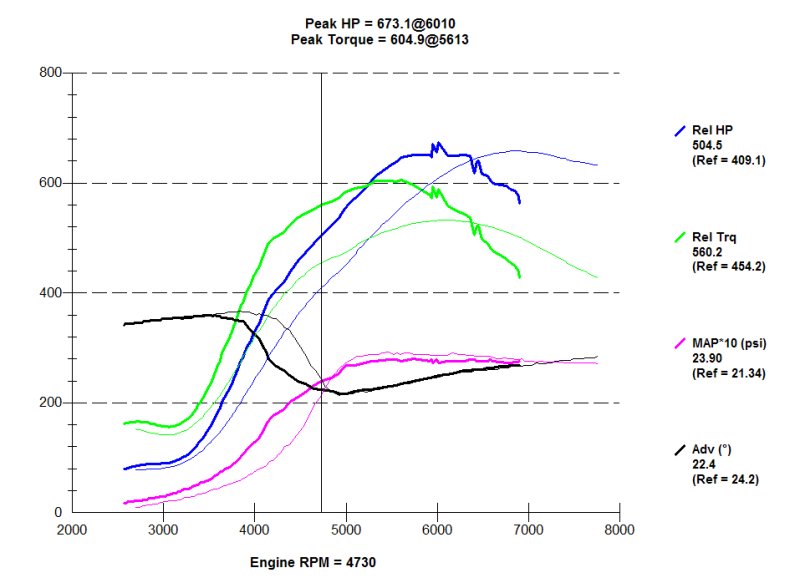

I've found this practice to work well - as others have said retard the timing as boost comes up, but then you can add a degree or two per 1k rpm from the torque peak to redline. Start with something conservative ans see how it works for you.
Here's pretty much what mine looks like - ignore the hp and torque numbers, this was taken from a third gear on-road pull, and is not an "official" dyno number...
