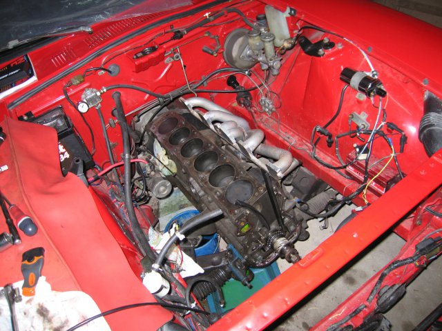

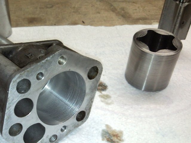

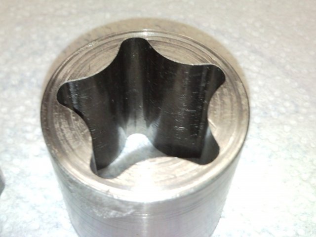

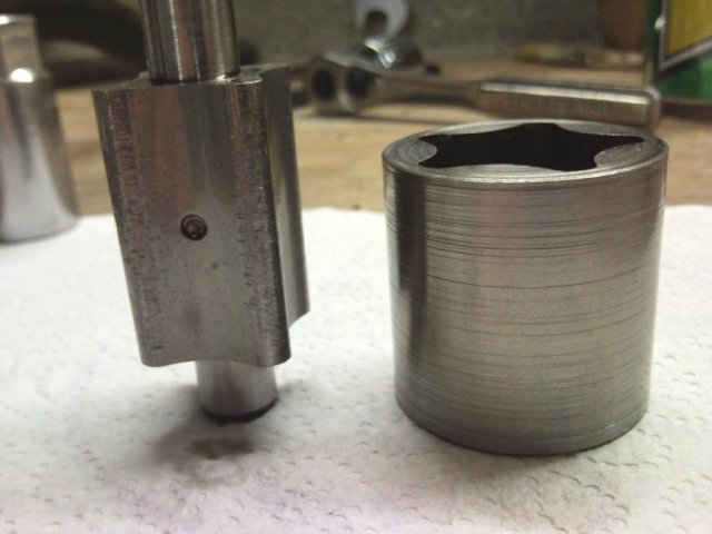

Lazeum Posted October 31, 2010 Share Posted October 31, 2010 (edited)  I'm currently in process on rebuilding my engine since a lube issue damaged it. It was still running but since something was odd, I've decided to take apart the engine and inspect every oil passages to make sure everything will ok after the fix. Cam & retainers were damaged, some metal flakes ended up in the oil. I've taken apart the oil pump, it does not look so great but I'd like to know thoughts from experts There are some major scratches on the edge of the inner shaft, rotor is quite rough as well. I'm quite concerned to put it back on the engine, I don't want t have some lube issue in the future (who wants???) Head/Cam is having the internal oiled cam + spray bar. I expect to enlarge the oil restrictor by 3mm. So I'm thinking a large flow turbo oil pump might be part of my plans for the future... What do you guys think? Edited October 31, 2010 by Lazeum Quote Link to comment Share on other sites More sharing options...
josh817 Posted October 31, 2010 Share Posted October 31, 2010 Usually the housing itself (in the first picture) you can sand down back to clearance but the rotor and cylinder is all gouged. Oil pumps are cheap, I think its best to just get a new one instead of trying to salvage. Get the turbo pump. I haven't checked but the prices for a regular and then a turbo oil pump should be roughly the same I think... You can always prime the system and check for pressure by getting an extra oil pump spindle/drive, gut the gear off the rides along the crank. Put a drill on the end of it, through the distributor hole and spin it up. Or if you don't want to maim a spindle, get a rod and cut the one end to fit the key in the oil pump, then do the drill thing. It will be messy when you drop the pump to put the proper spindle in, but at least you find out if you have pressure and prime the system. Quote Link to comment Share on other sites More sharing options...

didier Posted November 5, 2010 Share Posted November 5, 2010 Hi, Mathieu looking at your pics, i think your pump is absolutely dead . If you want one, i'll give you mine, in good shape, i'm in a project of dry sump pump system . regards Didier Quote Link to comment Share on other sites More sharing options...
