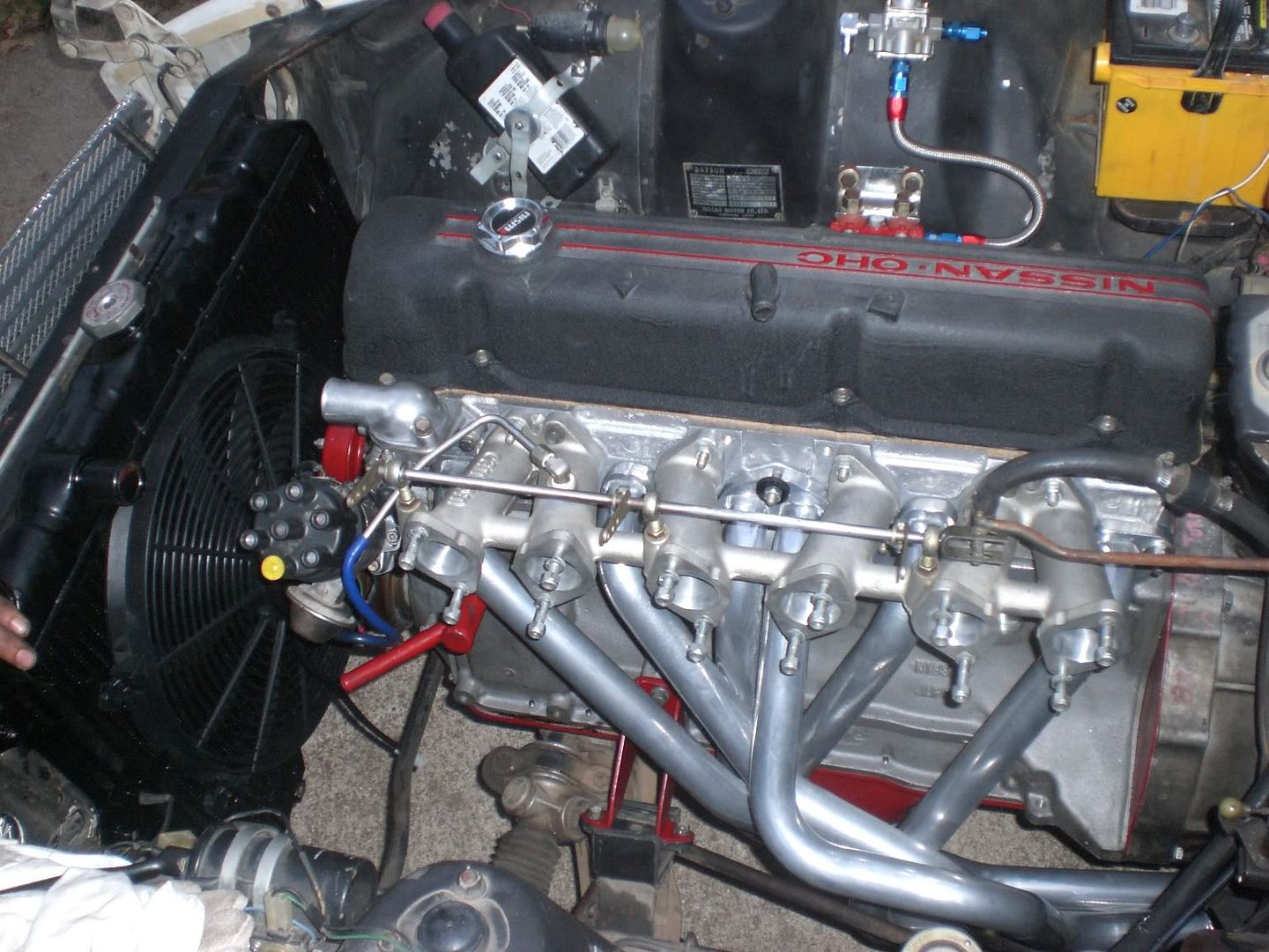

zigzag240 Posted November 4, 2010 Share Posted November 4, 2010 My winter project this year is to install a set of new 40 DCOEs on my L28 240. Rather than buy the whole assembly prebuilt, I decided to buy the carbs seperately as well as the manifold and linkage. The manifold I have is made by TWM but its design doesn't take into account the starter circuit and lever on the rear of the DCOE for some reason...the linkage standoff gets in the way. A workaround is to remove the starter circuit cover and lever and put a block off plate on it since I don't plan on using the starter circuit anyway. But after years of Z mods I'm pretty much a Weber newbie....my questions: - When I remove the starter lever is a matter of simply blocking off the opening with a plate? Do I need to remove any jets or block anything else off internally? - Does Weber make a block off plate or should I get out my dremel tool and a piece of sheet aluminum and fabricate one? See the photos below: http://datsunzgarage.com/index2.htm Bryan Little New Haven, Connecticut Quote Link to comment Share on other sites More sharing options...

zigzag240 Posted November 4, 2010 Author Share Posted November 4, 2010 (edited) Appreciate all the tips. Thinking I had would rather have a version with balance tube, I just called Top End Performance who I bought the carbs from. The guy who answered went out and checked one of their Cannons and said the brace wasn't a balance tube and could see no openings in the runners...oh well. So I just doubled up the anti-vibration spacers on each carb throat so there were two on each...perfect clearance. No need for a block off plate now. Thanks guys..you put me on the right track. This is gonna work...heh-heh. Scroll to the bottom for the photo of the fix: http://datsunzgarage.com/index2.htm -Bryan Edited November 5, 2010 by zigzag240 Quote Link to comment Share on other sites More sharing options...
