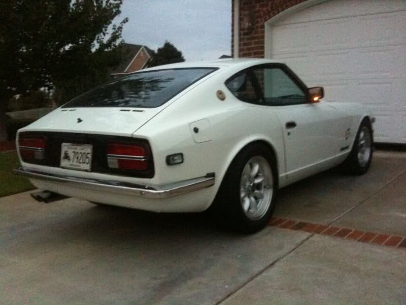

Marshall Dillon Posted November 19, 2010 Share Posted November 19, 2010 Hello everyone, I am a relatively new owner of a very clean 1972 240Z. It's got a mildly worked over 280 engine, I'm guessing 200hp. It's fun, it handles well, but man, it needs another 100hp, plus. That said, I have nowhere near the time to do this kind of job myself, and would love any recommendation of shops/mechanics that you guys have used or heard of that are familiar with this whole process. Ideally, I simply like to save up the bucks needed, ship the car and parts requested to the shop and be done with it. Thanks for all of your help! Quote Link to comment Share on other sites More sharing options...

EvilC Posted November 19, 2010 Share Posted November 19, 2010 Also do you have any pics of your car? Would you buy a car already done? Quote Link to comment Share on other sites More sharing options...
