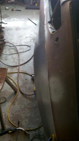

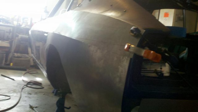

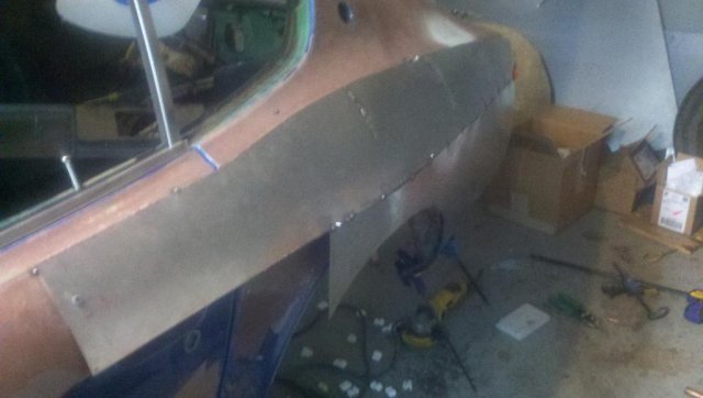

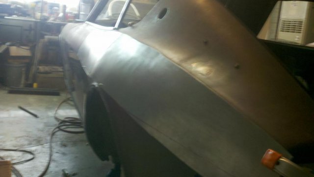

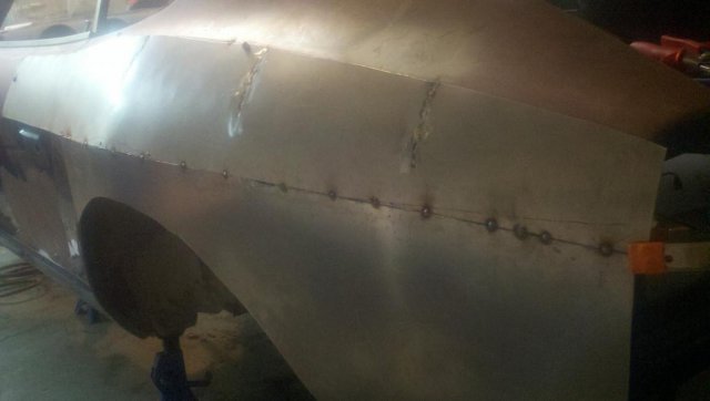

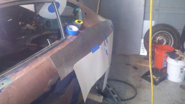

Naptown Dave Posted May 4, 2013 Share Posted May 4, 2013 I have started an all metal wide body rear mod. Fiberglass would probably be easier but I've been involved in the welding industry for more than 20 years so 'glass wasn't really an option. I like the Subtle Z look and really want to put some fat rubber to connect my LS1 to the ground but I don't really like the abrupt bump out at the back of the door. I started the transition about 6" in front of the door handle (shaved door handles are also on the menu). I am looking at adding 2" per side and transitioning back to the factory rear end. Quote Link to comment Share on other sites More sharing options...
