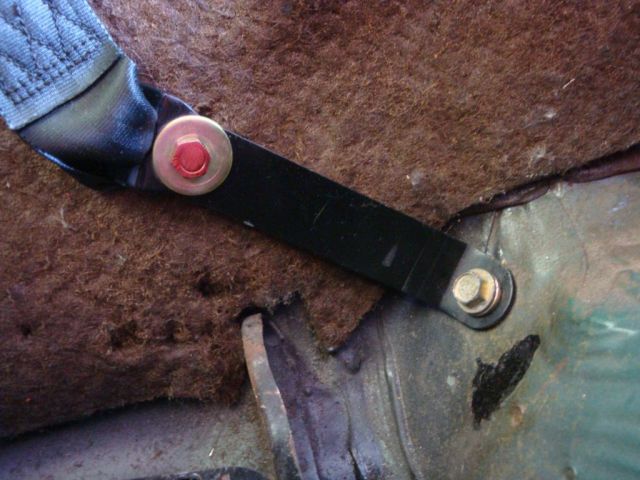

So after searching around for replacement seatbelts, I kept finding the same type of universal fit belts and they didnt make me too happy. My objective was to have functioning retracting seat belts from a newer NISSAN that looked like factory. I remembered I had a set of 1991 240sx fastback rear seat belts in my storage and what do you know, they looked to be the shape I was looking for.
For the last few days I have been messing around with them and got them to fit rather well with only a few modifications.
First i opened up the mounting hole for the retractor a few MM and drilled out a small spacer to lift the retractor off the roof mounting point...Then I cut off a small metal "finger" pointing up off the top of the retractor(assume this fits into the S13 chassis somewhere but was in the way of mounting) trimmed up the plastic cover and BAM worked great, and looks even better. Longer mounting bolts helped with mounting the retractors. Then I bolted the other side of the seat belt to the bottom side seat belt mounting bolt.
The only thing im not totally happy with is the buckle....since it was in the backseat they are a little short, BUT i found a place online selling seat belt extensions for about $20 a pair, so thatll bring it up to where I can easily reach it.
One note about this swap, the belts work great and lock like they are supposed to, but due to the fact they are for rear seats in a 240sx, the length on the belts isnt the longest, I can reach to the glove box fine, but theres only a foot or so of play in the belt. Im a big guy, 6'3'' 240lbs and these work GREAT for me.

Yep, thats another thing I was considering that I totally forgot about....the back seat in the 240sx is so @&*$ small that the belts are rarely used....but they are usually beaten on by the sun (faded belts and dry/bridle plastic)
So if you want to get them, they come in 1989-1993 Nissan 240sx FASTBACKS. Doubt the coupes will work as easy as these...
The retractor does not swivel or move, it is solidly mounted. The small spacer was needed to clear the car/window edge.
One more note too....I swapped the retractor sides (passenger on driver side and driver on pass side since the brackets seem to kick out that way, making installation easier)
Couple more pics
Bottom mount for the belt
Short buckle (without extension)
Showing where the small "finger" tab was that got cut off.

On another note, I found out the 12" seat belt extensions I used in fact actually DID put the buckle too far up and messed up the geometry of the belts. So after searching google for 6" extensions, I found out the Jeep CJ7 uses belt extensions that are steel "L" brackets and whats even better is they are only $5.95 each. So i ordered a pair of those and will go ahead and remove the 12" extensions from the buckle portion and maybe move them to the lower mount that bolts to the car to get a little more belt slack since the retractor maxes out if i try to reach to the passenger window crank.

New update, The metal extension brackets I was using did not give the belts proper geometry and after talking to a few of my Z friends, decided to find a replacement for the OEM belt buckle that was a little short. After pondering what could also share similar belts from a similar era, I found a couple buckles on ebay that looked promising. The buckles I found that work are from the REAR of an early Q45...not sure EXACTLY the year, but I believe it to be pre 1994. They are actually the correct length and bolt in to the factory position. I have included some pics that show my old setup with the OEM rear 240sx buckles with metal extension VS the Q45 (Tan) buckle thats longer from factory.

Finally got around to installing our 240sx belts with a couple of mods. Also thankful Nelsonian had been kind to sell us his [after they would not work in his z] for our z at a nice price!
  • removed the stock cover from the retractors [may install later...]
  • enlarged the retractor mount holes to allow a shoulder bolt
  • made extenders for the receiver belt
They work fantastically and I believe are safer than the oem 71 belts this z came with. Very happy with the install thus far. Pics
