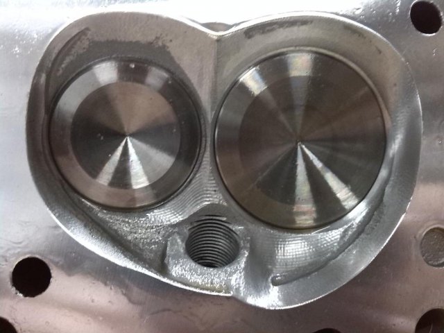

Don't be confused. This engine belongs in my silver coupe, its the one that was going to be turbo'ed and had the P90 head on the N42 block with VG30DETT JE's, a 2850cc engine.
Because I track this car, putting a turbo on was going to move me into a different class, so I decided to replace the P90 with a late model E88 off an L24E engine (R30 Skyline). I had my tuning shop "develop" the head to this point, swirl polished stainless L28 valves and a full CNC port and chamber re-work.
The cam is a Wade 640A grind, 298 deg. Adv. duration, 595 lift at the valve. Timing events are Intake  44/74 and Exhaust 82/36
And the megasquirt is working very well, supporting this sort of performance.
Cheers Mate!  :icon6:
