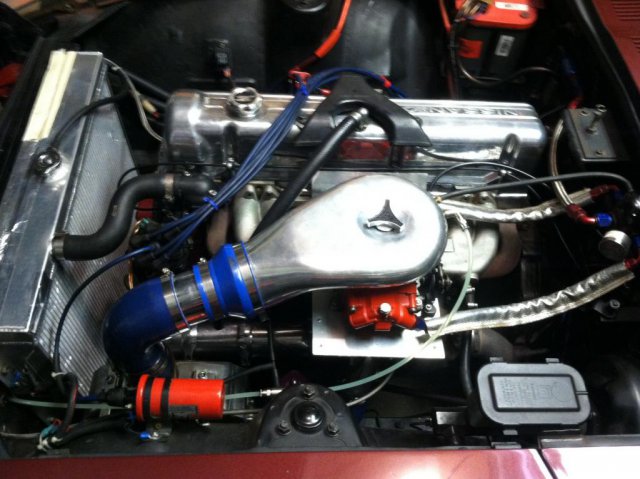

You bet it does!!! Great to see someone else moving in this direction. :icon7:
Tell me about your throttle body, injectors, intercooling, management, turbo, compression, cam, head and bottom end configuration, Oh heck, tell me EVERYTHING...please!
Looks awesome mate. :icon12:
Cheers.
Ps. Xnke was very patient with me and I have the car running well based on his advice. There is certainly more work to do with megasquirt, getting it to run factory smooth but I just ran a round trip to Phillip Is. from Sydney (2500 kms) which included some track time and I was very happy with it.
Heat shielding is very important, my fuel was getting hot and the tune was changing on longer drives. It's better now.

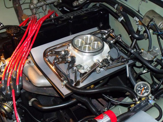

Finally got mine running.
I had to ditch the turbo for now since I recently became un-employed and decided to just finish it with what I have.
I have running it now for about a month now and I am really pleased so far. It runs excellent. Driveability is exceptional and no more falling on it's face after about 5000 rpms, it just keeps pulling all the way to redline.
There was some concern about running such a large throttle body (1000cfm) on a single plane intake and how it would effect low speed / off idle. There is no problem, it is really responsive.
For ignition I ended up just using my 77 280Z distributor. I locked out the mechanical and vacuum advance and wired it up to an 8 pin HEI module. Works perfect with the Holley setup.
Once I get some income going again I will be turboing this sucker for sure :)

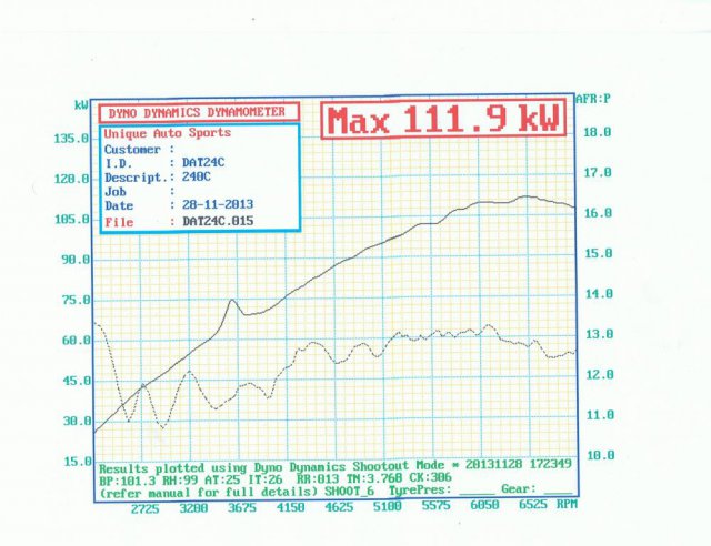

I recently did some work on the dyno and netted 111 rwkw with a mapping and a tweak to the cam timing.
The operator of the dyno suggested a few things to try, my setup needs better injectors, the Seimens don't atomise finely enough, the mapping needs to be done with an N-Alpha (tps) and the phenolic insulator needs to be ditched. A heated throttle body would dramatically help with fuel mixing with the air in the vicinity of the TB. My injectors are outboard of the throttle, so atomisation here is VERY important. He also removed the vacuum line to my Malpassi regulator because of the erratic mapping on the VE map it was causing. Tuning the fuel curve seemed much easier after this little mod.
Very happy with it overall, works really well on the track
One of my other concerns about this setup was the size of the injectors in the Terminator TBI, they are 85lbs injectors. I did some research and the new injectors they use have very fine resolution (I guess that is what you call it) and I have had no problems tuning it down to a 500 RPM idle.
I did use the manifold heater built into the Clifford intake. One of things that I think are helping with this setup is the throttle body uses what Holley calls an (annular discharge ring) to help with atomization.

I ended up buying the Terminator system as it included the throttle body, harness, all sensors a handheld programmer etc. It's really hard to beat what you get for the price. There seems to be some confusion on the interwebs that this system can only use the handheld programmer for tuning it, this is not true. It is an HP series ecu and you can plug in a laptop and tune it.
The handheld programmer is pretty easy to use but I ended up just using a laptop so I could access all the features not available using the handheld. I velcroed it to my dash and use it display any sensor data I want to see, it works kinda nice for that.

One of the things about the Terminator throttle body is that Holley does not offer 2 or 3 bar map sensors. They figure since it supports 600hp out of the box that using a blow through turbo or supercharger exceeds what a TBI can/should be used for on a V8 engine. I guess that is true, but for smaller engines such as an L6, getting to that 600hp is not very realistic.
The map sensor is a GM LS style sensor that plugs into the TBI. You can use a standard GM external style sensor by unplugging it, and changing the sensor connector. I did not want to do that and wanted to keep it plug and play so after some research I found 2 and 3.3 bar sensor that work.
GM MAP Sensors, true linear 0-5 volt scale
Delphi 2 bar - 12615136 (Various GM cars/trucks)
Delphi 3.3 bar - 12215049 (2004 SILVERADO 6.6L DIESEL)
These sensors are slightly different than the stock Holley one but the connector is the same and so is the hole that the sensor pushes into.
The nipple on the sensor was also off center slightly but it was real easy to make it fit.
To make them work I had to:
Cut the top retaining clip off the new sensor with a pair of dikes so it will clear the underside of the air cleaner mounting flange.
When installing the sensor, rotate it slightly counter clock wise so the screw hole in the metal clip that is used to mount it to the throttle body will line up correctly.
Bam done, easy.
NO modifications at all are needed to the TB or its wiring etc.

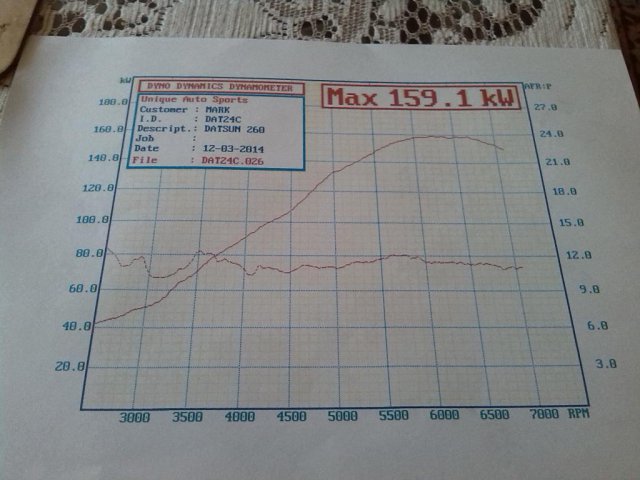

I got serious and managed to get a final figure of 159.1 rwkw which converts to 213 rwhp. NA. Megasquirt.
There's certainly nothing too wrong with the Clifford if it can support this much power. Ignition is standard 280zx dizzy, 20 deg. static with 30 total.
