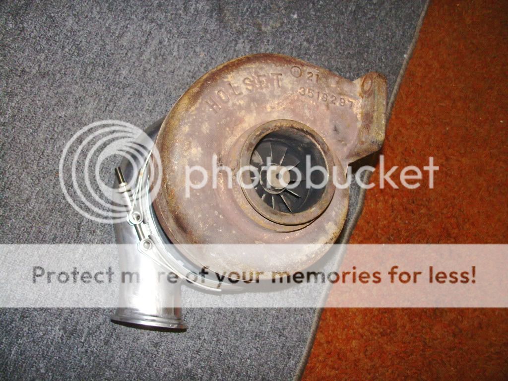

BluDestiny Posted March 9, 2011 Share Posted March 9, 2011 Hey Just picked up a Holset H1C turbo for $200 because it was missing the vband clamp for the compressor housing, brought it to a holset rebuilder to get the Vband clamp and he said it was in great condition. Its a huge turbo, I'm still in the process of getting everything together, need to bring my stock manifold to a welder to cut a hole and install an external wastegate (turbonetics 42mm) and also have him fab up a downpipe. That way I can get everything put together and installed as "one piece". Anyway I read a few threads about these turbos, found out it has an 18cm^2 turbine housing from this: http://forums.hybridz.org/index.php/topic/84733-which-holset-is-which-look-here/ But I couldn't find a topic where someone said "hey I am running an H1C, not an Hy and not an Hx series" I know that it is practically like an Hx35 since it had the 8 blade 54mm inducer. Also a really nood question, but since it's a twin scroll, do I need to change out the turbine housing to a single from an Hx35? I will be posting pics later tonight. Quote Link to comment Share on other sites More sharing options...
BluDestiny Posted March 11, 2011 Author Share Posted March 11, 2011 Ok took come pictures of it. Polished Compressor Housing was a nice touch The turbine side doesn't seem in that bad of a shape either And my turbonetics wastegate to go with it Quote Link to comment Share on other sites More sharing options...
