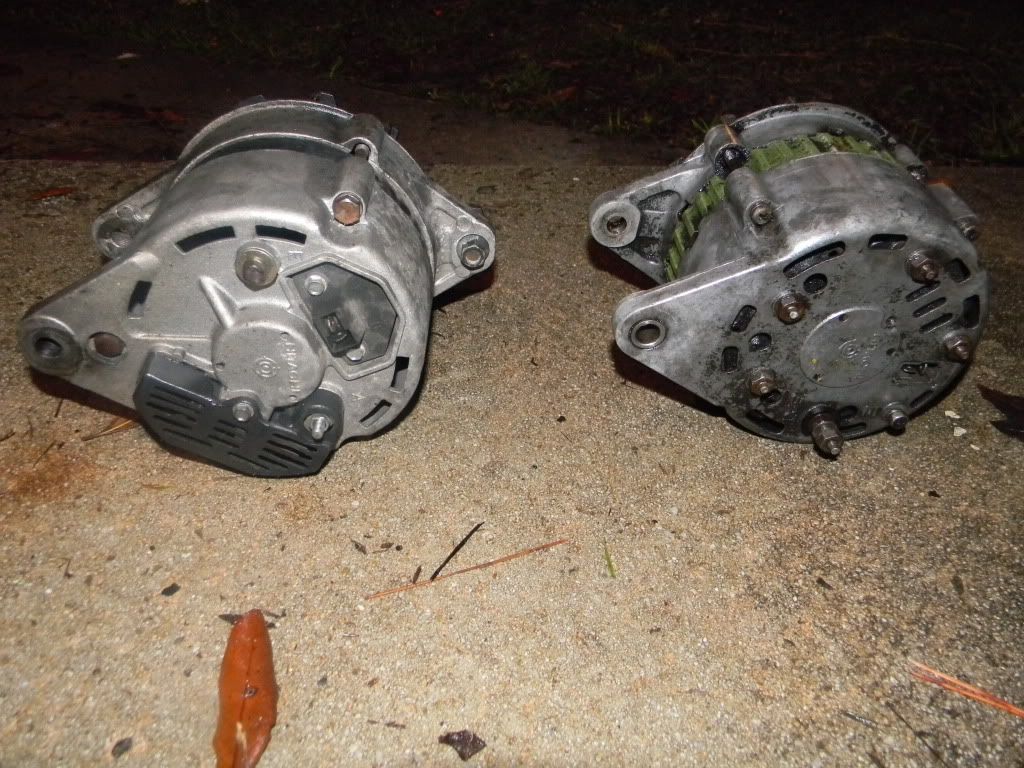

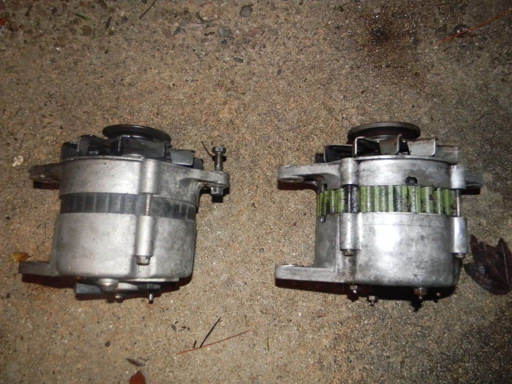

Here are some pics of the alternators to compare...
s30 alt on the LEFT, and s130 alt on the RIGHT

1975 comes with a 60 amp alternator and an external voltage regulator. The main thing you get with the ZX alternator would be to save money on buying voltage regulators.
I don't think that a ZX alternator would be 50 amps either. I think that Datsun went to 60 amps at the 260Z and stayed there for quite a while. You probably have an old external Z alternator.
