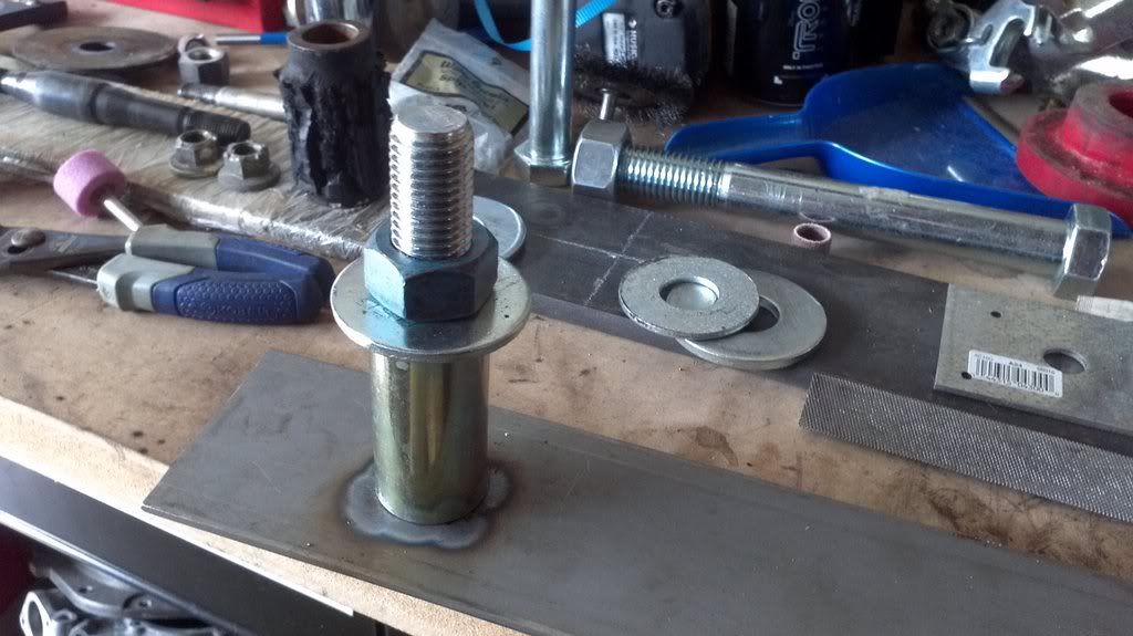

tec280zx Posted May 30, 2011 Author Share Posted May 30, 2011 A little progress so far. Gotta loosen up the rust on my welding, but heres what I've got so far. The gold colored spacer represents the subframe bushing. Same insert actually. Quote Link to comment Share on other sites More sharing options...

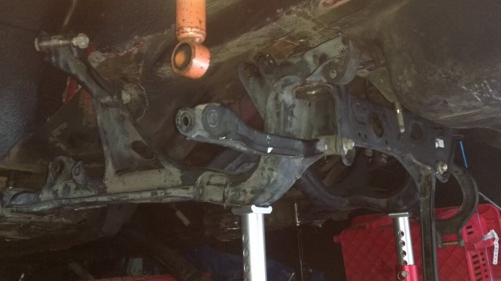

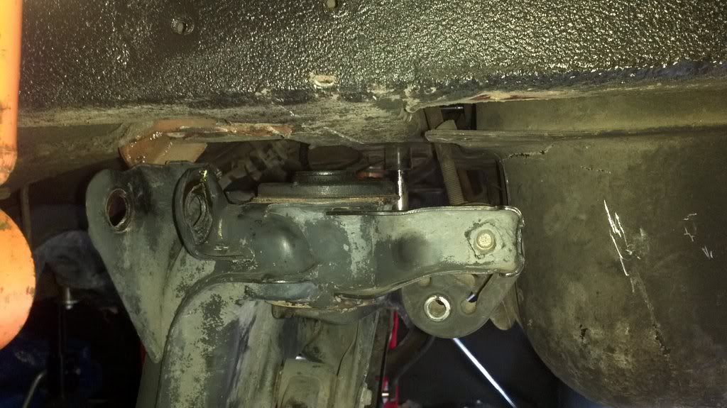

tec280zx Posted June 3, 2011 Author Share Posted June 3, 2011 A little peek at the front mounts. Can't get the subframe all the way up yet because of the fuel/brake lines. I still need to sort that out. 3 in tube will be welded to the subframe at these locations. Problem area. Need to relocate this little cluster of fuel and brake lines. Once thats done I can move the subframe all the way up. The transmission tunnel may need to be massaged a bit to get it all the way up. Quote Link to comment Share on other sites More sharing options...
tec280zx Posted June 7, 2011 Author Share Posted June 7, 2011 Front mounts tacked on for test fitting. So far so good. Probably gonna need a .750 to 1.00 spacer for clearance. Maybe not though. Crappy pic but here is how it sits for now. Many tweeks still needed. Hard to get good photos as I'm working out of a 1 car garage. Quote Link to comment Share on other sites More sharing options...
