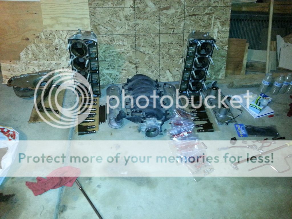

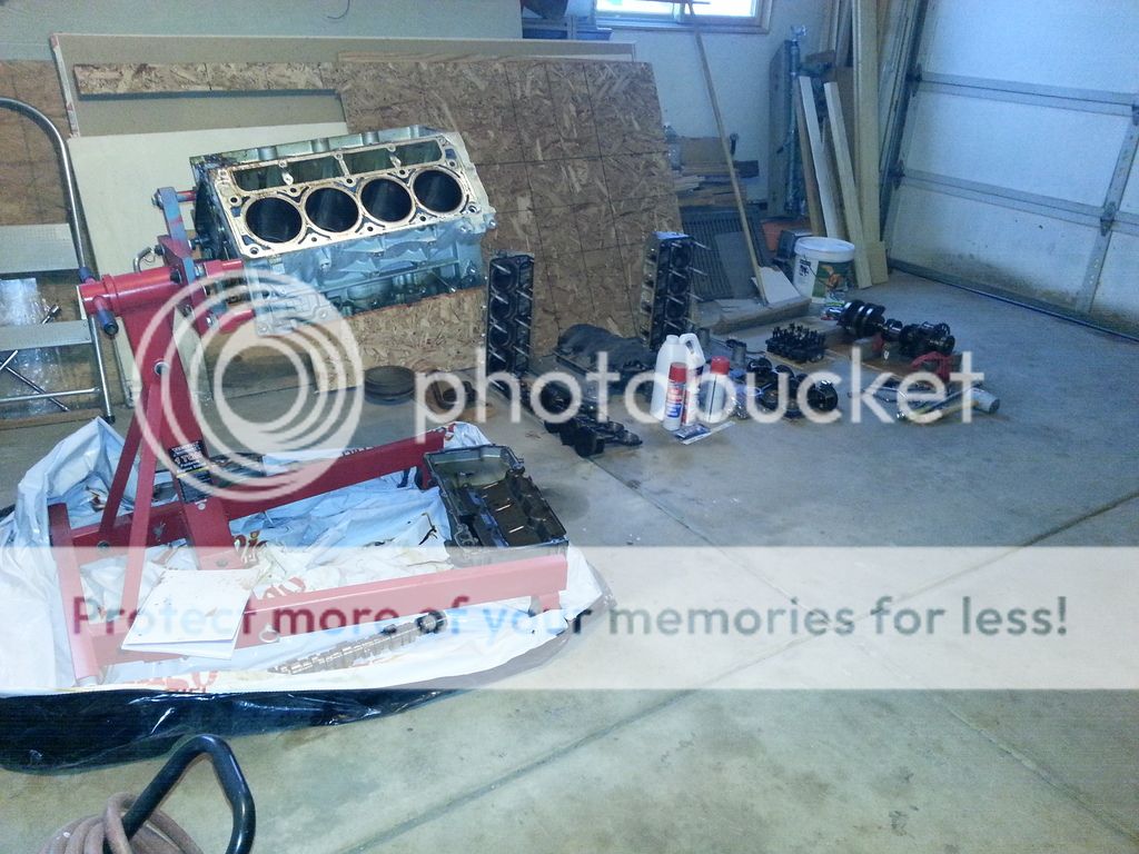

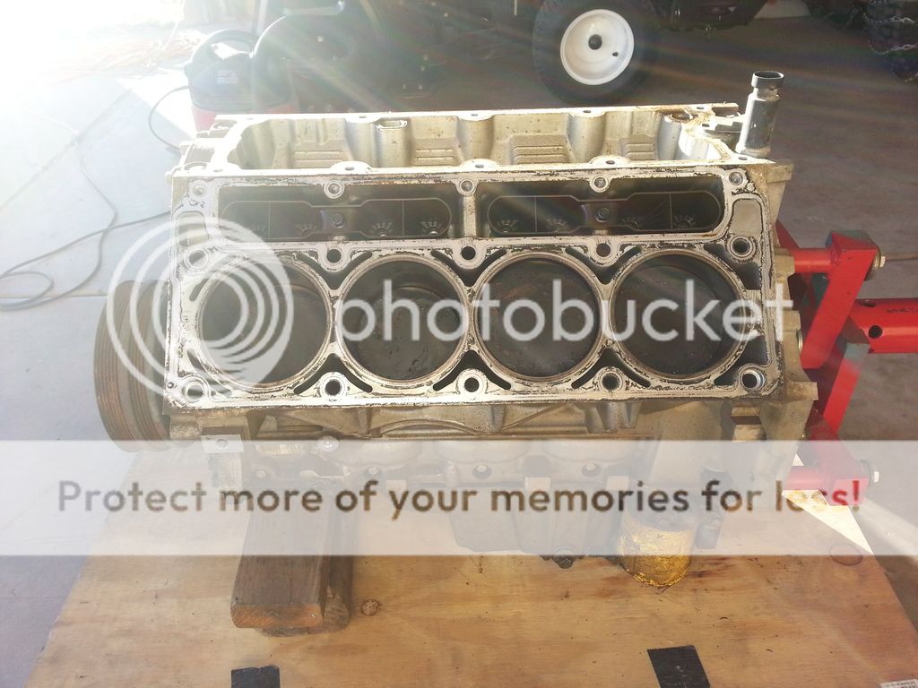

Well enough about personal life. I did manage to do some work with the Ls1 in my dads garage disassembling it. As you can see from the pics, not a very big garage. Did not feel like working on the car outside either. Also didnt feel like taking over his garage, im a person who respects other peoples property/space. Dont have to many pictures of this process nor any good pictures so bare with me on this part.
For the two and a half years I was there, that was all i accomplished, i know pretty pathetic. I just took all the parts and boxed them up.  During that time, all i did was save money and buy parts after parts. Dont have pics of all the parts i bought and dont feel like unboxing and taking pictures, would take me all day for that, but you will see them through out this thread when it comes time to work on that area of the car. Here are what i did take pics of.

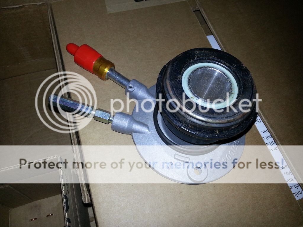

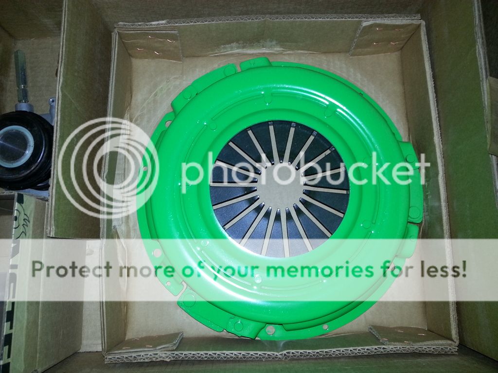

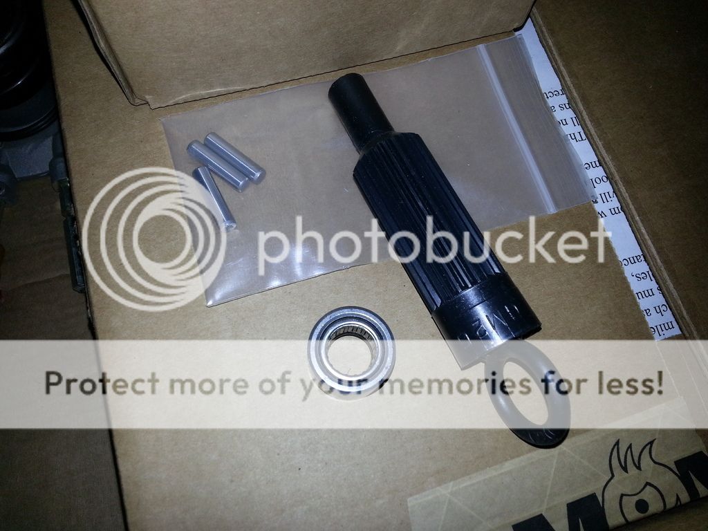

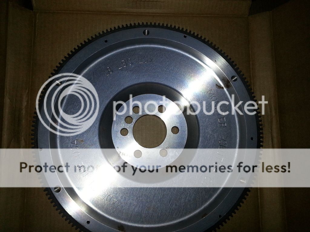

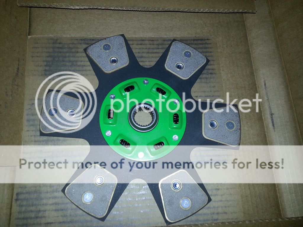

Monster Clutch/Flywheel kit, i think its stage 3, cant remember right now.
Yes these are authentic and real. Still wondering if i should use them or not.

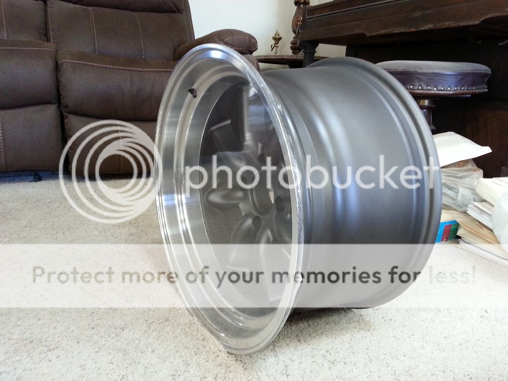

Rota RKR 17x9.5 all four. Wanted Watanabe wheels, but i guess im not baller enough to pay the price. These will do.

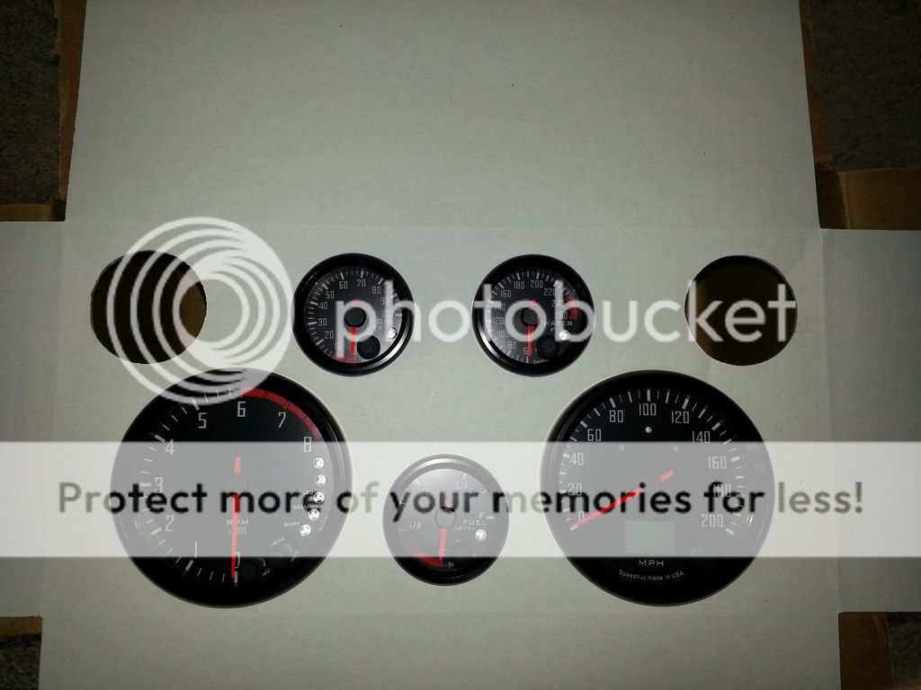

Speed Hut custom made gauges. Not the gps, kind of wish id go back and order gps instead of hard wiring the speed gauge. I know picture sucks, There will be a better one when its time to install these.

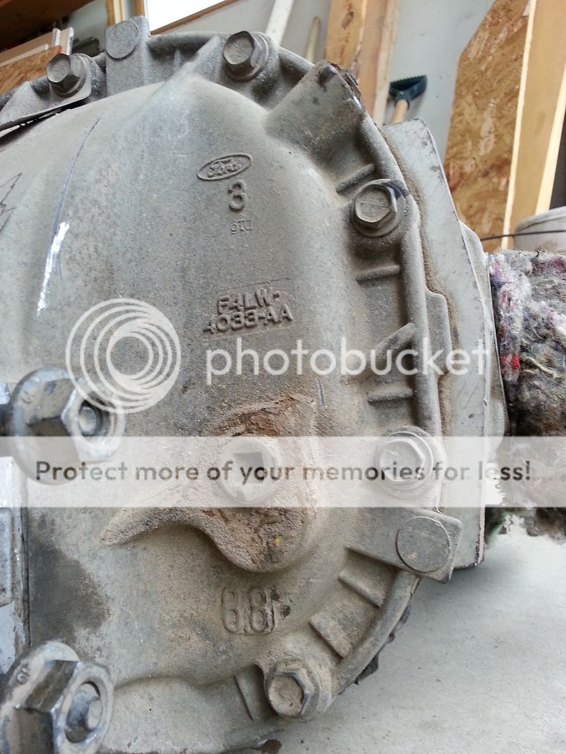

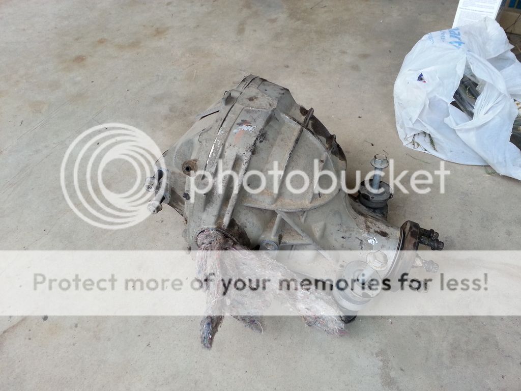

8.8 rear diff I pulled from the local pull parts salvage yard. Was a b*tch to take off the car because I didnt bring the right tools, but with some clever thinking and lots of time, I managed. What made it worse and really pissed me off is that it rained half the time i was there.

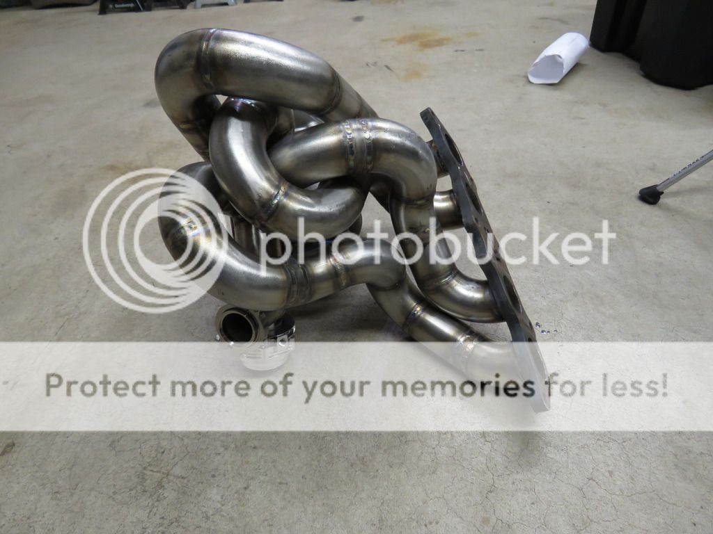

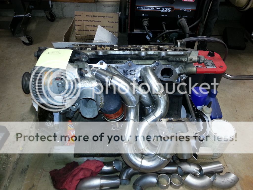

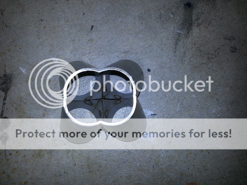

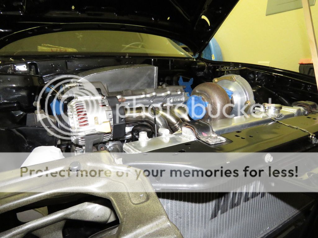

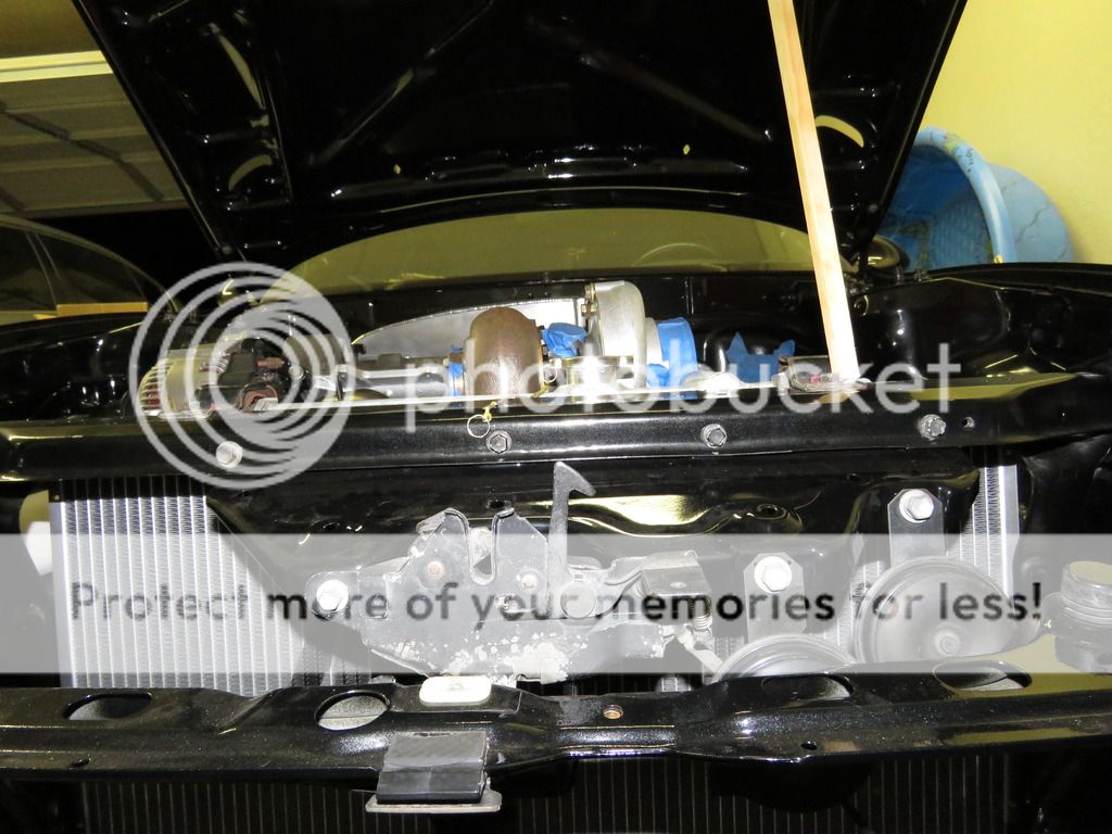

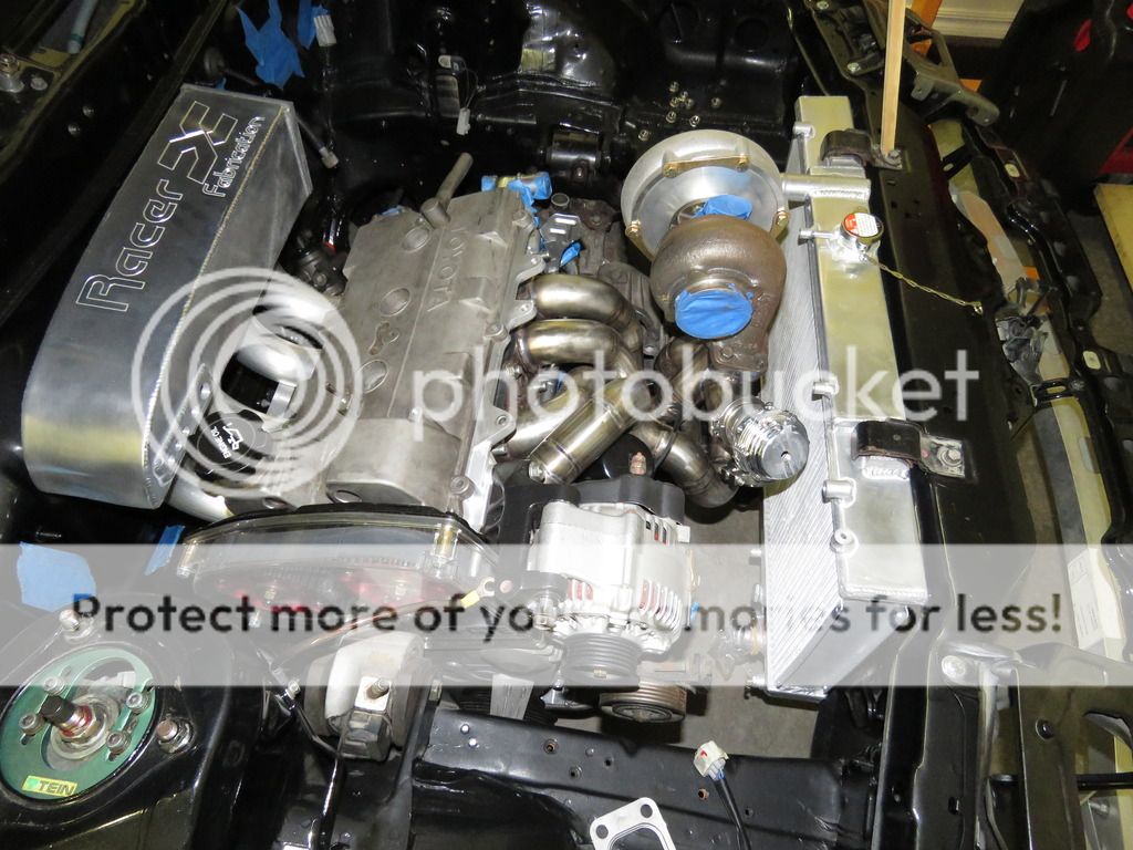

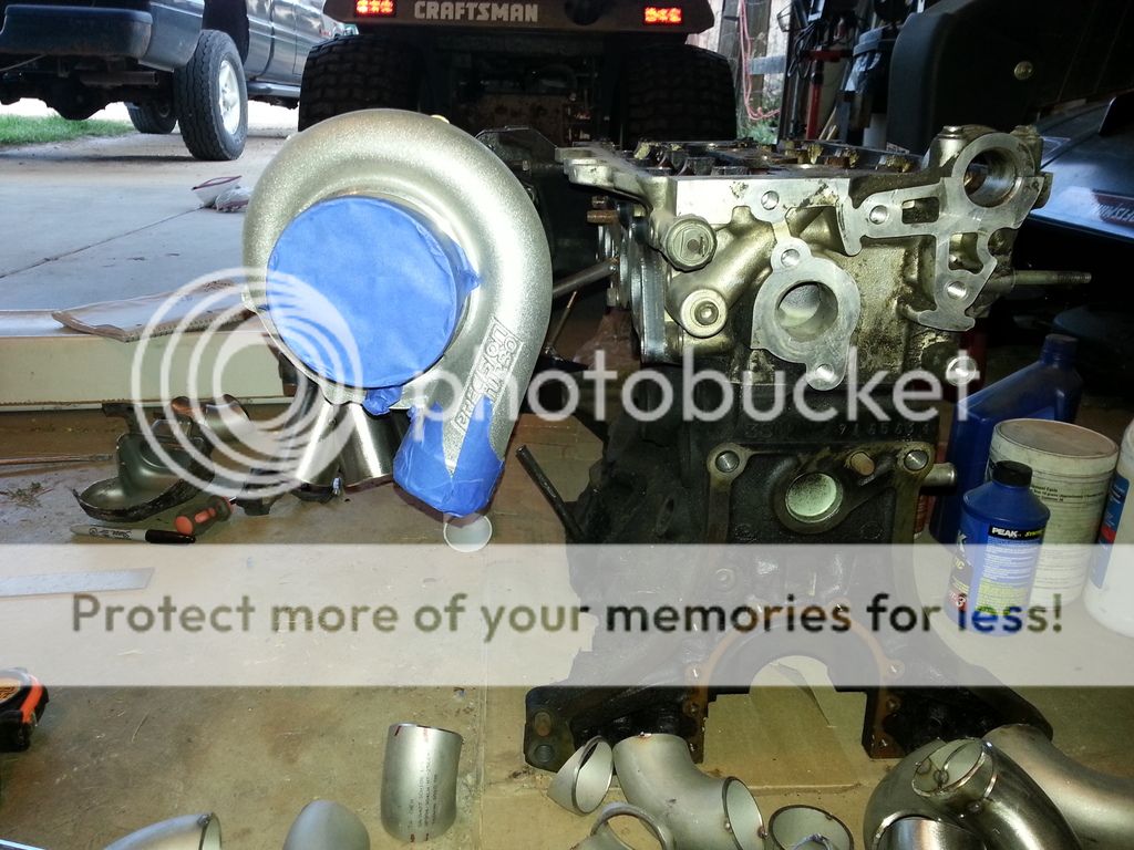

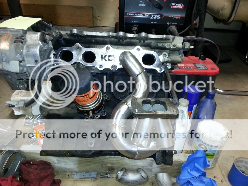

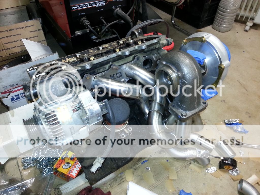

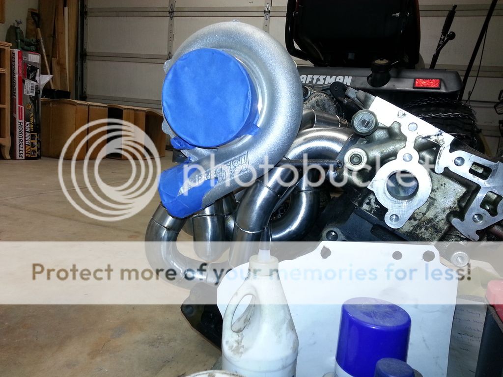

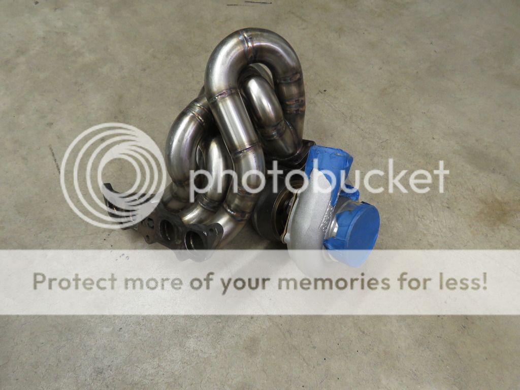

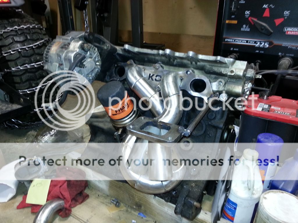

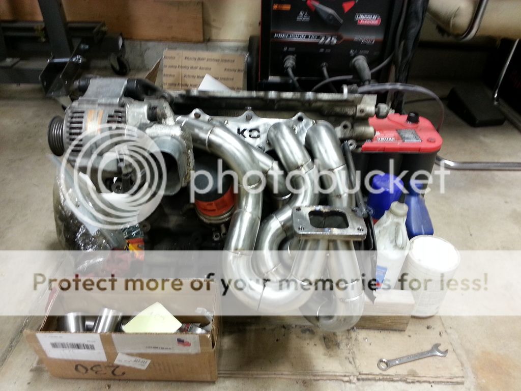

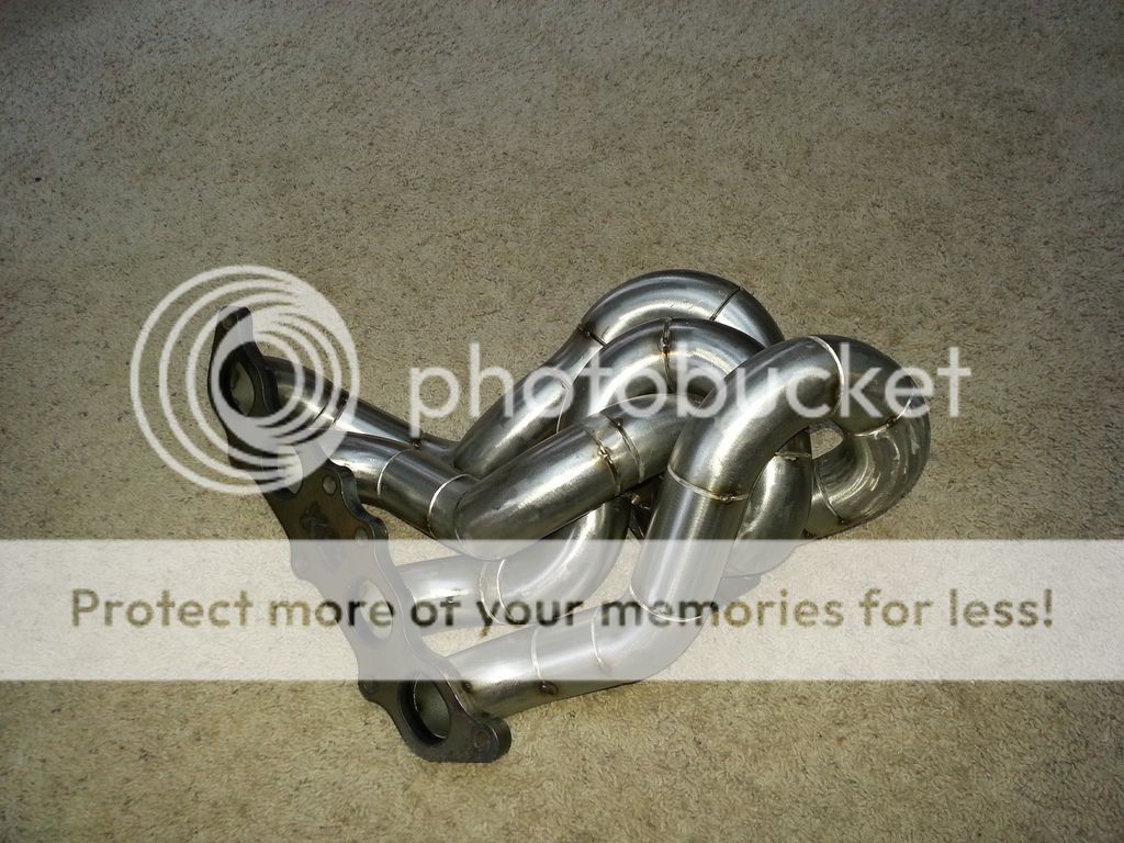

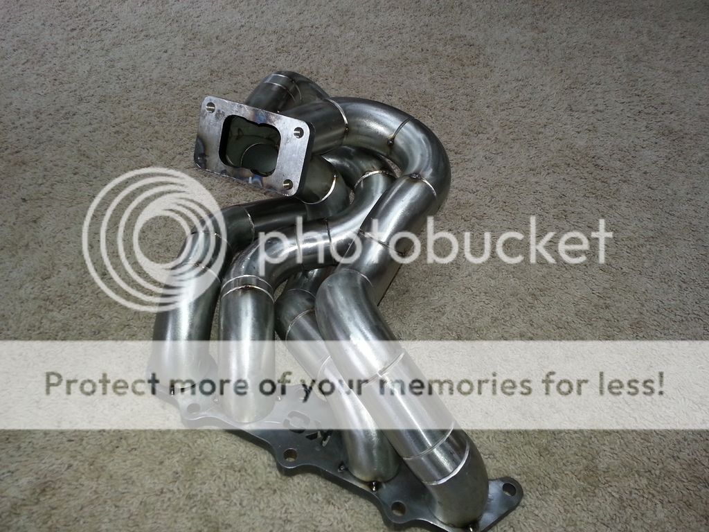

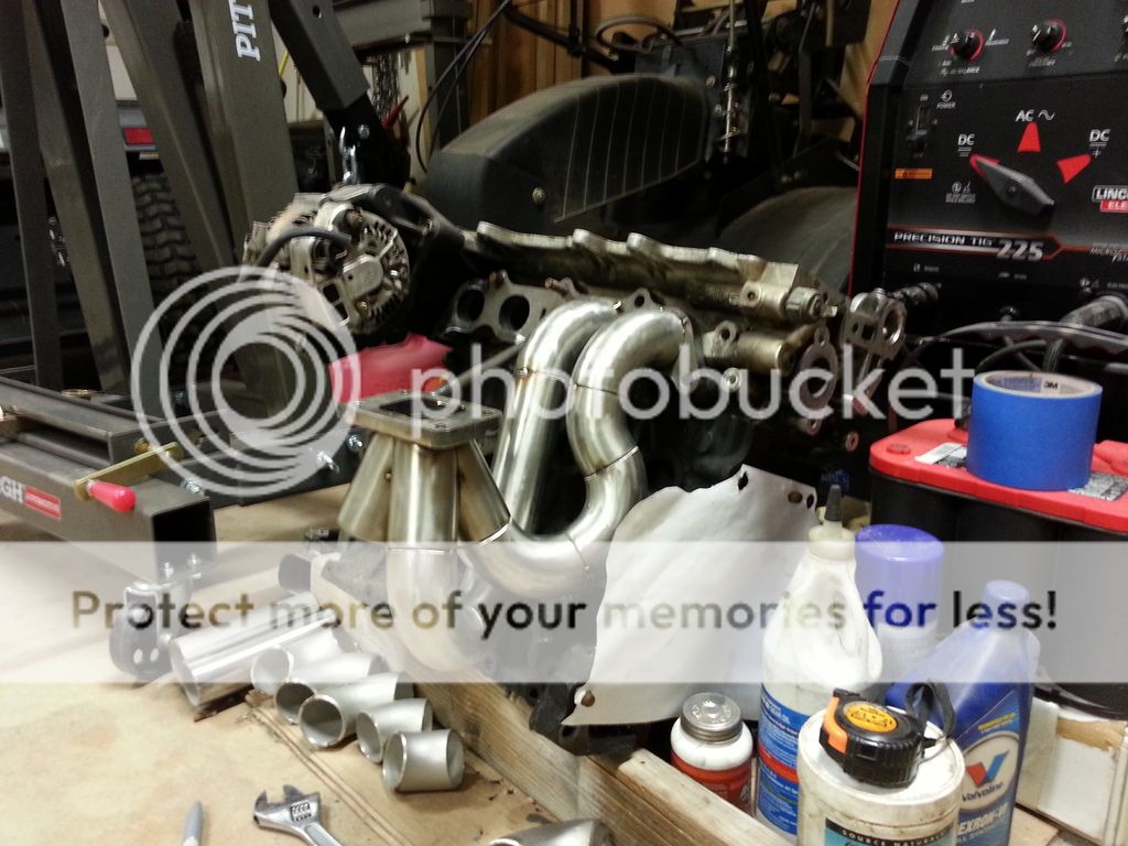

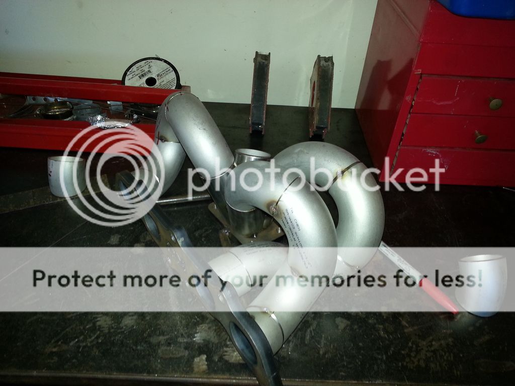

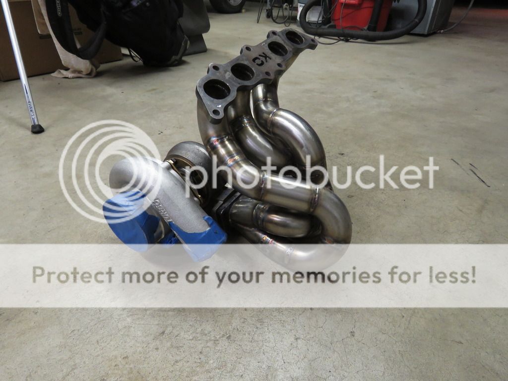

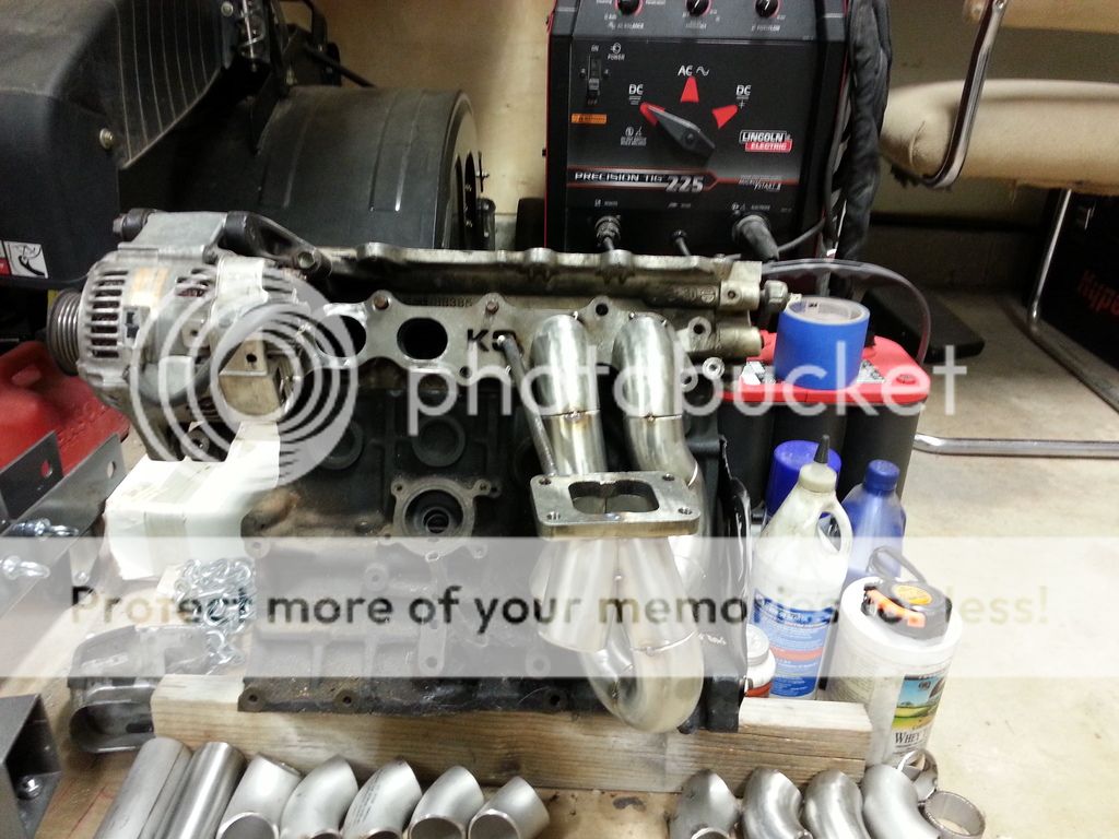

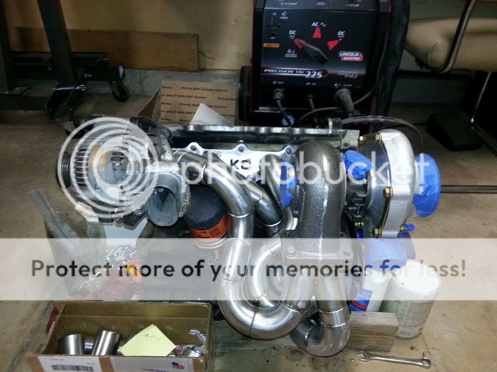

Well i did work on something, my brothers turbo manifold for his all trac celica motor. Though i didnt have his car, i did have a spar engine to help me mock up the manifold.

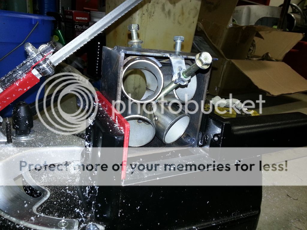

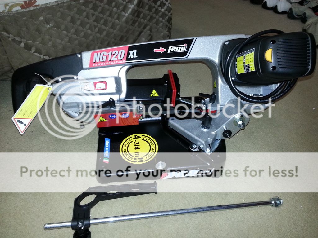

First my what was once a new band saw. One of my favorite tools.
Pictures from back in Oklahoma when i worked on it some. The collector made and test fitting. He originally wanted a simple ram horn style bottom mounted turbo.
That idea didnt work out to great and i wasnt liking it. Told my brother i am doing top mount. I spent some serious time working on it. Had multiple set ups to go about it. This was done in Colorado.
That path was scraped. Finally ended up making it this way.

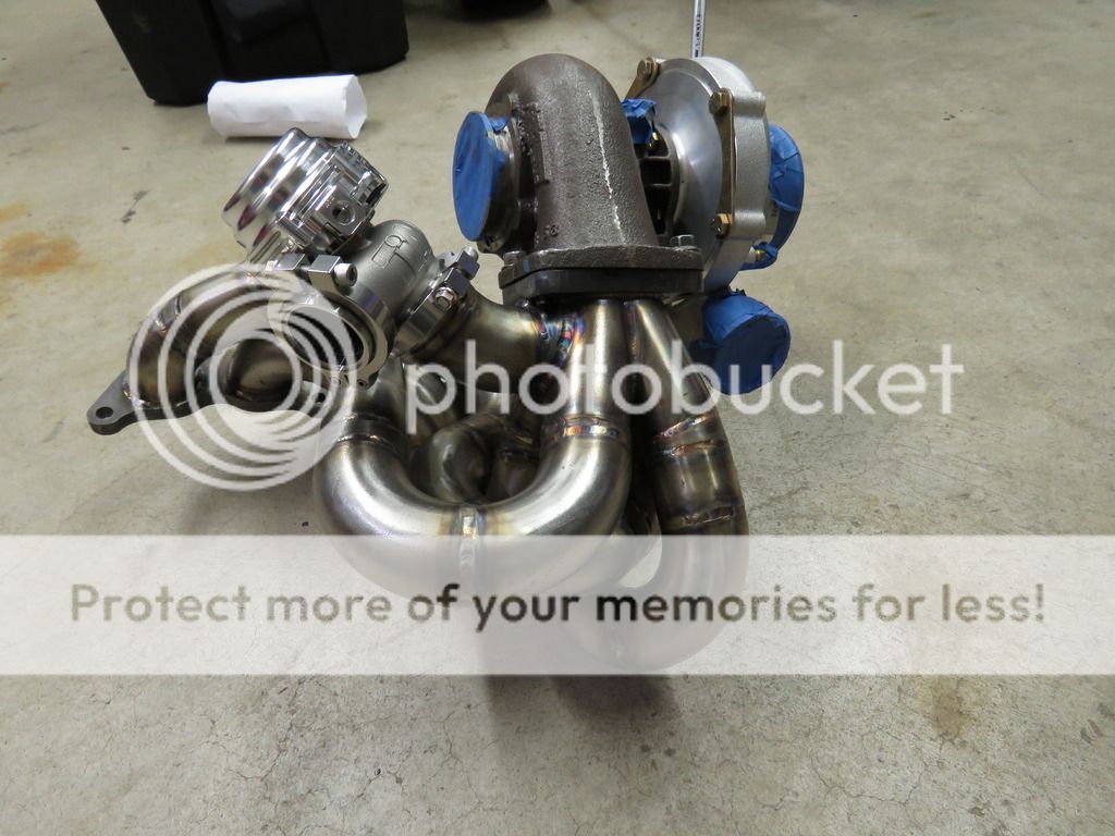

All tacked up. This is where the manifold came to an end when i was in Colorado. I didnt want to weld it yet cause i wanted to actually test fit it on the car.
About 6 Months ago, i got a call from my other brother telling me he could hook me up with a great job back in Oklahoma City. After thinking about it i took it and moved back, working now as a Petroleum Landman. My Engineering tech job in colorado springs wasnt all that great and the company was pretty much in the grave. I went through 3 lay offs the 2 years i worked there, first layoff was the biggest, second about half amount of people let go, third about half of the second layoff let go. Fortunately they kept me each layoff but i knew there wasnt a future with them. Glad to be back in oklahoma, now making twice the amount of money i made at my tech job and actually able to have pay increases through out the years. One thing i did miss was the weather in Colorado, believe it or not, the weather was enjoyable, yeah it did have its bad cold moments but for the most part not bad at all. Out in Black Forest where my father lives does have strange weather. Lightning shows were cool, literally couldnt count to 2 or even half a second without lightning flashing, no pics of that though.
Looks like some kind of wedge tornado, but just a cloud passing by.
When it fogs out it, it is thick. Be times where you cant see 10 feet in front of you.
Deer passing by.
Strange looking beetles, glad i didnt touch them, if my memory is correct, if you touch or smash one on your skin, it creates a rash/blister, hence there name "blister beetles".

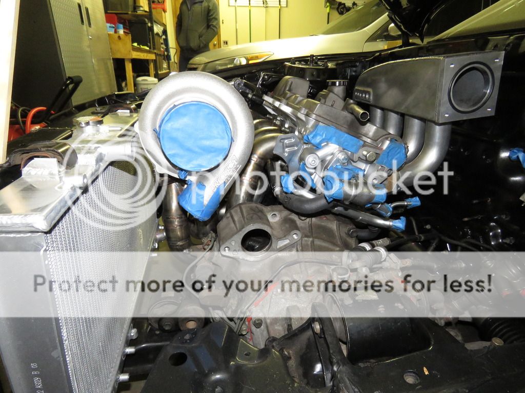

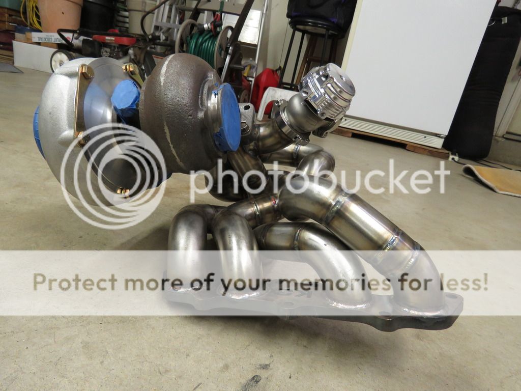

Well anyways, back in Oklahoma now, finished my brothers turbo manifold, worked on my car some. Sold the original motor. Been working on repairing the rust. Havent done much yet. But will be, just waiting on some tools to be shipped to me.

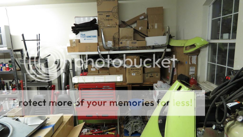

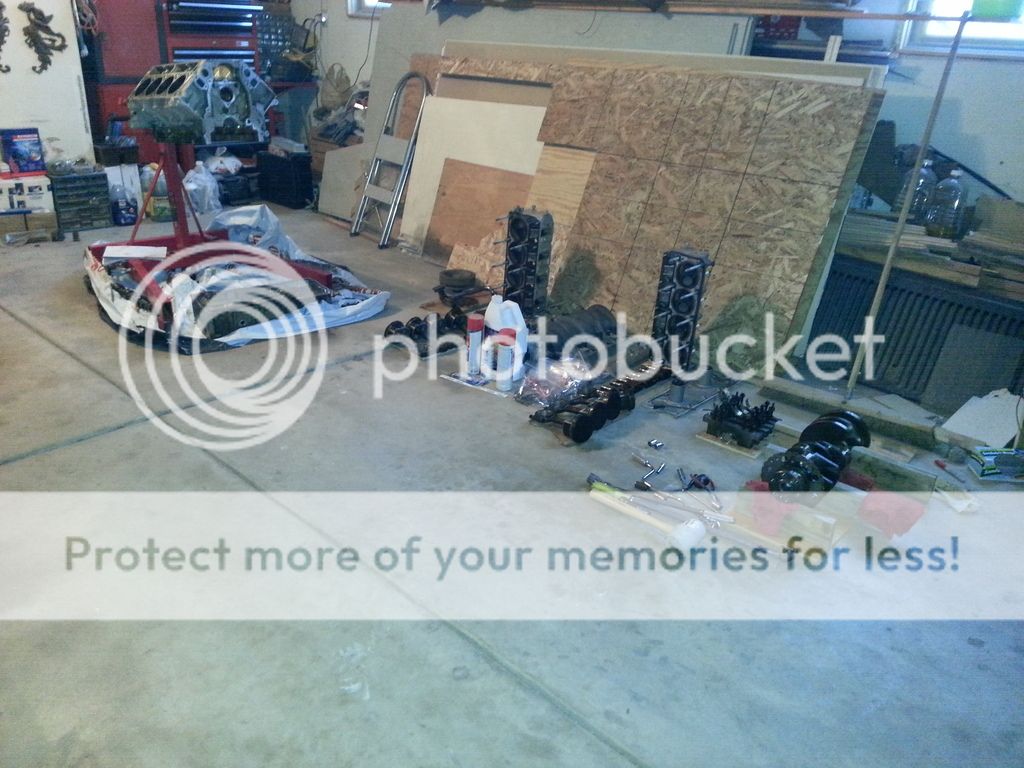

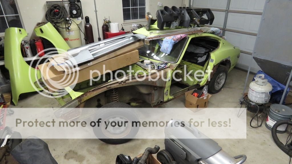

Back to me and the datsun, got off topic. Pics of the datsun and all the parts in the garage. Much more room now to work on it and if this isnt enough, my other brother is building a shop at his place.
Right now, waiting for my Baileigh bead roller to come in, also waiting for my dimple dies to arrive so I can work on making a new inner rocker panel. Bout to order brakes, waiting till next week though, never know if black Friday/cyber Monday has any deals. Mean while ill work on getting that rusted piece of crap drive inner rocker out.

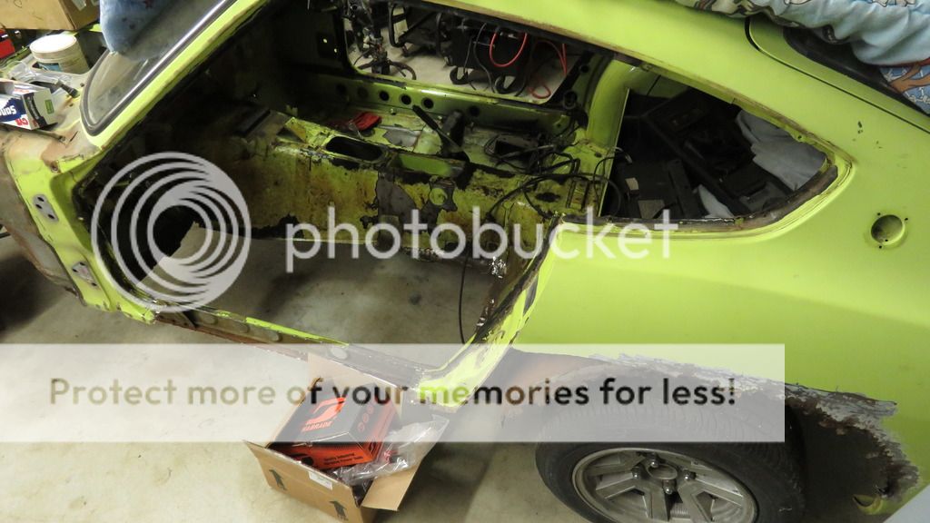

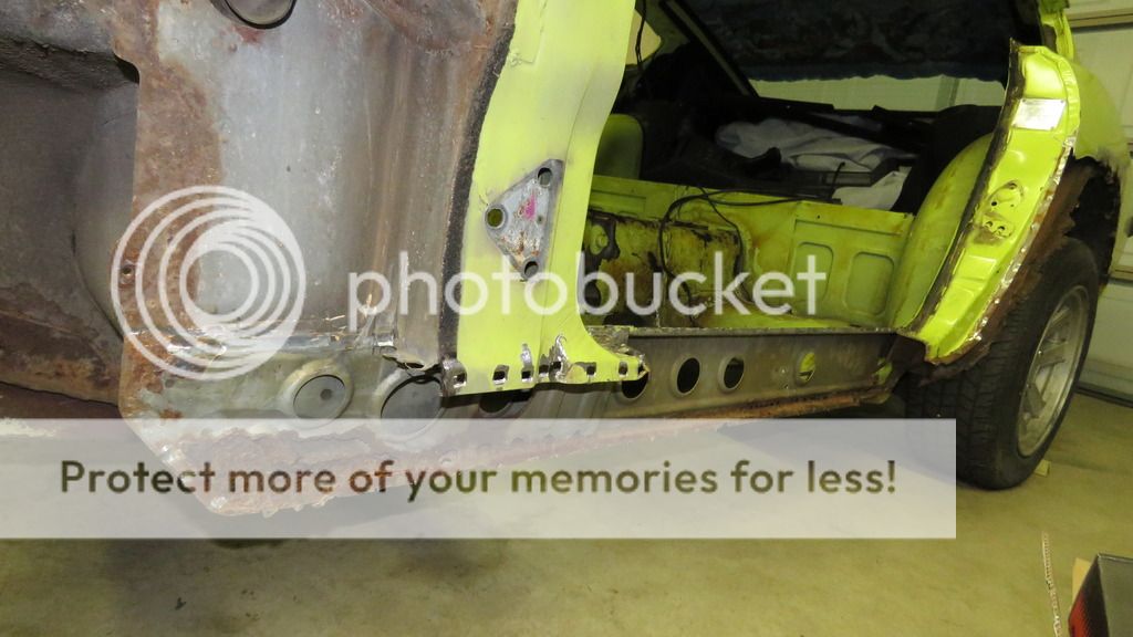

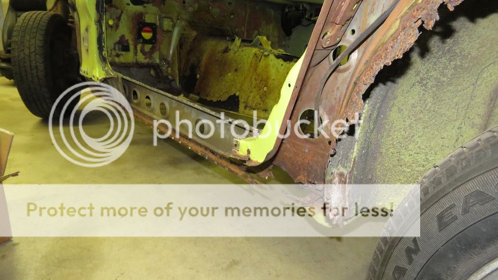

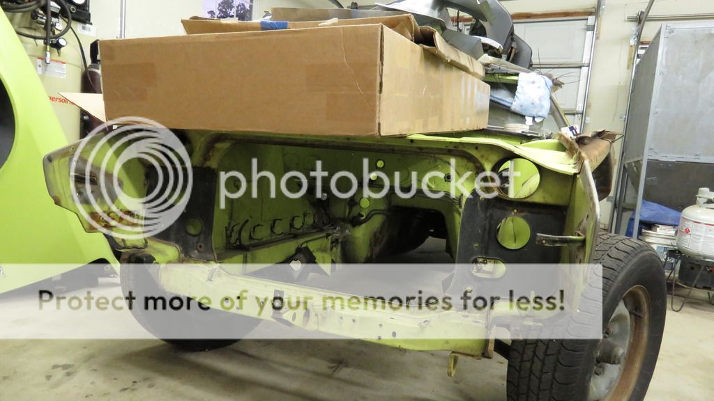

Small update to my project. Finally got the inner rocker panel taken off, ended up using the plasma to cut some areas out. Gonna have to cut out some more rusted metal. Good news is that whats on the car now isnt to bad to replace, for the most part just straight flat metal, no complex curves/shapes.

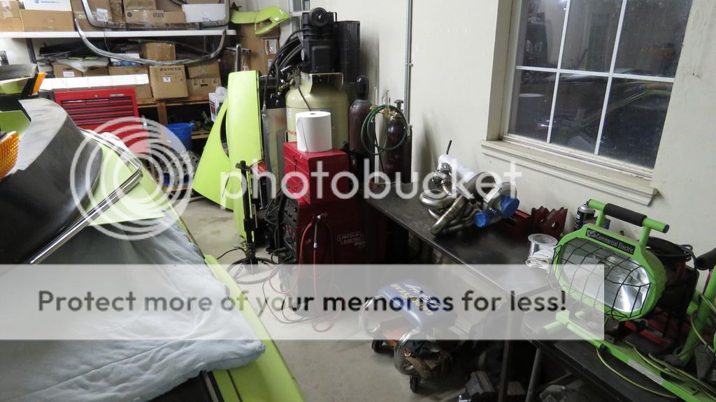

The crate that the bead roller shipped in, I turned it into my tool chest/work bench. Had to restructure the inside a bit to make it more sturdy and added hinges.

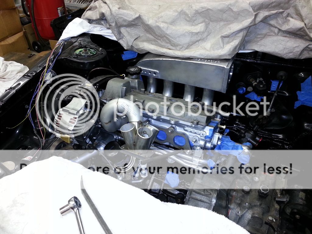

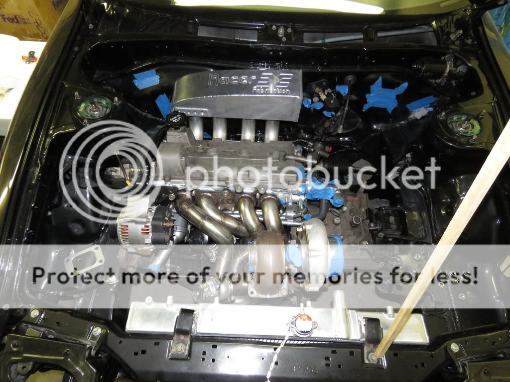

Recently I was working on a friends car.  He brought his RX7 FD LS1 to me to work on the exhaust and fix the transmission mount. This car is mainly for road race with not much street driving, or so he says.

Got some things accomplished today such as getting the transmission tunnel mounts spot welded on to the car and made the support/tie in plate for the front of the inner rocker panel.
Pictures of the tunnel mounts.

Originally I started making the front support plate for the inner rocker panel like the stock one, but that didnt go so well, not sure why.  Anyways I decided to just make it my way and it worked out.
Picture of the stock front support plate.
IMG 0166
My version, could add a few beads to help strengthen it, or maybe even go about it differently, but i think it should be alright.
IMG 0157
IMG 0158
IMG 0159
IMG 0160
IMG 0161
IMG 0163
The rear support plate for the rocker panel I have no idea what it looked like, guess I will just make it my way.  Will do this tomorrow.
Edit: For got to mention that when I spot weld, I use my Mig machine. Below are a couple of pictures of some testing to see how strong my  welds were.  As you can see the weld itself ripped/tore the 18g sheet metal, which is a good thing.
