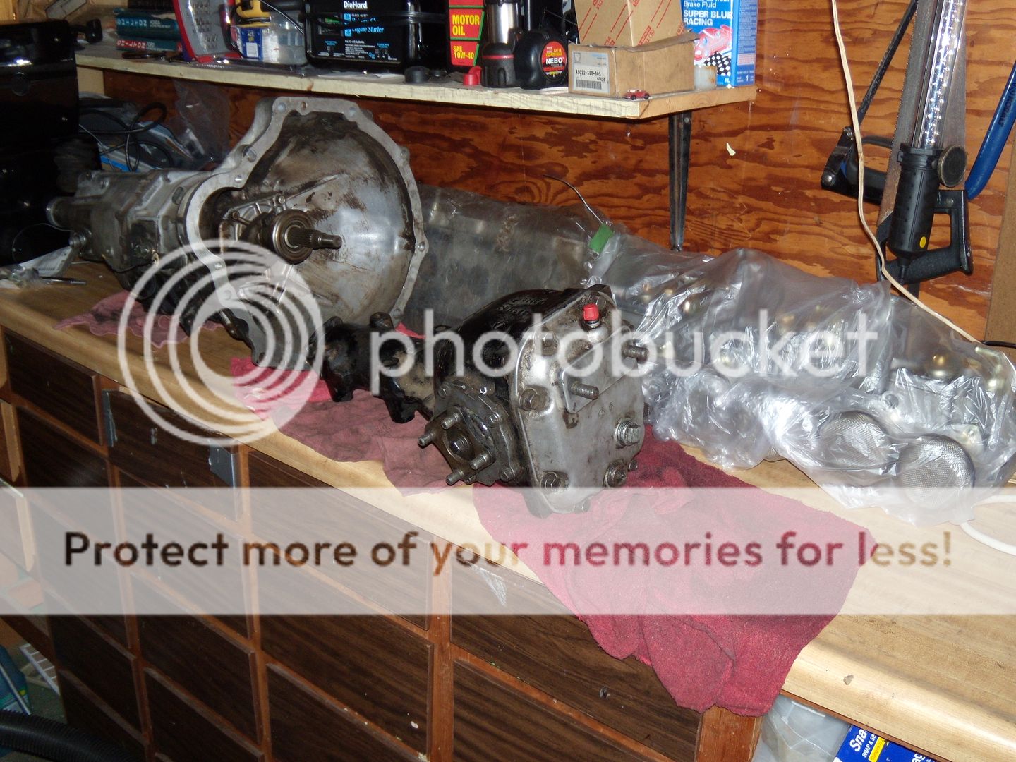

#40 Leon
Leon
    Tremendous grasp of the obvious.
  • Donating Members
  • PipPipPipPipPipPipPip
  • 2303 posts
  • LocationSan Bruno, CA
Posted 30 March 2013 - 12:39 PM
Diff came in on Thursday! I finally had some time to unpack it and put it up on the bench after doing some cleaning this morning. I got a tip from a local racer as far as diff shops go. Apparently, the place to go is SF Differential in South City, so I may be paying John a visit. :)
