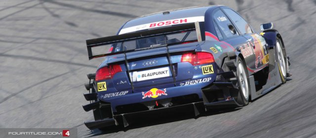

I have some pretty radical ideas as to how to improve my cars aero package. I just cant do it in the middle of a race season because I don't have enough time between races to make the modifications to the body panels and then get adequate testing done. I don't want to share it out loud until I have personally tried it out on my car (if I ever do), but I will say that it hasn't been done yet with one of our cars.
I have an idea of exactly what I want to learn and test in the wind tunnel on my car. I will share the information gathered. If you decide it can help your project and want to apply it to your own build, I have no problem with any of that. The reason we all share our threads is to help one another. I hope that it helps in some way or another but be aware that we are all different drivers driving different cars with different set ups and in no way will we find a universal application in terms of aero that will apply to everyones individual needs. To say that a g nose helps the air move better across the nose because the wind tunnel data shows that to be the case does not mean that a g nose is a better application for a persons specific needs.
I will say that we, MTI Racing, are presently fabricating a DTM body for a C6 Corvette. This series will be in the US in 2015. If there is any sports car series that can lend us an insight to what actually works and how different it is to what we all have, then this is the series. All the cars are relatively the exact same car under the different outer shells. The driver and outer shell (aero set up) are the only real variables that separate you from the rest of the cars. The downforce and aero packages on these cars are what you will be seeing more and more of as we move forward. If anyone is familiar with time attack here in the states, it also shares the same traits as these DTM cars. I guess now you know what I'm thinking when I say I have some radical ideas about how to change the performance of our cars when it comes to aero.........
Sorry for the rant.................
