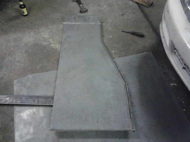

B. Whisky Posted March 7, 2014 Share Posted March 7, 2014 (edited) 1x3" 14 gauge tubing for the rails. Used a wide flat vise grip and some beer to bend the edges. Edited March 7, 2014 by B. Whisky Quote Link to comment Share on other sites More sharing options...
B. Whisky Posted March 7, 2014 Share Posted March 7, 2014 I used angle steel to create a lip along the length of the rocker, so as to align the floor with that. The floor now sits a half inch or so higher but I think its for the better Quote Link to comment Share on other sites More sharing options...

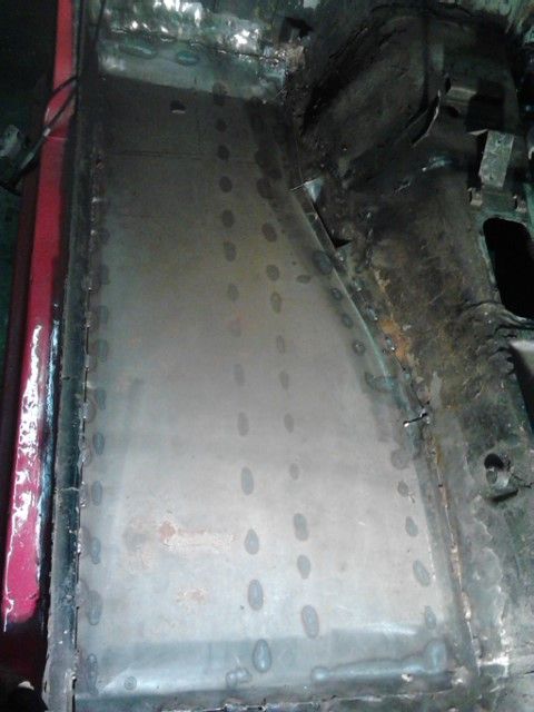

SUNNY Z Posted March 10, 2014 Share Posted March 10, 2014 Finished up my passenger's side. Quote Link to comment Share on other sites More sharing options...
