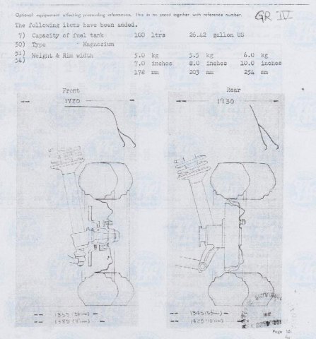

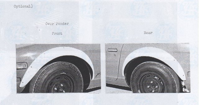

Here are dimensions for the 432-R type overfenders (the very first overfenders made and homologated for the S30-series Z) and the 240ZG type overfenders, both from the original homologation papers:
