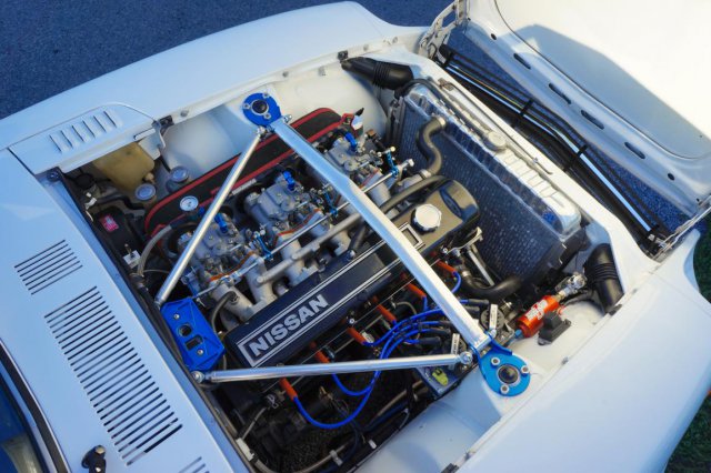

The local track had a test and tune event last night, so I took the opportunity to head to it and do a few drag runs and work on my carb tuning.  Had a blast, but I'm really not impressed with the times I was laying down.  My 60' times need some work, so that explains my slow ET a little, but the car *should* be capable of much better.  I'll be checking my timing this week to confirm it's where it says it is, and double checking some carb things.  My wideband was around low 11's to mid 12's during the run on the timeslip, which is a bit rich.
The previous owner of this engine laid down 188whp on the dyno with SU carbs, stock distributor, and a 2" exhaust system.  Surely my Mikunis, Electromotive ignition, and 3" exhaust should support better numbers.  The answer is probably in the tuning somewhere, dyno time in Spring I guess...
I'll also be thinking about refreshing my old E31 head and throwing an aggressive Isky cam in it.  Worst case scenario being if I am unhappy with the power, I can just swap heads and maybe wake things up a little.
But hey, the car *is* back on the road and I am enjoying driving it, so it ain't all bad  :)

Well, the car has been out of Winter storage for a few weeks now and I've managed a little work on it, so here is an update.
Decided to ditch the Mikuni intake manifold as I didn't like the bend it has in it, and there were some clearance issues with how it raised the carbs up higher in the engine bay.  I picked up a Harada manifold for about $400.
26876763381_a343bb89ae_c.jpgharada by ryant67, on Flickr
The casting on the Harada is quite rough, and I didn't like the look of the intake runners as they were.
26876761241_d05d605756_c.jpgharadarunner by ryant67, on Flickr
I cut a slot into a piece of 3/8 steel rod, folded some emery cloth into it, then set to work with the power drill.
26339353504_d4720f19cb_c.jpgflapper by ryant67, on Flickr
A couple of hours of work later, and things were looking a little better.
26944973285_b0bb6656a1_c.jpgrunner by ryant67, on Flickr
Off with the old manifold.
26671488850_c3e3a10e86_c.jpgIMG_20160507_161953 by ryant67, on Flickr
And on with the new one!
26944984105_722b3397c1_c.jpgbay3 by ryant67, on Flickr
Looks rather excellent, I think.  The car seems to pull a little harder too, but that could just be my imagination.  I did take a little extra care to make sure all of the ports lined up well though, and the new manifold runs a lot straighter and is about an inch longer.
26850552432_48ca12a7c8_c.jpgbay1 by ryant67, on Flickr
I also added a few little finishing touches to the engine bay while I was at it.  Picked up a pair of fresh air ducts off ebay, which will be nice to have when driving on the highway, and added the little black caps to the strut towers.
26339362334_712ccd1774_c.jpgbay2 by ryant67, on Flickr

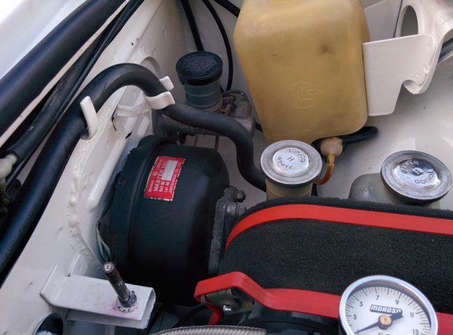

A few finishing touches to the engine bay, just minor stuff though.
Painted the starter and the brake booster, as they both had a little surface rust on them.  Just scrubbed them well with a scuff pad until the rust was off, then masked and sprayed with good old Rustoleum matte black.  Re-arranged the ignition leads due to some sloppy routing and contact points.  Ground down the bracket for my magnetic sensor so it better aligns to the trigger wheel, it was a touch too long before.

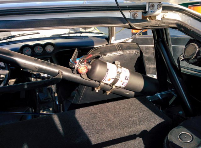

Painted by fire extinguisher matte black while I was at it, so it no longer sticks out like a sore thumb.  It's there, and I'm thankful, but it looked a little too "hardcore" for my taste when it was bright red.

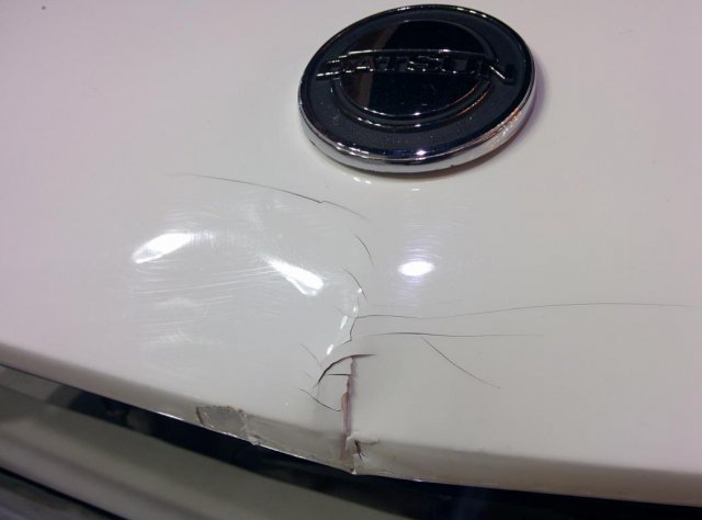

Posted 14 August 2016 - 01:30 PM
Might as well add a pic of the damage too

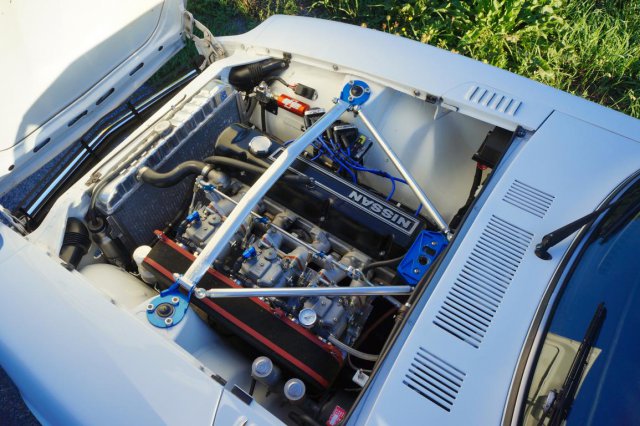

While they were doing all of this, I also bought some 6 louver inspection lids from ebay and had them paint them as well.  Quite pleased with them!

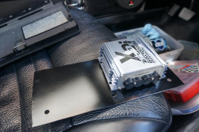

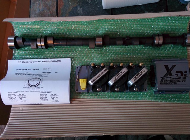

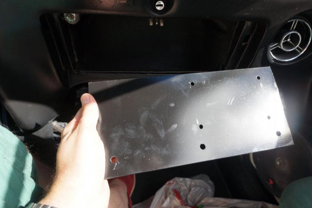

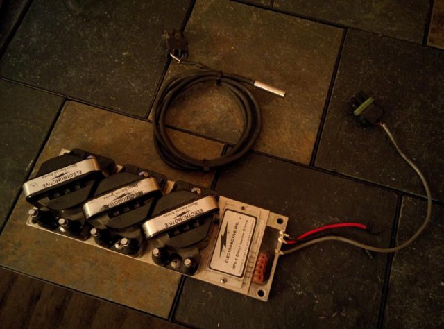

New toys for the car. Isky L6 grind cam, and an Electromotive Xdi, which popped up on ebay for a price I couldn't resist. Shouldn't be too much of a hassle to swap out the old HPV-1 system for it. It will be interesting to see if the new, updated system makes any difference over my very old looking one. Not sure if I'll swap the cam now, or wait until spring, we'll see.
#51 ryant67
ryant67
    Always Here
  • Donating Members
  • PipPipPipPip
  • 267 posts
  • LocationKingston, ON
Posted 12 September 2016 - 06:26 PM

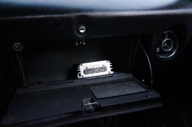

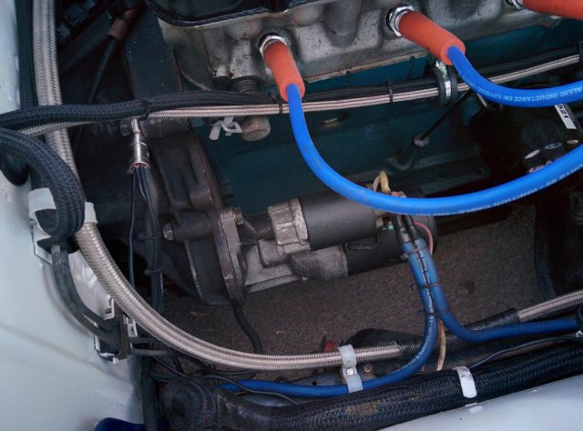

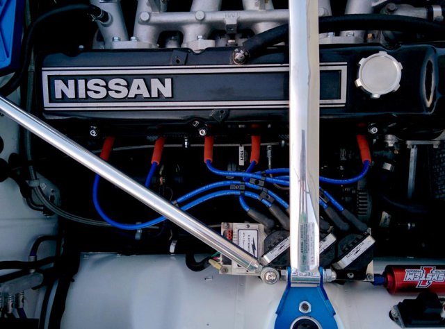

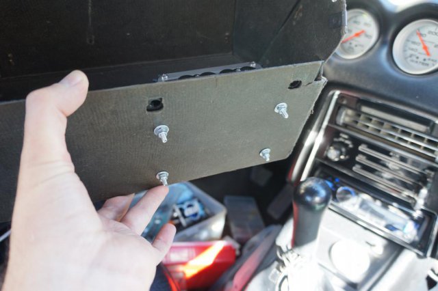

Got the Xdi installed on Sunday.  Took me about 3 hours, but the majority of that time was spent tidying wiring.  Very straightforward job and the car fired up on the first try, huzzah!
Not that noticeable a difference in performance, but it does look nice, new, and shiny.  No complaints.  I installed the Xdi box into the glove box, so as to avoid it being visible, yet still easily accessible.  I just made up a base for it to mount to with some spare aluminium sheet metal, which also screwed down onto where the glove box itself mounts.  Easy job, and I'm pretty happy with how it turned out.  The coils went where the HPV was mounted.
