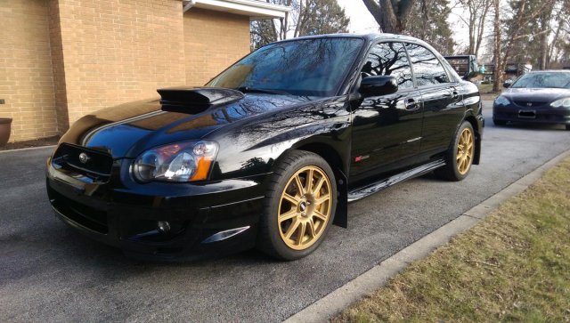

2005 Subaru Impreza WRX STi
Great car.  A real blast to drive.

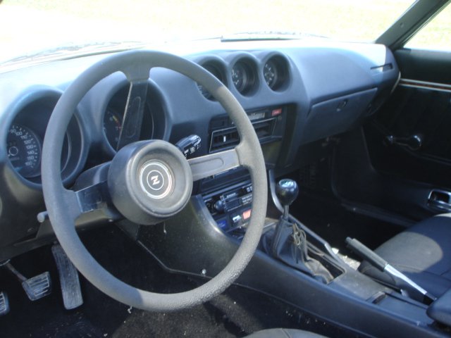

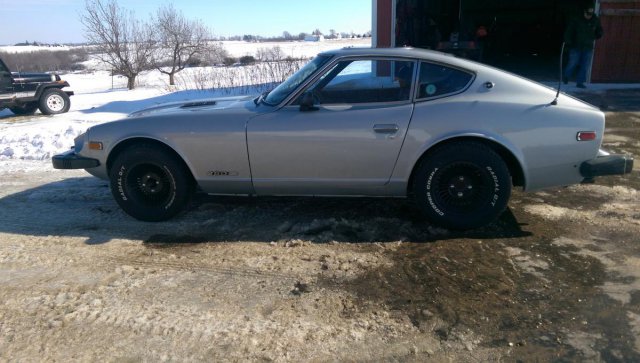

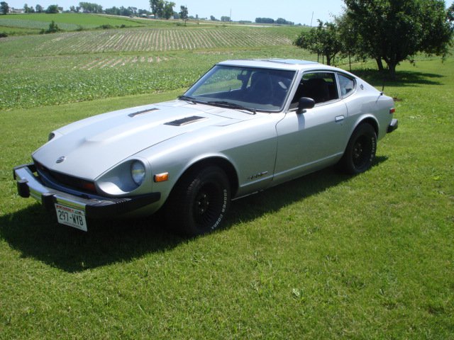

Original pictures from the listing on Windycityzclub.com:
post-54021-0-07358300-1488217095_thumb.jpg post-54021-0-63903700-1488217239_thumb.jpg post-54021-0-27863800-1488217240_thumb.jpg
post-54021-0-02744000-1488217241_thumb.jpg post-54021-0-27544200-1488217242_thumb.jpg post-54021-0-75904300-1488217242_thumb.jpg

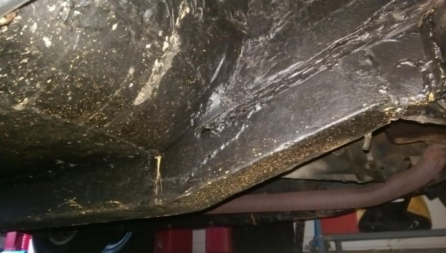

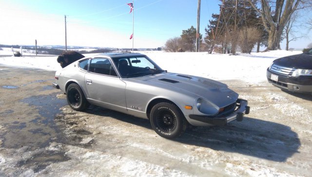

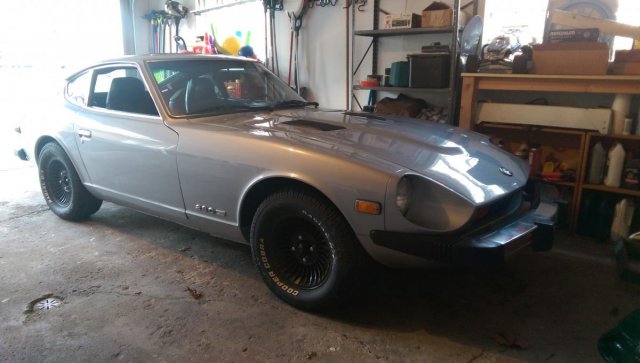

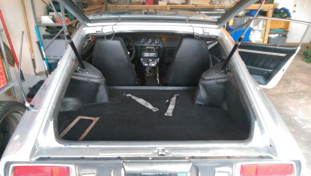

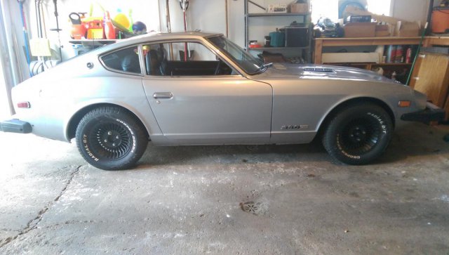

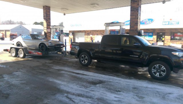

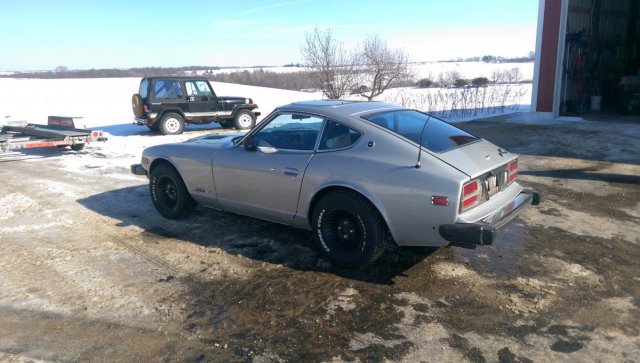

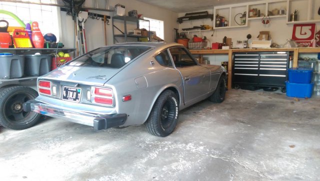

They day I picked her up:
post-54021-0-00787800-1488217263_thumb.jpg post-54021-0-03702000-1488217550_thumb.jpg post-54021-0-88703000-1488217555_thumb.jpg post-54021-0-98504300-1488217562_thumb.jpg
post-54021-0-90224800-1488217565_thumb.jpg post-54021-0-86625300-1488217568_thumb.jpg post-54021-0-81465800-1488217571_thumb.jpg post-54021-0-57641600-1488220938_thumb.jpg
post-54021-0-66077600-1488217638_thumb.jpg post-54021-0-94387100-1488217578_thumb.jpg post-54021-0-66876700-1488217633_thumb.jpg post-54021-0-41437200-1488217636_thumb.jpg

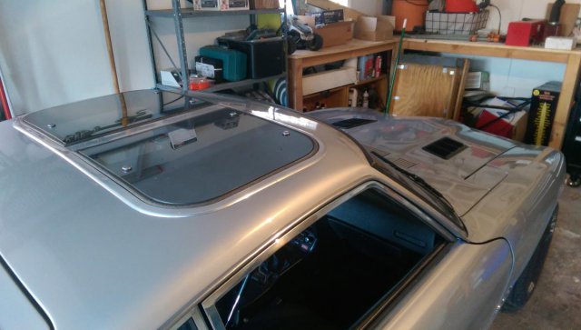

Have you ever seen an uglier sunroof?
The paint is in pretty good shape, owner said the car was resprayed a couple years ago and any rust was repaired with metal but there is definitely some filler on the quarters and rockers....whatever.  Some other issues include the radio, HVAC controls, and headlights are all dead.  The car sat in a barn for like 6 months so it has a funky smell, probably mice...which might have something to do with the electrical issues?  Also, the car falls flat on its face with anymore than half throttle while under load.   Meh, an LS will fix that, sorry purists.

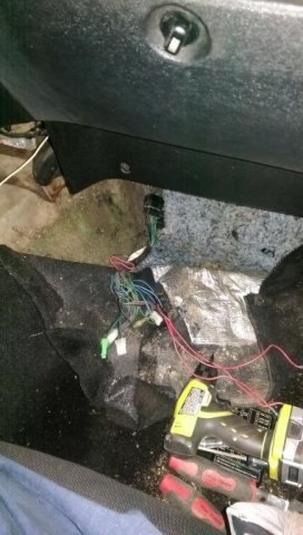

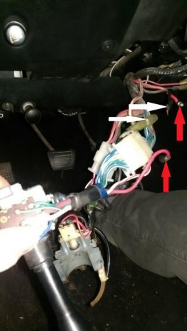

I was able to get the headlights working the other night.  After exposing the Combo Switch and removing it from the steering column, the red power wire and the black ground wire were very loose and they both disconnected as I pulled the switch off the column.  I took both switches off and sprayed the shit out of them with electrical cleaner.

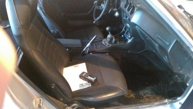

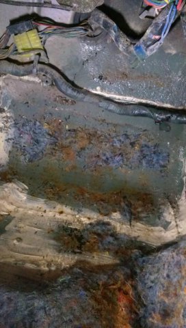

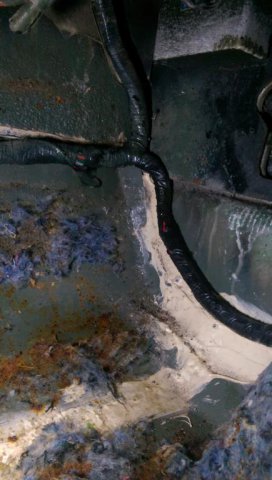

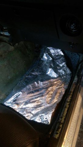

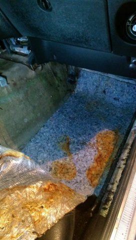

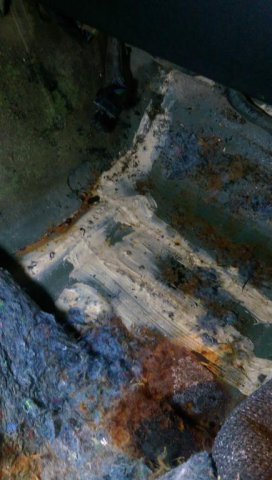

I also pulled back some carpet on the passenger side and removed the center console to see what I was working with. The floorboards may have been replaced, there is seam sealer/caulk where they meet the firewall that looks newish (not 40 years old).  I'm planning on taking out all carpet anyway, so we'll see how all that looks, and hopefully I can get rid of the smell.  I'm finding mouse poop everywhere...woof.  I'm seriously thinking about getting a Painless/EZwire kit for chassis.  These glass fuses are getting super hot and make me kind of nervous.
post-54021-0-10806700-1488380283_thumb.jpg post-54021-0-90207000-1488380284_thumb.jpg

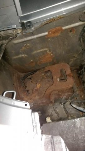

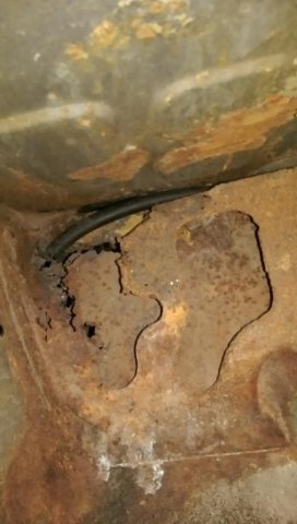

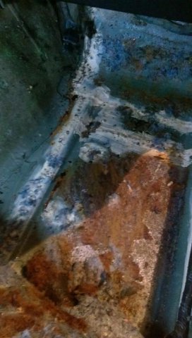

Annnnnd some pretty substantial corrosion under the battery tray.  Yesssss!
post-54021-0-45883600-1488380493_thumb.jpg post-54021-0-67563900-1488380494_thumb.jpg
I contacted a couple places that carry sheet metal for S30s, asking about this area.  One place gave me a somewhat positive response. "Zman" from ZSpecialties/DatsunStore replied and said he's actively looking for a local vendor to supply him with new meal for the apron area under the battery tray.  So I gave him my info and I guess I'm on a list now? In the mean time I'll probably just hold the battery down with a ratchet strap or something.
Post a pic. That could easily be original.
Share this post
Nevermind, yeah, someone's done some work there, and quite a lot of it by the looks of it. To their credit, it looks mostly decent, at least at the moment. I've certainly seen worse.

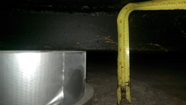

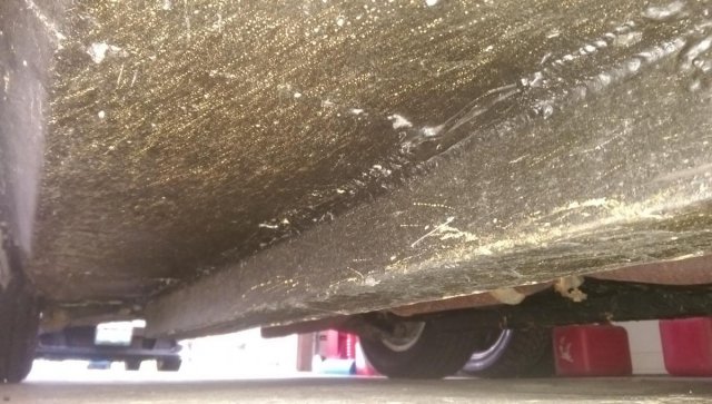

Not just you, those frame rails are big as hell. What were they thinking? I'm guessing 2.5" square tube, and it's already sitting 4" from the road. Looks like your car is stock height, so I think those will have to go.
Share this post
The floor pans feel very solid, but it appears that it's not coated very well. I'm still going to strip the interior and seal it up, probably with POR15. Everyone seems to like that stuff.
Question: If I use POR15, should I remove all the seam sealer or just go over it?
As for the frame rails. Holy crap. I'm thinking the easiest fix is to cut them down, or all the way out and replace them with the Bad Dog rails.
Another question: I have access to a two post lift, but, if I'm going to replace the frame rails, should the car be sitting on all 4 wheels so it's square/level?
Edited by MRGierut
Share this post
Lot's of people use POR15, but IMO it's overused. Lot's of people seem to use it when another product would be better suited. POR15 is a rust encapsulator, and it's very good at that. However, I've heard that it really doesn't stick to clean metal well. Personally, I would only use it for its intended purpose, which is rusty, pitted metal - think truck frame that has seen a few too many winters.
I'm not sure exactly what product to recommend you, as I haven't gotten to that point in my project, but I think an epoxy would be a good place to start.
Regarding you frame rails, I think any way you do it will take quite a bit of work. Looks like they're welded on pretty much the whole length. Are they connected to the rear subframe? I think most people, if they use tube, use 1x3 or something like that. And of course, there's Bad Dog rails, which are excellent, but your floor has been modified - factory 280Z floors aren't flat like that - so their 280Z rails won't fit. You might be able to use their 240Z rails, since 240Z floors are much flatter, but may require more fitment than usual. Bad Dog rails should add less weight than 1x3 tube, so there's that to consider as well. You could also cut down the ones you have, which would be a lot of cutting and welding, but might be less work than removing the rail entirely and fitting a new one. Of course, that option assumes that the rail was put in properly to begin with. It looks good at the moment IMO, but may not underneath the paint and sealer.
I'm not sure exactly how you should support the car for frame rail work, but these cars are quite flexy, so that would be worth thinking about.

I emailed John from Bad Dog Parts, sent him some pictures and he thinks the 240 rails might work, like rturbo said.  I'm not really in a hurry to cut out these perfectly good frame rails, so that will go on the back burner for a while.  I'll just concentrate getting the interior fixed.  The car runs and drives fine so I might as well drive it.  Plus we're planning on moving this spring and I would hate to be in the middle of something and have to move the car.

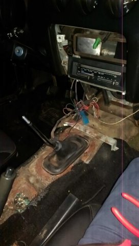

I always liked stock interiors in classic cars.  This one is just about there, except for the radio.  I know, I know.  The stock radio and speakers suck and they should be replaced.  After looking at prices for OEM radios on eBay, I figured I would just use an aftermarket unit.  Fortunately I found a guy who recently finished an S30 build and had a handful of OEM parts left over that he didn't need, which included the radio.  Offered him 100 bucks, and now it's on its way to my house.
I figured I can mount a new head unit remotely and replace the speakers.

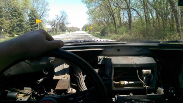

So, in my search for more mouse bodies I took out the dash to check the duct work, blower motor isn't working either. While I have it out, I'd like to freshen it up a bit. I'm trying to take the gauges out but since there was a dash cover/cap installed it's preventing the gauges from coming out and the glove box too. Does anybody know of there is a way to remove the gauges by taking them out the back?

I've been looking at this stupid ass dash cover for a couple days now, and although it is in great condition, it makes removing the gauges a pain in the ass, I don't think there is a way to remove the glove box or speedo and tach without damaging it.  While I have the whole dash sitting on my work bench I might do my future self a favor and tear it off and repair the original dash.  When my future self starts the LS swap, new gauges will be installed too.
Looks like a lot of people have good luck repairing their damaged dashboards, that is, if I don't **** it up really bad while removing the cover.

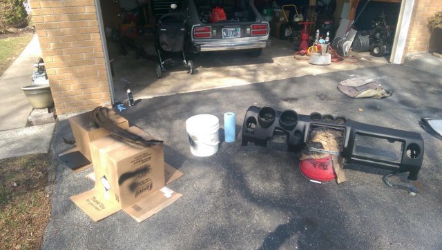

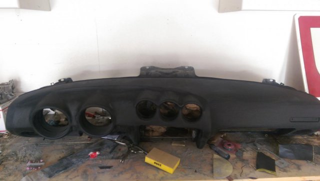

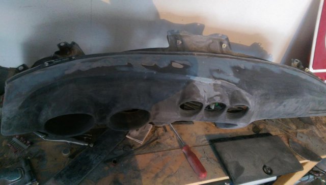

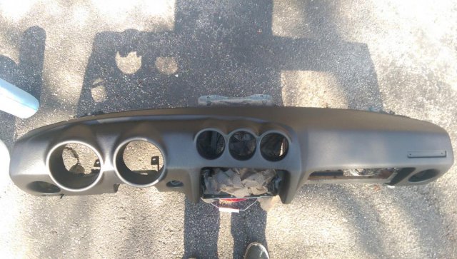

I have spent the last couple weekends tackling the dash.  I'm pretty happy with the result!
Dash cover removal
post-54021-0-16214200-1490022360_thumb.jpg post-54021-0-98255100-1490022364_thumb.jpg post-54021-0-61134700-1490022362_thumb.jpg

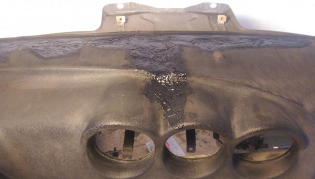

The damaged original dashboard, I was actually pleasantly surprised.  Only one crack and some of the vinyl stuck to the back of the dash cover and came off.
post-54021-0-14935600-1490022368_thumb.jpg post-54021-0-34561000-1490022609_thumb.jpg post-54021-0-02881400-1490022612_thumb.jpg post-54021-0-25802000-1490022615_thumb.jpg
I first started removing the bad foam and vinyl, then filled the exposed foam with plastic welding rod.  After the welding rod was sanded, I applied some filler to smooth everything out.  I followed this turtorial: https://youtu.be/_x8qtvG-Y8U.  You can find a plastic welding iron at Harbor Freight for $17.
I used Polyvance plastic welding rod, filler prep, padded dash filler, and flexible primer surfacer.  I didn't realize I bought primer surfacer, and not primer...Whatever, we'll see how it holds up.  I left the dash bolted to the frame while I did all of this so it stayed true.  I was worried that it might flex and lose it's shape if I took it off.  Also, if you use a DA sander, be careful.  Mine jumped quite a few times and caused some damage to more areas.
post-54021-0-73736300-1490022371_thumb.jpg post-54021-0-99936700-1490022373_thumb.jpg post-54021-0-79177200-1490022376_thumb.jpg
post-54021-0-27217600-1490022379_thumb.jpg post-54021-0-73212900-1490023084_thumb.jpg
3 coats of Duplicolor Truck Bed Armor with a couple scuff in between.
PRO-TIP:  Make sure the can is warm before you spray this stuff.  I let the cans sit in hot water for like 10 minutes right before I started spraying, it really helps with the splatter.

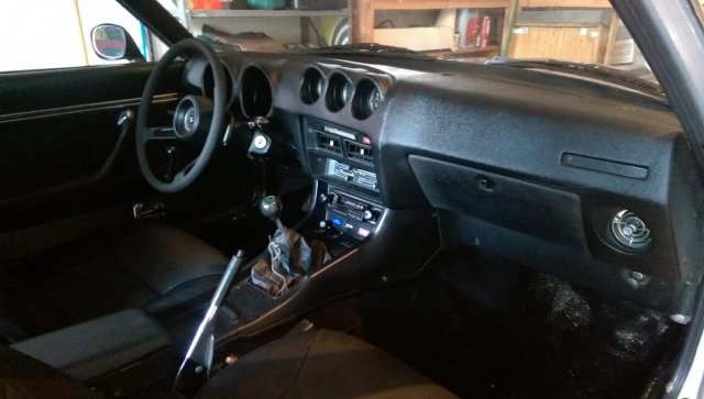

I also bought a cheap media receiver, which is just a regular car head unit minus the CD player.  I mounted it in the glove box.  Very simple, since there is no CD carrier, I just drilled and countersunk holes in the top of the plastic glove box, marked and drilled holes in the top of the receiver case and used countersunk sheet metal screws to fasten.
post-54021-0-65464100-1490023776_thumb.jpg post-54021-0-96731600-1490023770_thumb.jpg post-54021-0-33445100-1490023773_thumb.jpg post-54021-0-02254800-1490023775_thumb.jpg
I actually had to do this twice.  The first time I mounted it too far forward and the removable face from the media player was in contact with the door latch.

I've decided I'm going to hold off on re-sealing the floor pans because I'm probably going to replace them and the frame rails.  After further investigation, these floor boards are just patched.  On the driver's side, it looks like they just put a piece of sheet metal on top of the existing floor pans.  Furthermore, that big ass frame rail is only on the passenger side, the driver side frame rail appears to be original and slathered with under coating.  Yay!  Everything feels solid, and I really just want to drive it this summer.

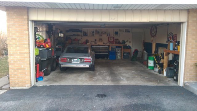

Welp,  Still waiting on the Speedhut gauges.
I ordered them on St. Patrick's Day and they just shipped on April 21st, I knew they were going to take a long time.  Speedhut was very good with staying in touch with me and are very accommodating.  They can add just about anything you want to their gauges, you just have to ask.  They offer a GPS Speedo with turn signals, high beam indicator, and programmable fuel gauge all in one gauge housing!  On the Tach I asked them to add two extra LEDs labeled "Brake" (red) and "Check Engine" (amber).  They should arrive this week!
Since the car has just been sitting in my garage for the past couple weeks, I felt that she has being neglected...
:cool:  :cool:  :cool:  :cool:  :cool:
Tow bolts on the driver's seat and tossed the steering wheel on...no problem.
