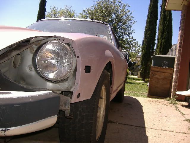

That wont work on a 280ZX though because the bucket is part of the whole fender!:D
Do you have aftermarket fenders? The fenders and buckets on my 83 280zx are seperate pieces just bolted together. Here's a pic I took during the bodywork process.
Posted Image
If they are aftermarket fenders, where did you find them? I would prefer them over this stock setup.
