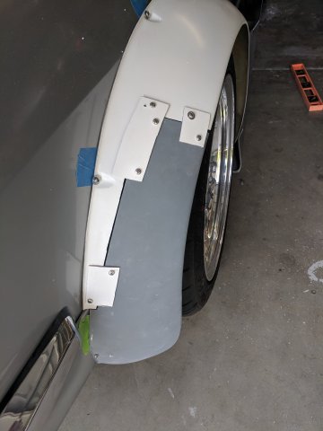

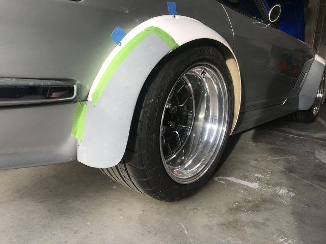

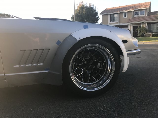

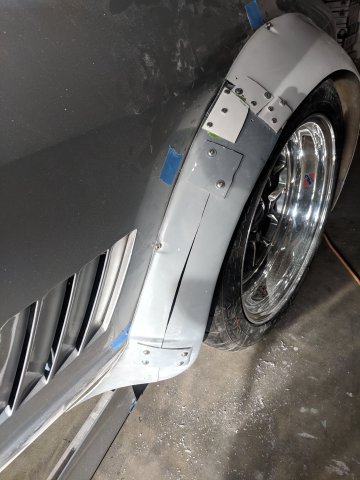

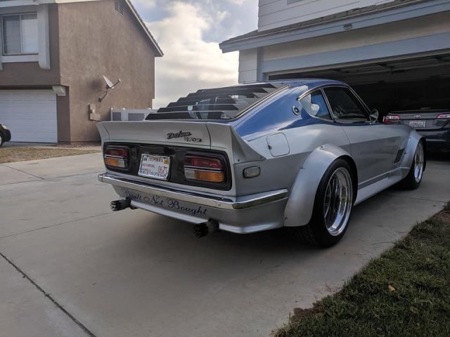

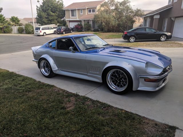

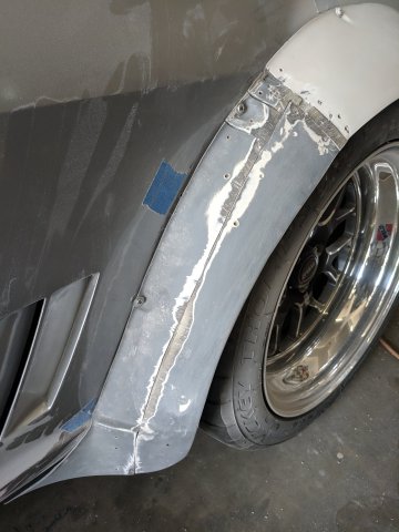

  1. Just thought I would post up the results of my quest for wide fender flares that suited my taste and budget. After a long search I thought I would go with Fiberglass Mafia Z-Speed Flares, but once I got them I decided I wanted more flare on the rear side and less on the front. I finally figured out if I purchase another set I could take the front part of the rear flares of the extra set and graft them onto the rear part of the front flares of the original set, and the front part of the front flares of the extra set and graft them onto the rear part of the rear flares of the original set. Confused yet? Hopefully the images will help. It took much more work than I originally expected, but am very happy with the results.
