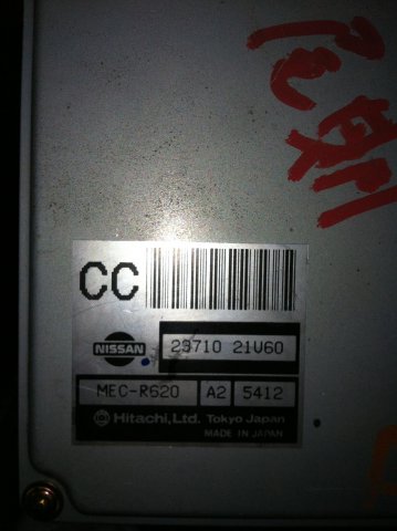

thanks pat do you know anything about the numbers on the ecu?

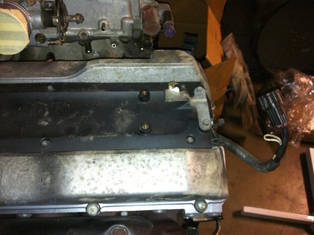

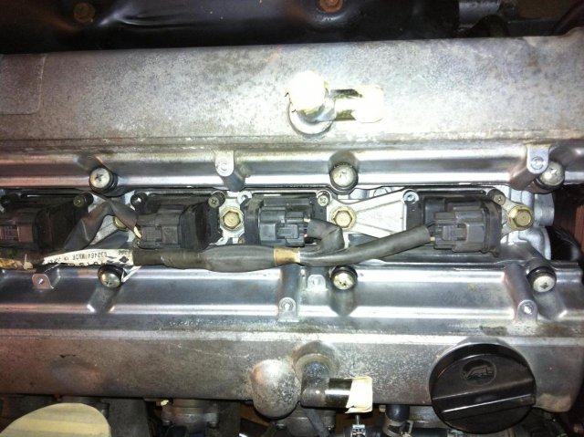

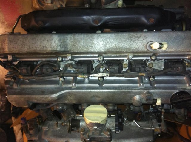

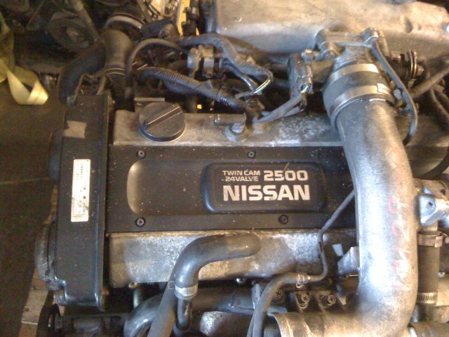

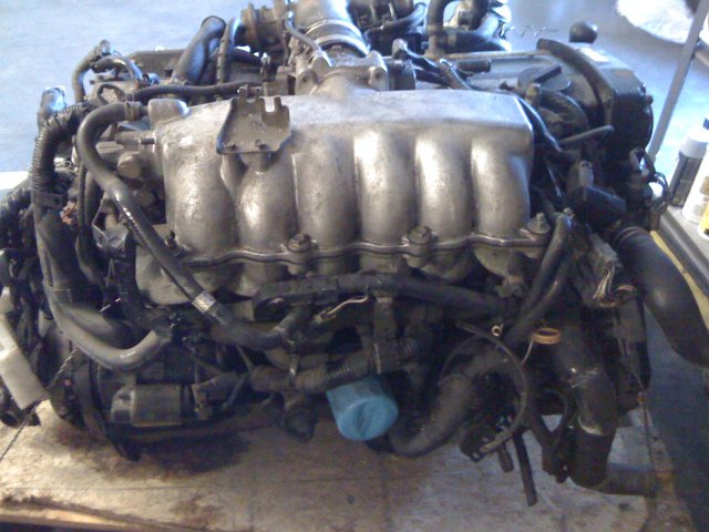

not sure dont have any of the wires hooked up they all are in a box this is what the top of the cover looks like. I thought that there was a difference in how the coils look as well, thats why i posted the first pics.

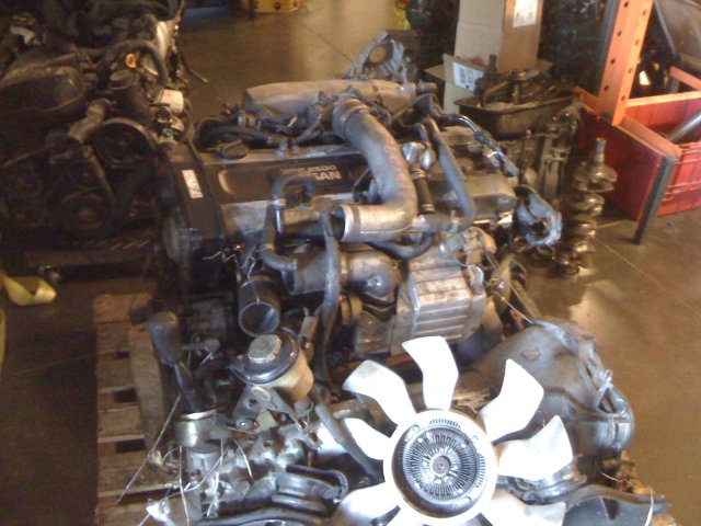

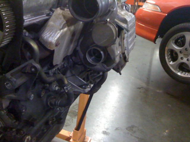

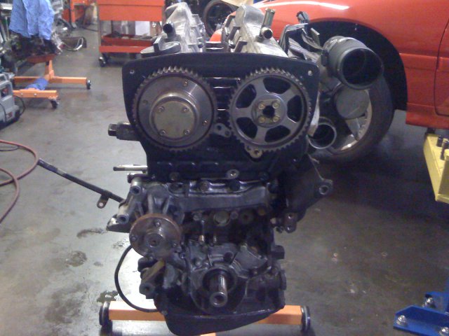

I was told that this is a series 2 rb25det motor, I know there is a difference between coil packs but im just learning mechanical things, Im more of a body fender guy. I was wondering if anyone can tell from these pictures I took, when I was taking these I noticed the second coil from the timining belt cover is facing the opposite way, same way with the one second from the other end, is it supposed to be like that, and the last thing that concerns me is the ecu, i searched the numbers from it and I get one place saying its a series one and another a series 2. Im asking cause i was going through a shop for all the motor work but recently lost trust in them, so Im just double checking I got what I paid them for.

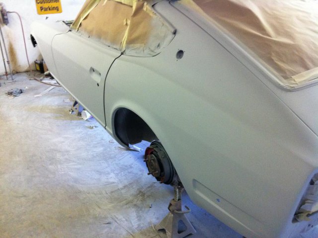

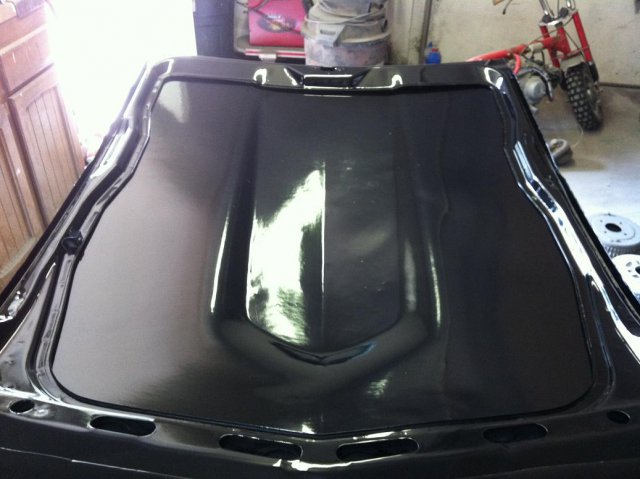

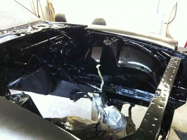

Its about time i update this post, got a oil pan from pat1, new fuel line kit, r200 rear end and mustach bar. As for the car itself finshed the body work installed new "custom" 1/8" steel frame rails. Put the car in primer and painted the engine bay and the underside of the hood black. I also have decided to do the rest of the swap at home with my dad instead of going through a shop to do it.

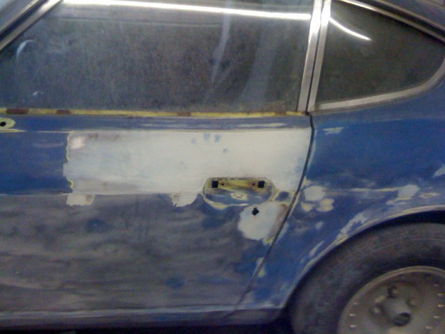

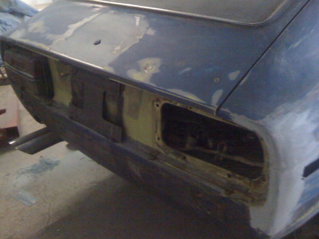

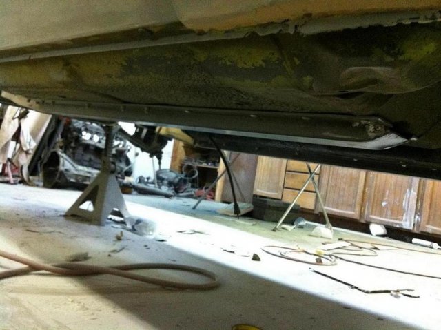

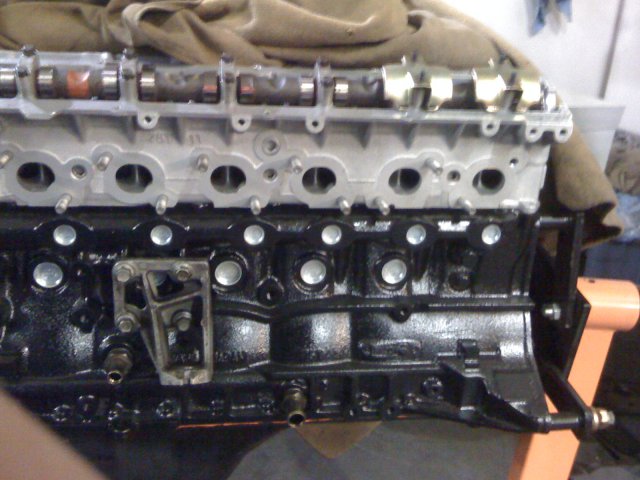

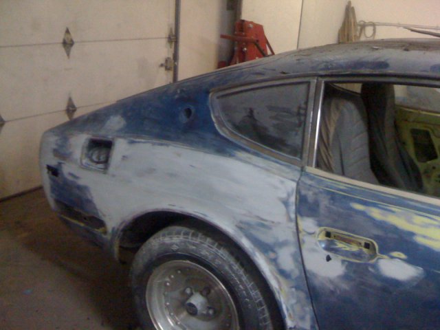

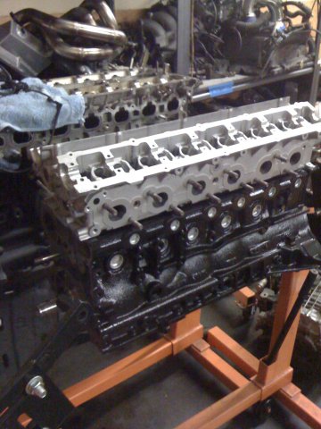

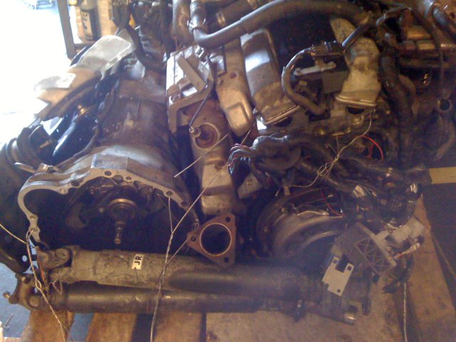

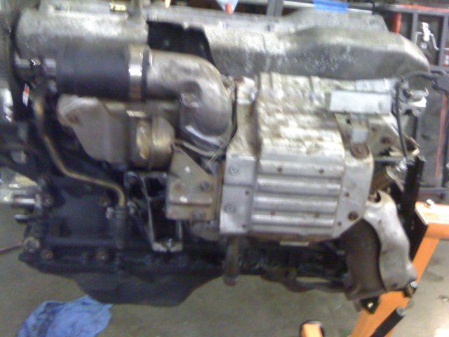

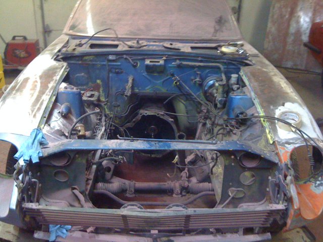

finally have a few picture updates of some progress made, havent had time to do much lately so things are moving a little slower than i would like. but here it goes. finaly replaced the rusted out battery tray, did some more body work, not shown but stripped the interior, got the motor set in started tearing it down, pulled the old motor tranny driveshaft and exhaused. the fresh motor is back from the machine shop and is being put back together, now i gotta finish the body work and clean up the engine bay, and a few other things that i know i am forgetting
