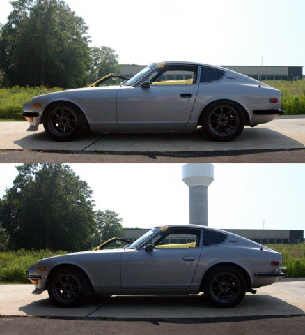

16x8 Rota RBR in "hyper black" with 10mm offset (4 29/32's inch backspacing). Note: this offset allows the max tire width on stock configured car much better than zero offset. Shown here test mounted with 245/45/16's ... the front would require a 5mm spacer to clear stock coil spring perch, the rears would fit with minimal fender clearance issues ... so I just ordered 225/50/16's that should fit PERFECTLY. The bottom photo is legit, the top is with future mod's photo shopped in Better quality pics will replace these once I get the correct tires permanently mounted. -

Standard lugs did the job (no tuner style required). Got them at Pep Boys for like $6/4 lugs. Top pic is actual Bottom is the way the car needs to look! -
