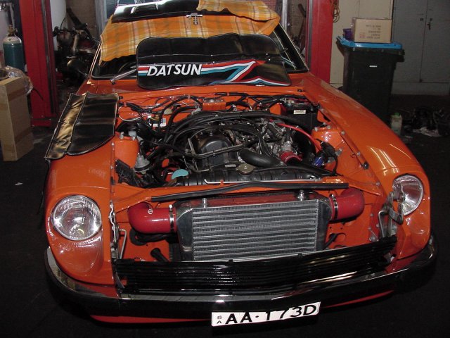

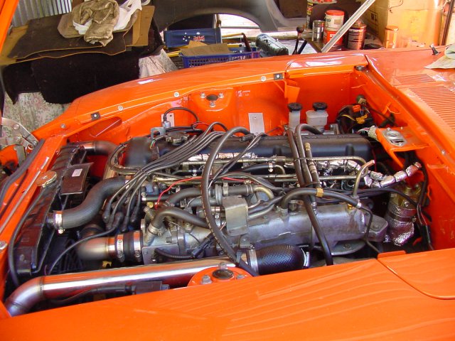

  5. My original setup had 2" SS piping and an AiResearch intercooler: The current setup uses 2.5" MS piping, and 450x300x76 FMIC: I too swapped the hot/cold side plumbing in my second version. The intercooler/plumbing changes saw an extra 3psi boost at the same WG duty-cycle, and allowed a 15kW increase via lower AIT's and the ability to lean out the mixture.
