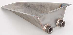

ok so you have me concerned about the stock tank not having any baffles. Heres what Im thinking will be the best/cheapest solution for me. I already have the stock tank off and cant weld so I have to have someone plug the stock return and all the vent tubes. I might as well take it to a radiator shop and have them boil it seal it and weld this guy on there. What do you guys think? is this a good permanent solution? I might as well do something I wont be changing next year. If any of you guys have experience with this setup how low will it hang and is it a huge eyesore? Is there any issues with legality having this thing hanging down from the stock tank?

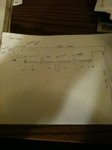

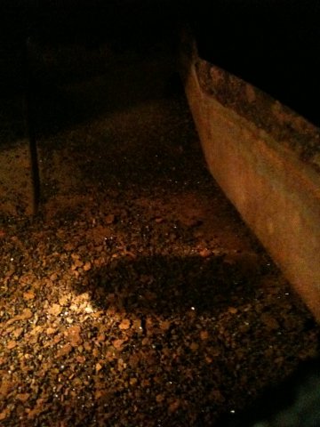

Hey guys Im building my fuel setup for my 1971 240z for my rb25det swap in progress. So far this is my plan. I plan to use a 3/8th right angle to -6an fitting. Connect that fitting to my high flow in-line fuel filter. From the filter im going to my bosch 044 pump. From pump to another high flow in-line fuel filter. From there im gonna connect to my 3/8th hardline to the engine bay. I plan to put the return line into the factory fuel outlet. How does this sound? Do I need the factory expansion tank? Im not quite sure what its for. If I do need the expansion tank what do I do with the Breather tube that went to the carbon canister? If I dont need it can I just weld up all the other bungs? My tank also has a lot of rust on the inside. Heres a pic of what I havent shaken out yet. I plan to clean it out I bough Eastwoods fuel tank clean kit.

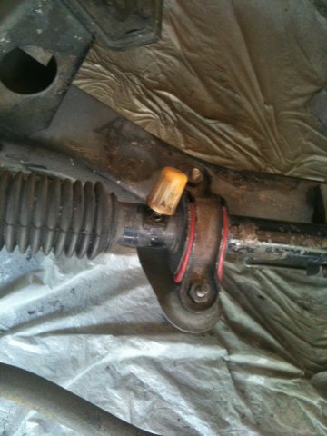

oops when prepping the engine bay I stepped on this grease fitting. Is this going to cause any issues in the future? -
