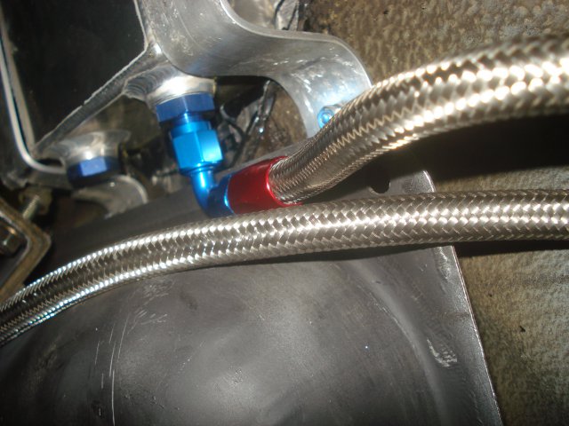

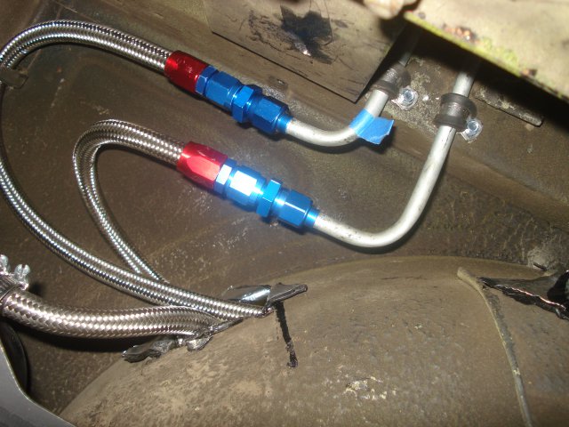

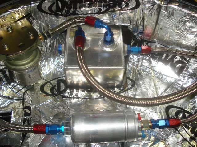

  2. Fuel system stage 4. (filter, pumps, and connections.) This Is where it gets tricky and Im going to try my best to explain it all as best as I can. Ok first thing first. I did all my connections with jegs stainless steel braided line. Here it is. http://www.jegs.com/i/JEGS/555/100912/10002/-1. I bought 10 feet and It was just enough if I could do It again Id get more because I still need to do the engine bay. I did Jegs straight fittings here. http://www.jegs.com/i/JEGS/555/100001/10002/-1 and here http://www.jegs.com/i/JEGS/555/100021/10002/-1. The first thing I connected was the overflow. It is a 90degree fitting that comes off the top of the ST that way any excess fuel in the ST will flow back into the fuel tank. The other end of that hose is attatched to the original feed line off the stock fuel tank. The next thing I connected was the line that connected the return line from the engine bay to the ST. I used straight hose ends on both end of this hose. Next up I connected the line from the bottom of the tank. I unsed a straight fitting on the bottom of the tank and a 90degree to connect it to the fuel filter. The fuel filter is a 40 micron in-line filter from Jegs. Here it is http://www.jegs.com/i/JEGS/555/15032/10002/-1. From the filter I connected the Carter fuel pump. It didnt have a -6 an fitting so I just clamped on the stainless line. Heres the Carter pump. http://www.jegs.com/i/Carter/180/P4070/10002/-1. From the Carter pump I connected it to the top of the ST using a 90degree hose end. The last thing I connected was the outlet from the ST to the Bosch fuel pump. The Bosch pump is a 044 inline pump. I bought it on amazon.com. The inlet of the pump needs an adapter. http://www.summitracing.com/parts/FRA-460618/ and an outlet adapter http://www.summitracing.com/parts/RUS-670510/. From the outlet of the Bosch we go to the feed hardline we installed in fuel system stage 1. This is all very hard to explain. Maybe so pictures would help. This one explains most of it. Here are a few more shots of the setup. Ok so you can tell I still need to mount the Bosch pump, Put some grommets in where the fuel lines come in. I also want to tidy up the lines a bit. I also need to wire up the pumps and do the filter in the engine bay as well as the Fuel pressure regulator. That is all coming in a future writeup. Lets add it up. 10' stainless braided hose. $40.00 qty 7 an straight hose ends $35.00 qty 4 an 90degree hose ends. $42.00 JEGS 40 micron inline filter $30.00 Carter fuel pump. $70.00 Bosch 044 fuel pump. $180.00 Bosch inlet adapter. $4.00 Bosch outlet adapter. $5.00 Total for filter, pumps and connections. $406.00 Total so far. $1191.00

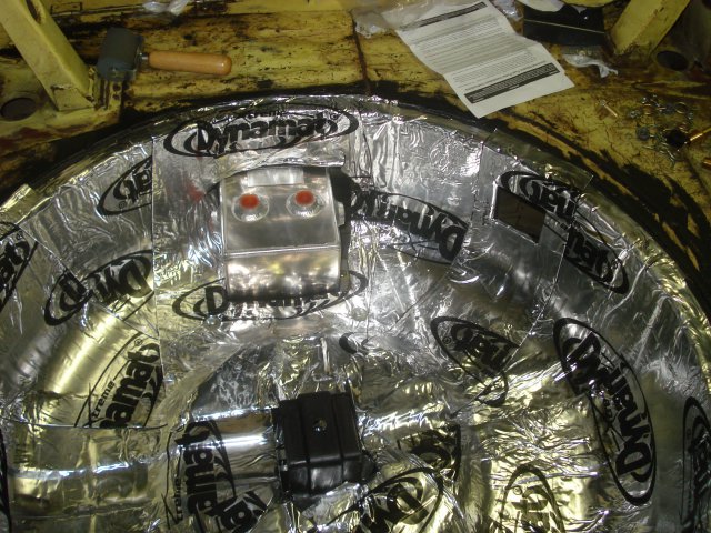

  3. Pat1 thanks again for the kind words. So far its been a real pain making this surge tank work but I wont have to do it again I hope. Goodoldjam thanks again for all your help. Im glad you found this page because you have been a huge help so far. Trying to get a little more work done tonight. I spend most of my time looking at everything and laying it out in my head. Do you guys think I should mount the 1st pump down to the right of the surge tank? Is the wheel well to far away? The instuctions say to mount it close to the fuel tank and no more than 24" above the tank. I dont think its 24" above it but in the wheel well it will be more than 24" away. Let me know what you think.

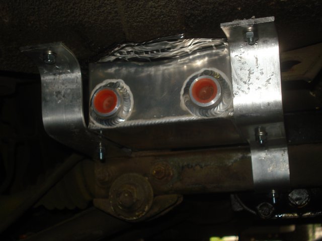

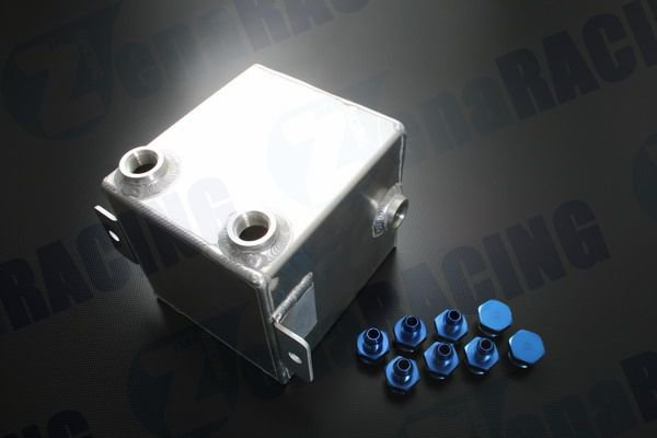

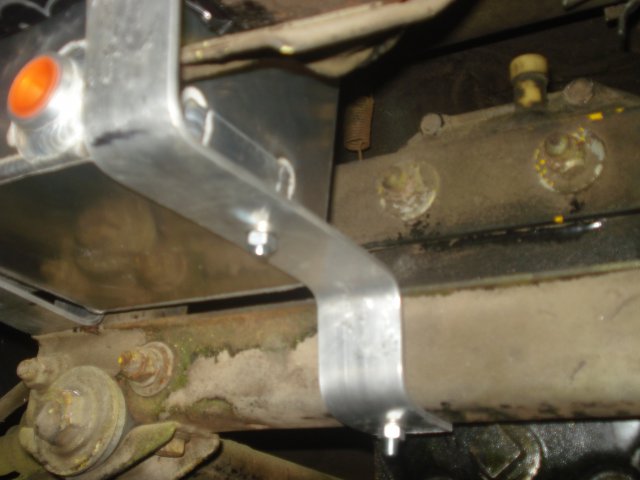

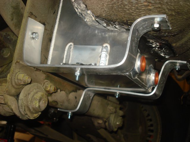

  4. Fuel system. Stage 3 ( the surge tank ) Ok I have been asked a few times now about this surge tank so here is the writeup on how I mounted it and a little bit of info on the idea of a surge tank. As most of you reading know the stock 240z tank is not baffled. So what that means is under hard cornering with a low fuel level the fuel can slosh away from the feed line. That in effect leaves the the fuel system dry which can in turn have harmful effects on the motor. The idea of a surge tank is this. You have a low pressure pump coming from the motor feeding and filling the surge tank. Then there is a 2nd pump from the surge tank to the engine. The return fuel from the engine also goes to the surge tank. This means that even if the feed line temporary goes dry on hard launches or long sweeping turns the motor is still pulling fuel from the surge tank. This prevents running the fuel system dry. ( any more questions or if further explanation is needed please let me know. ) This particular writeup is on mounting the surge tank. Hooking it up will be covered in an upcoming chapter. Step one. Find a location for your surge tank. This can be quite difficult depending on how big your tank is. ( Surge tank will be appreviated ST from now on. ) I was unable to find anyone in the USA that sold STs. I bought mine off of ebay. Just search "fuel surge tank" and you should find some results. Mine is made by autobahn 88 and was sold through Zenaracing. Heres a link http://cgi.ebay.com/ebaymotors/Fuel-Surge-Tank-Aluminum-2-Litre-Swirl-Pot-System-_W0QQcmdZViewItemQQhashZitem45f16c9fb1QQitemZ300403171249QQptZMotorsQ5fCarQ5fTruckQ5fPartsQ5fAccessories. Its a 2 liter or about half a gallon. Heres a pic for all of you who look at this years from now and the link doesnt work. .. Now came the hard part. Finding a location. Ideally most people put it under the car. I tried to think of a good way to make this work but with 2 pumps a fiter and a surge tank I just couldnt find a way to make it work. Or maybe Im just lazy. This car for me is not a daily driver. I chose to cut my wheel well and put my fuel setup in it. I will put a alluminum plate over the top of the wheel well when im done with the fuel setup. Step two. This is going to depend on where you choose to mount your surge tank but for me step 2 was prepping the wheel well. First I used my trusty Pre to clean up the well and my wire wheel to get all the tough spots. I even had the help of my lovely lady friend for this part. Heres a pic. Then I rust encapsulated the wheel well. I then used my cutting wheel to notch out a square where I planned to have all my lines come through. Be carefull and mind where your fuel tank will be. I also notched out a square for my ST. Next I put dynamat thoughout the entire wheel well. ( fuel pumps are noisy.) I also used the dynamat to make sure there werent any sharp corners where my lines and ST are coming thru. http://www.abt.com/product/11695/Dynamat-10455.html . Next up mounting that dang ST. As I stated in a thread earlier I am in no way a mechanic so I cant weld and I just kind of make it up as I go. I set the St where I though it should go and started to make some alluminum brackets for it. I got the alluminum from home depot. I believe its 1.5" wide and 1/8th thick it came in an 8ft section. I bend the brackets using a wooden block and a 3lb sledge. A vice would have made life easier. Kind of just made it up as I went along. Heres what I came up with. Ok I think you get the idea. I bolted it all down and Im good to go. Oh and I also put a little piece of dynamat betweent the ST and the brackets to keep vibration down. Lets add it up. Surge tank. $100.00 Dynamat. $200.00 Optional and plenty left for the lid. Alluminum for brackets. $20.00 Mounting the ST. $320.00 Total so far. $785.00

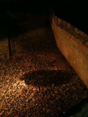

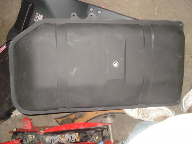

  6. Fuel system. Stage 2 ( The fuel tank.) Step one. Remove sending unit and check tank for rust. Mine was really bad inside. Heres a pic of the rust. If your tank is rusty were gonna take care of that in step 2. First we need to get the tank ready. I am running a surge tank in my setup. If you arent planning on running a surge tank you may want to get a baffled tank. First thing I did was have a friend cut off and weld shut the stock fuel return line and all the lines that went to the expansion tank except for the 5/8th on the top of the tank at the rear of the car. Next I used a tap where the stock drain plug was for my new feed line. I used a 3/8NPT and it was hard to find. I got mine here for pretty cheap. http://www.harborfreight.com/6-piece-pipe-tap-die-set-91395.html. Make sure to use cutting oil and frequently spin the tap in reverse to clear the threads. I then got a 3/8th to -6an 90degree adapter for my newly tapped hole. http://www.jegs.com/i/JEGS/555/100146/10002/-1. Step two. If your tank is rusty and your a DIY guy. I bought a tank sealer kit from eastwood. http://www.eastwood.com/ew-gas-tank-sealer-kits-for-cars.html It was a huge pain in the butt. The cleaning process went great for me. Youll need muratic acid and 2qts of acetone in addition to the kit. Clean with metal wash, muratic acid, fast etch, and acetone. Lots of shaking my arms still hurt. Then seal with tank sealer. I had trouble here because after I finished sealing I wasnt able to get the excess out. Plus my tank had a baffle so It filled that in in some spots. I spent all day with a razor on a stick and a hack saw blade on a stick reopening it. Then I used the supplied tank tone on the tank and then quickly changed it to flat black. I didnt like the silver. Here is a pic of the tank flat black. Heres a pic with the tap in. Heres a pic of the damage I did while using a jack to hold the tank up while I attatched the filler neck:( comments. If I had it all to do over again I would have had a radiator shop boil and seal the tank professionally. Lets add it up Tap and die kit. $15.00 cutting oil $5.00 -6 to 3/8npt 90degree $10.00 welding shut plugs $? friend did it ( thanks Doug.) Eastwood kit $50.00 Acetone $15.00 muratic acid $15.00 Total for tank prep $110.00 Total so far. $465.00

  14. Yesterday was a disaster. I was attempting to clean and seal my tank using my Eastwood tank sealer kit. The cleaning went pretty well allthough it was very time consuming. Then came the sealing. Everything went ok. I spun it and let it sit as per the instructions. Then I ran into a problem. After I had the tank all coated I tried to dump out the excess. I got some out but every output on my tank had a small lip. So now I had a few puddles. I tried to keep spinning it over the next few hours to avoid puddles but I can look in and see a few. What should I do? At this point do I just throw this tank away? Should I use it and hope for the best? Worst case scenario my fuel filter would catch anything that came off correct?

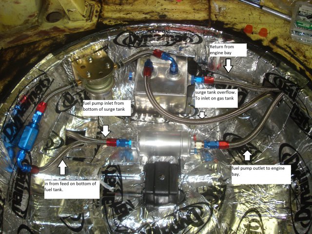

  16. help needed please. What fittings do I need for the bosch 044. Are the ones below correct? http://www.summitracing.com/parts/RUS-670510/ and http://www.summitracing.com/parts/FRA-460618/ Trying to get all this stuff for friday. Please help quickly.

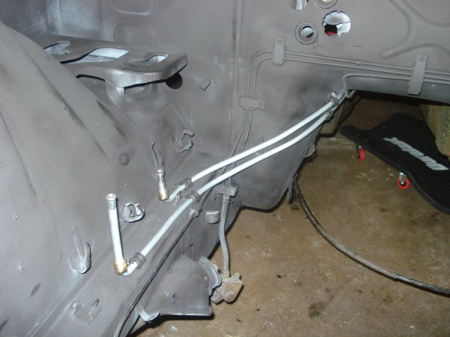

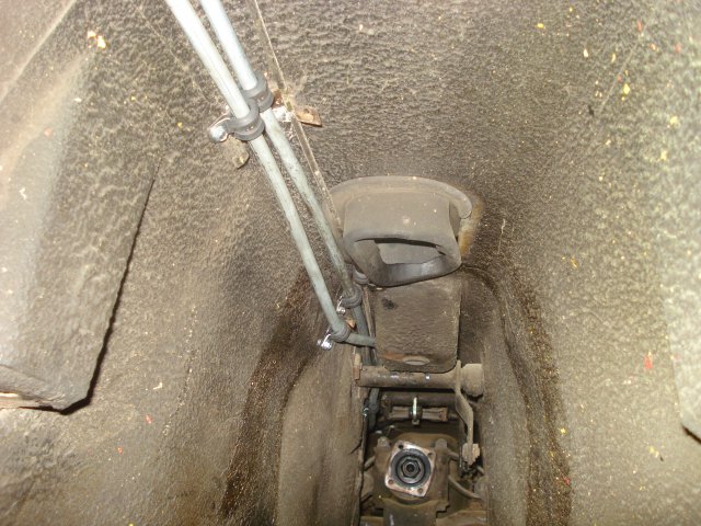

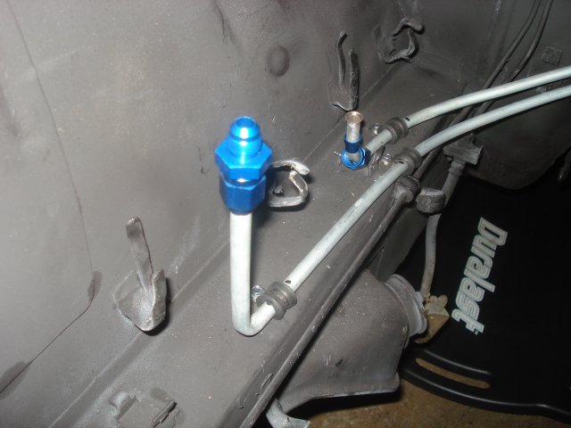

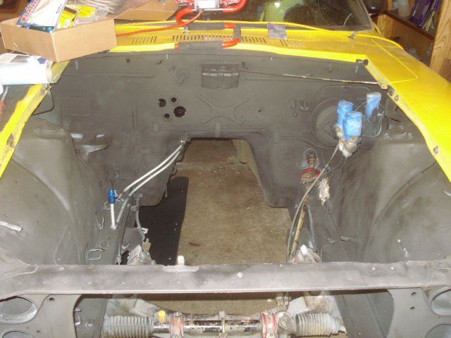

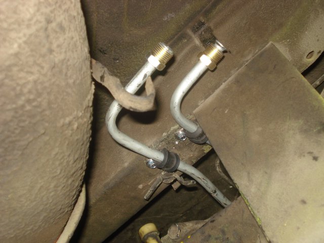

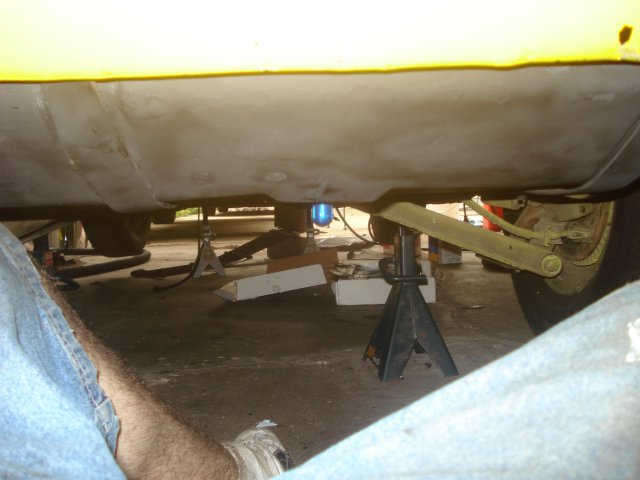

  17. update, I have finished running all the hardlines. I got 3/8th tubing from jegs, I removed the stock lines and ran new lines where they were. It was a lot harder than I thought it would be. Being under a car that long was not fun. I got a flaring tool and double flared all the ends of the tubing. Heres some pics. This is the rear end of the car. where the lines will go to and from the tank. Here they are in the tunnel under the car. Heres the engine bay I hope it looks good so far. let me know what you think.
  18. Thanks Goodoldjam, I will definately try to get it all under the car. If it seems impossible Im just gonna put it in the spare tire well. Thanks for the heads up on the filter placement. I didnt know that it should be under the hood.

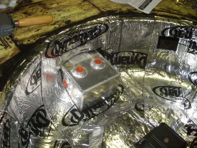

  19. Ok this could be a really stupid idea. Please tell me if it is. I was trying to figure out where to put all this stuff (ie surge tank 2 pumps 2 filters and a bunch of hoses) and then I thought hmm. What If I put it all in the spare tire well and then bolt an aluminum plate over the top of it. I'd dynamat the plate and the well to keep noise down and if I need to get to any of the components I'd just unbolt the top plate. Please let me know if this is stupid. Also if this isnt stupid should I mount the low pressure pump by the tank so it doesn't have to pull as far.

  22. Ok. I'll keep the vapor tank and get a vented cap. Thanks for the advice. Ordered the surge tank. Still no luck on the low pressure pump. Found a Carter 4070 but it only has 1/4" not fitting on it. I'd prefer something with -6an. And I still have the hardest challenge. Finding a place for all this stuff.
  23. Thanks. So as long as the rb25det has it's matched trans it sounds like I'll be fine.
  24. ok Im not loving the look of a sump. I think ill just do a surge tank. I found this online. Im ordering this tomorrow and just curious what is a good/ cheap low pressure pump. I have read about a few carter pumps but no model #s. I am running a bosch 044 for my high pressure pump. Thanks again James
