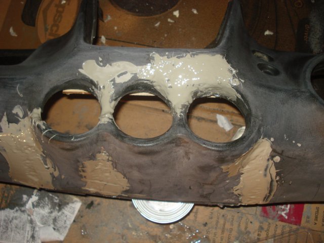

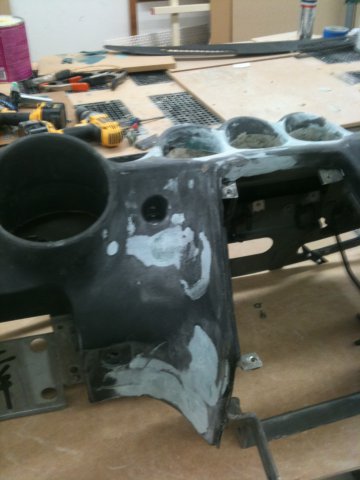

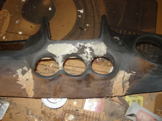

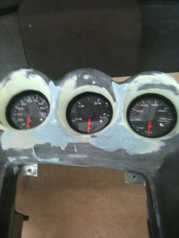

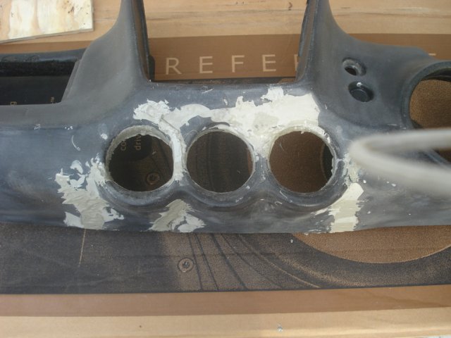

Minor update. A bit of work on the dash. Used some fiberglass bondo to fill the and smooth some of the spots on the dash. Used the bondo to fill in and shape the area where the gauges are going. Here are a couple of crappy iphone pics of the progress.

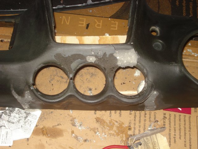

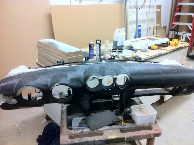

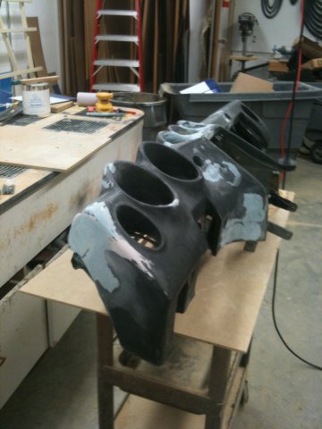

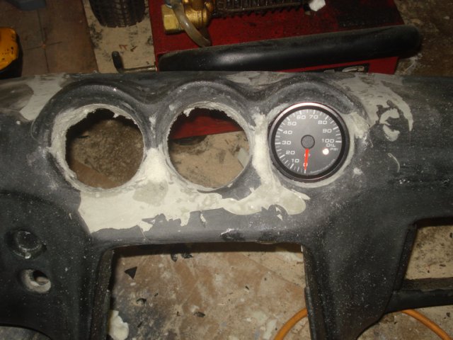

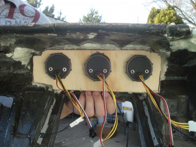

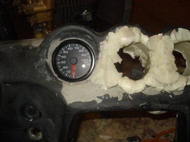

Update, Modified my original plan. Shaved the foam way down. Decided to use a board to mount the guages. This way they all stay pretty level and equal depth. Heres a few updated pics. Thats about it.

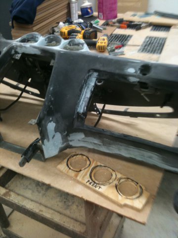

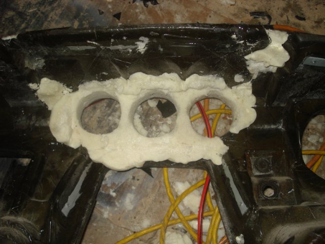

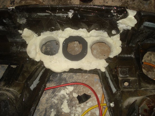

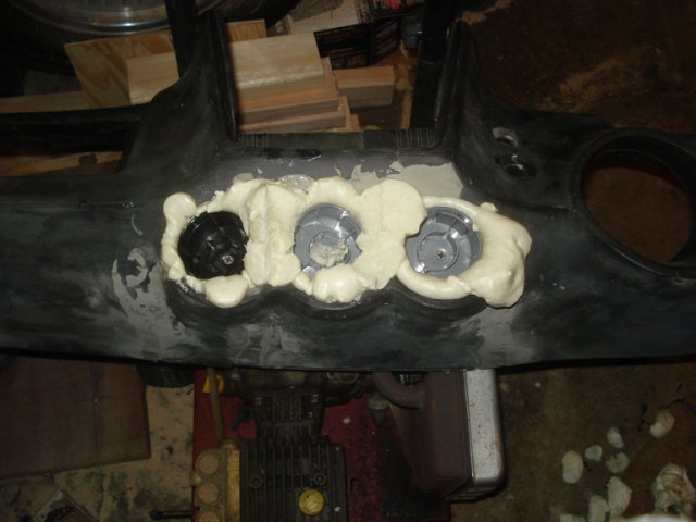

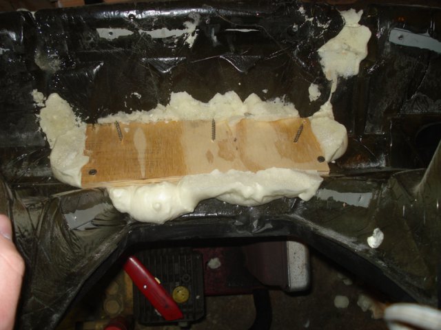

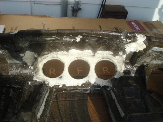

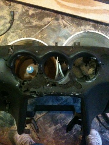

update Ok still working on the dash. Got a little work done today. Like I said in an earlier post I want a better gauge solution with a good fit and finish. This meant eliminating the cups I was using before and eliminating the gaps that I get above and below the dash when mounted at the preffered depth. Here is the beginning of my solution. 1st I screwed a board behind the gauges to give me a flat surface. Then I screwed 3 spray paint caps to the board. Then I filled all the gaps with great stuff. Here is the back. Then I began sanding them to the appropriate size. More Here is the back. I plan to mount the gauges by securing my gauge plates to the new foam. Like shown. I need to sand it all back a bit because its way to deep. Then Im gonna sand it out about 1/4 inch so the fiberglass doesnt make it too big for the gauge to fit. Let me know what you guys think. I havent heard from you guys in a while and some encouragement would help keep me motivated.

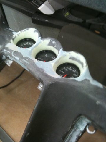

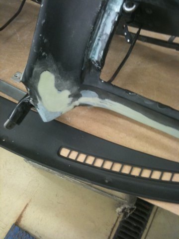

update: Have applied 1st coat of sem bumper repair. Happy with the results. Sanded that down. Applied 2nd coat. Thats it for now.

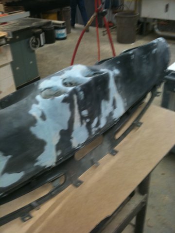

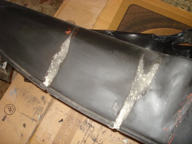

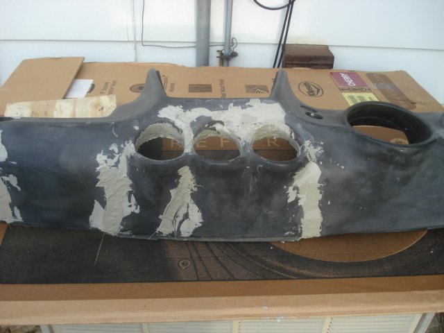

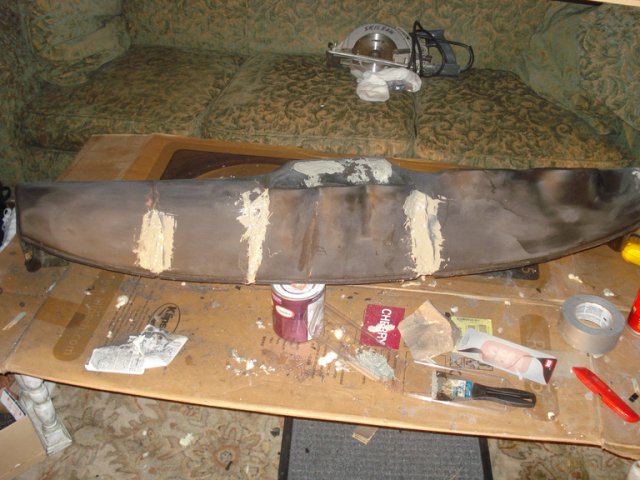

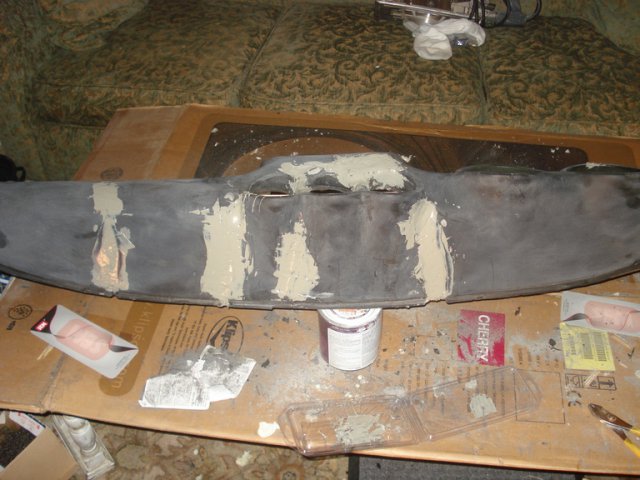

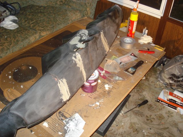

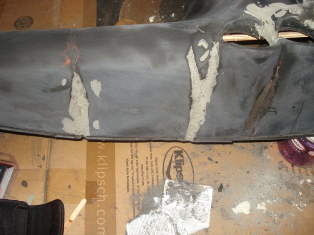

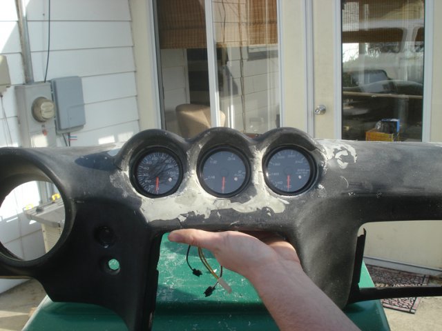

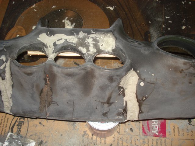

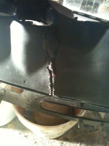

Update: Worked on the dash a little more. The good news is it is one piece again. I used some wood to screw it back into place. The I used 60 second adhesive that I got from autozone. I glued it in a few spots underneath to get it to stay in place. Now Im in the process of rebuilding it. I am following the cheap dash repair alternative thread. So far I have filled some of the gaps with great stuff and sanded it down. It worked better than I had expected. I got my camera back and took some pics. So now I have to find some SEM Bumper repair. I plan to fiberglass the entire dash and make mounting and servicing my gauges easier. More Later.

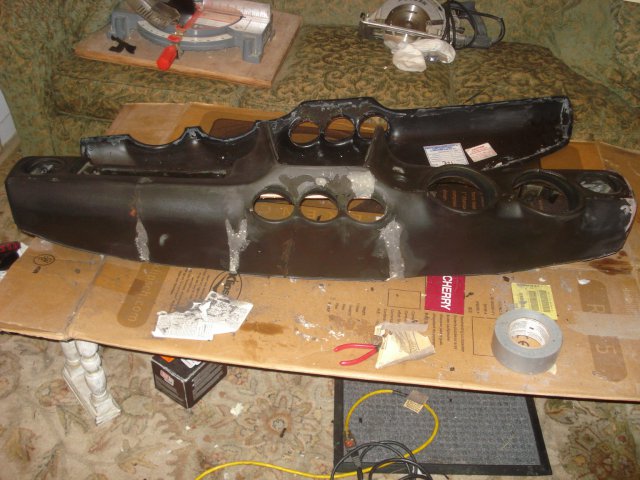

Dash isnt looking so good. When I removed the dash cap it was worse under there than I thought. To make mattters worse when I removed the dash foam from the metal frame it broke in the center over the 3 humps. Im gonna give it a little bit of work and see what I can do but I'll probably just do an alluminum dash.

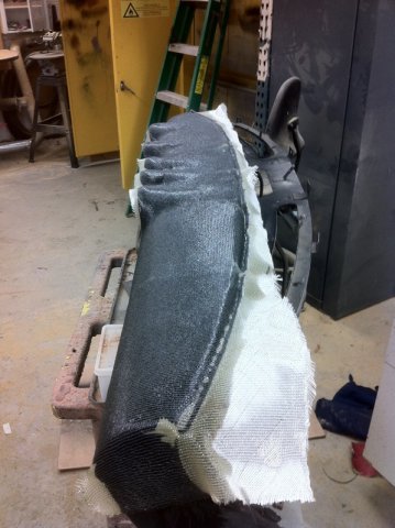

Considering fiberglassing the dash. I'm unhappy with it so far. Debating replacing the master brake vac. Getting ready to order the motor. Got my bov and waiting on my rb25det timing kit.

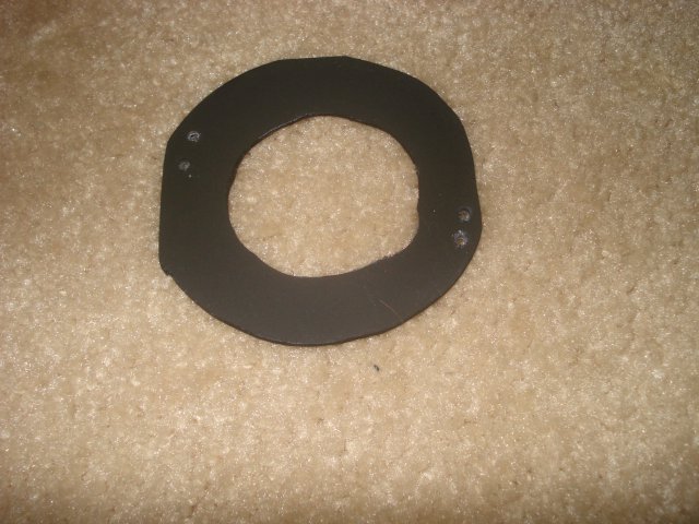

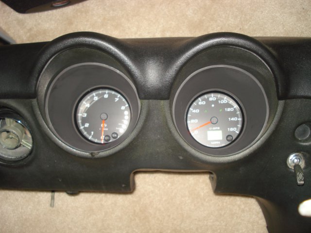

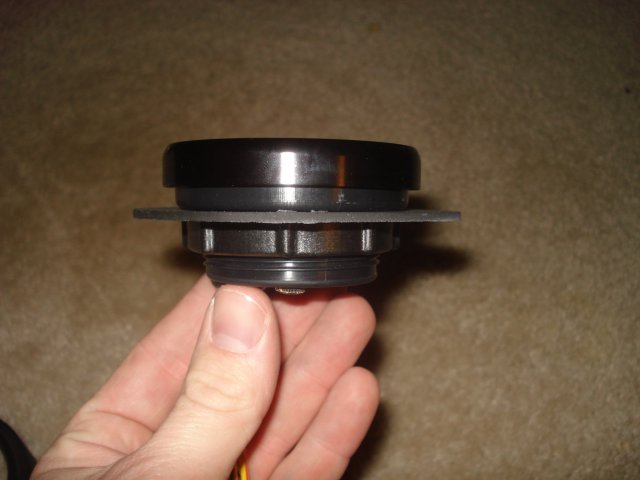

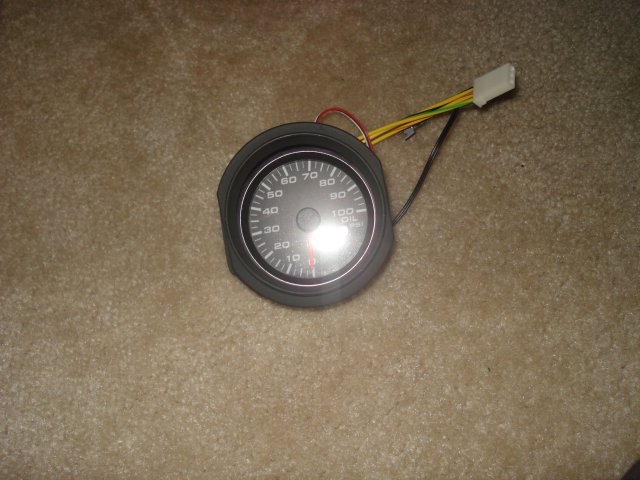

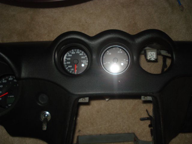

update: gauges in cups and dash So far I have gotten 2 of the cluster gauges mounted. 1st I had to make a trim ring to mount the gauge. I used some abs plastic and cut it to fit the gauge cup and to center the gauge in the plastic. Heres a pic. and another from the side. then I sandwiched that between the cup and the bezel. used the stock hardware to reinstall it. here they are from the front and also mounted the tach and speedo. As you can see my dash is ugly. I am gonna pretty this all up next year when I fix the dash. Planning on using some bondo to fill the gaps in the gauge cups and make everything fit a bit more snug. Well Im almost done with the gauges for now. I have to finish the last pod that is different from the rest. I also have to find a place to mount my voltage meter.
