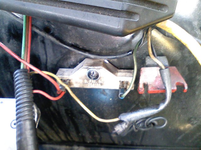

  12. Found what I'm looking for- ignition resistor ballast. Hopefully this will be the fix to my problem.
  13. Well I had this issue before where my car would just instantly die. It was a loose wire before in the ignition system. Well it's doing it again and I think I may have found the culprit. The positive post on this part seems to wiggle excessively. Also it gets REALLY hot and I swear I saw smoke coming out of it after cleaning it with some electric parts spray. What is this part? By the way I have a Mallory ignition setup. The previous owner installed it so I'm not too well versed in it. D. Pat. No. 254186
