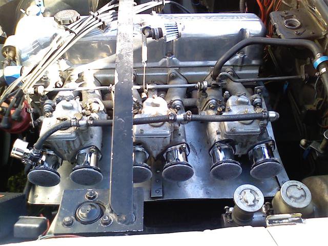

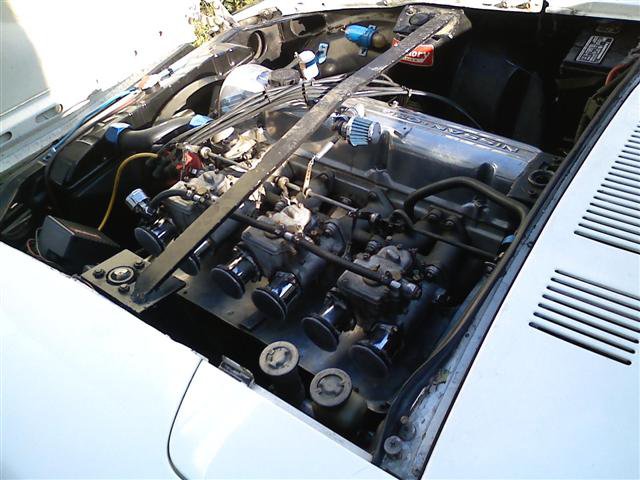

Problem solved! (Night) + (Pre-workout energy drink) x (frustration) = not a thorough enough inspection of all wires. I missed one little wire underneath the ProMaster ignition- the positive lead to the ballast resistor. I felt like such a dope (yet relieved) after hooking that little wire back and the car firing up so beautifully. Thank you random Z guy whom stopped and helped me test fuel pressure throughout my entire system at 11 at night while I was stranded on the side of the road! -
Well I finally got the carbs synched and running great- the car just died on me! Info on the car: L24 Tripple Weber 45 DCOE - 36mm chockes - 145 mains - 195 air Mallory Unilite/ pro master Electric Fuel Pump FPR set at 3.5 psi ____________________________ I was driving and the car just died. I pulled over and tried cranking it. It turned over and didn't sound like any battery problems. I gassed it and then it would rev up really quickly and then die. I could not get it to idle at all- just rev and then die. I checked the fuel pressure and it read 3-4 psi. I disconnected the hose after the electric fuel pump to make sure fuel was coming out while cranking it and it did just fine (looks to not be a clogged fuel line or filter) HELP!
