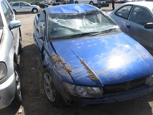

EvilC - That's very encouraging to someone like me in the very early stages, thanks. Just thought I would past on details of my LS1 cost. In January I purchased an 04 built 80,000klm (50,000mls) wreck for $5200AUS ($4836US). I spent no more than 40 hours, on and off over a few weeks, to strip the car of undamaged bits. Last Sunday night 17 items went for $2250 ($2093US) on eBay. As a result I end up with motor, MM6, drive-by-wire loom, prop shaft, 3.46 LSD diff and 4 CVs, air conditioner, brake and clutch master cylinders and even the pedals, all of which I hope to fit to my Z, all for $2950AUS ($2743US). -

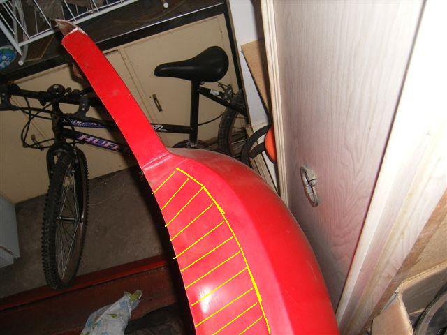

Dan - Did those other kits have a lip that was removed after fitting or were they supplied with just a straight edge? If they weren't supplied with a lip them perhaps the 250 GTO kit has a unique fitting technique, if they were supplied with a lip then the fitting technique could be universal. I would be good to get a definitive answer from John Washington.
Dan - If you are going to make comments based on your experience, knowledge and commonsense please feel free to 'butt in' whenever you like. Thanks, that all looks very practical. I wonder if it is possible that someone in the States could contact John Washington and ask him how the kits were designed to be fitted around the doors? It's a bit difficult to figure out for those of us who buy secondhand uncompleted kits. Although we haven't paid directly for that information the more people who see completed kits the more chance there is to expand the market for kits.

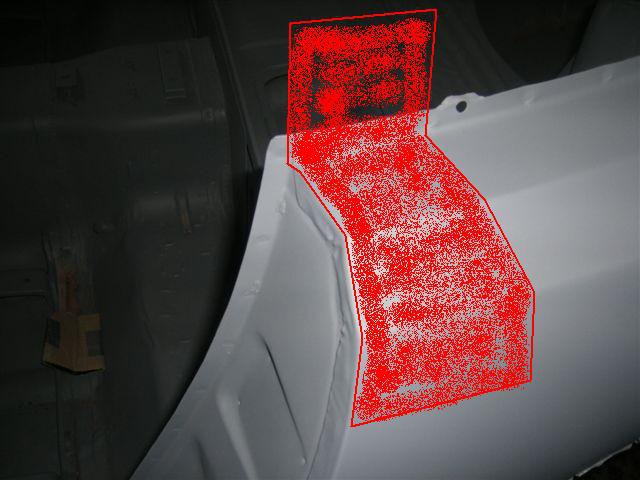

Could you please explain this process. I had assumed (dangerous thing to do I know) that the foam used would be an expanding type applied to the cavity after the rear panel was fitted. Thanks. Regarding the valences under the doors, see post #97+, they may assist.

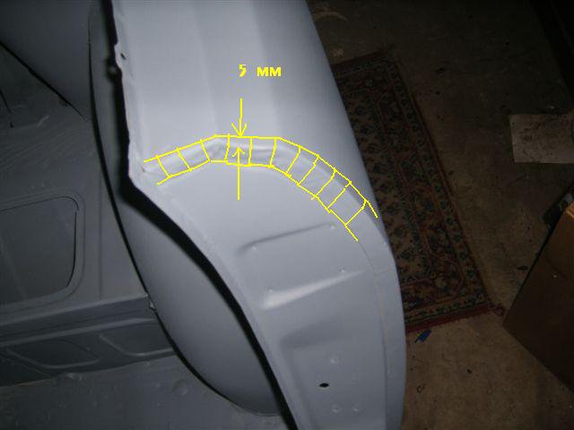

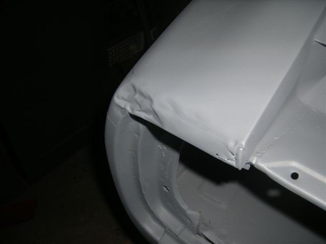

I am also interested in how people attached the rear panel at the door openings. As you can see from one photo my panel presently includes a significant amount of fibreglass representing the door opening. It appears to me I need to remove the hatched area to make it all work - unlike the bloody idiot* who previously owned this car and tried to modify the entire door opening with a 10lb hammer to make the panel fit and allow the door to close. I have been advised I need to lightly hammer the edge of the opening back about 5mm and attach the trimmed fibreglass panel. This look easier said than done as there would be a fair bit of strength in that folded edge. My shell has also been hammered above the rear taillights to enable the panel to move forward and attach to the door opening but that may not be necessary if the 5mm modification is done. Alternatively, I have also been advised to trim the fibreglass right back until there is no lip into the door opening, negating the issue of door clearance completely. I guess you run the risk of having the edge completely made of body filler and I wonder how durable that would be. I would appreciate comments from experienced players on this one. * I really shouldn't have called him a bloody idiot when a 'total bloody idiot' would be more appropriate. When he dismantled the car he threw all the bolts and nuts into one bucket and then lost the bucket!
