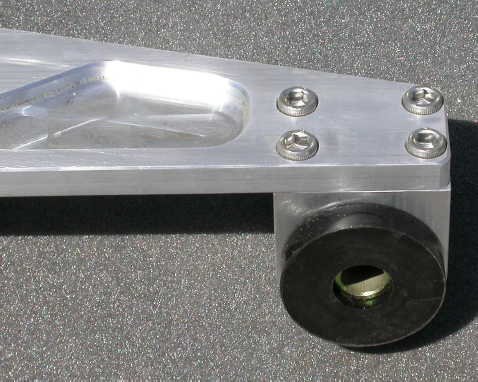

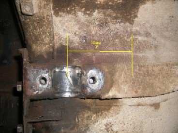

I am attempting to install a GM diff in a 240Z and require a mustache bar to suit. As a starting point I would like to utilise the bush mounts from a non-OEM bar (see photo) and then make my own cross piece to suit the GM diff. Unfortunately I have been unable to purchase the bush mounts by themselves. Does anyone know of a mustache bar supplier who might be willing to sell just the mounts?

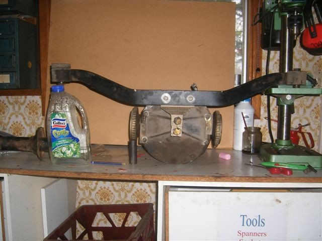

Here are some photos of a simple mock-up rear mounting bracket - I figure I'll will probably need something stronger than cardboard for the real thing! Although the standard moustache bar is shown here I will have to construct a new one that run basically straight between the two attachment points of the standard bar. That is, the diff mounting holes will be approximately 50mm forward of the standard position and 50mm closer to the floor of the car. This should leave the centre of the diff output flanges in line with the wheel hubs and about 20mm closer to the floor of the car. Some strengthening webs would be added to the final bracket, particularly at the 90 degree bends. Any feedback at this point would be appreciated.

Mea culpa, mea culpa. I have remeasured the offset and it is 33mm not 60mm, so there is no problem at all. Must still be excited about Casey Stoner's Moto GP world title and not thinking too clearly. Thanks for the earlier comments. This GM diff is looking better and better all the time.

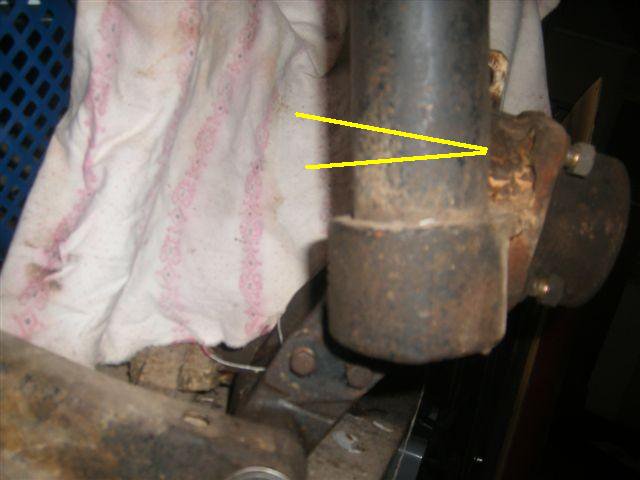

Thanks for the replies. It would be 100mm (50mm each side). The first photo is an over exaggeration, the offset is far less in practice. Would it be possible/practical to notch the strut assembly, low down near the bearing housing, as shown, and re-weld to reset the camber to zero or am I just beginning to chase my tail with this whole idea? -

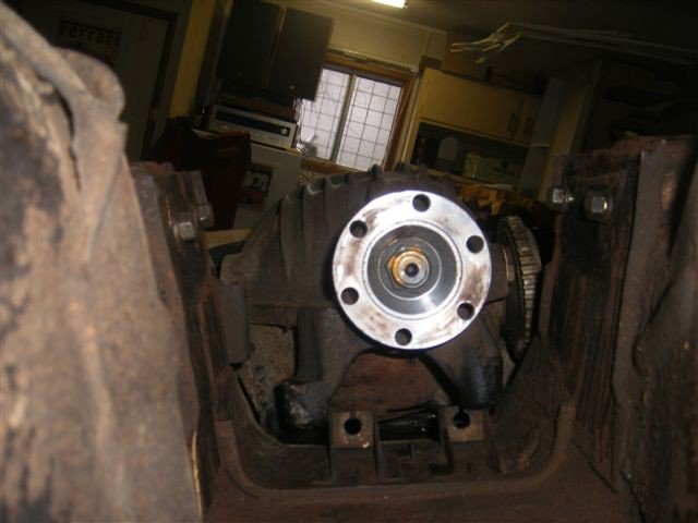

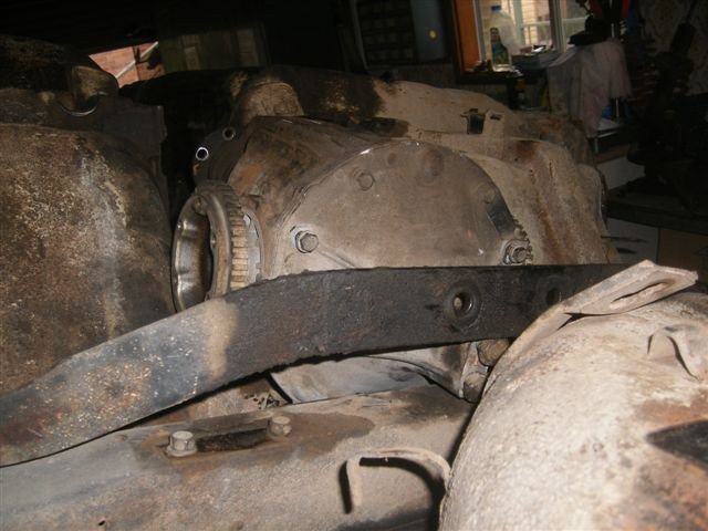

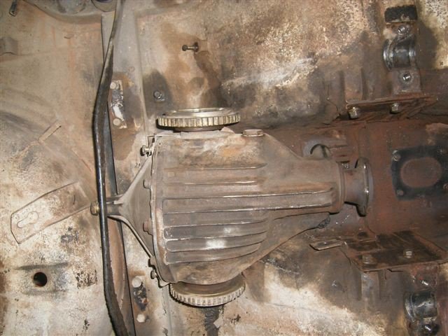

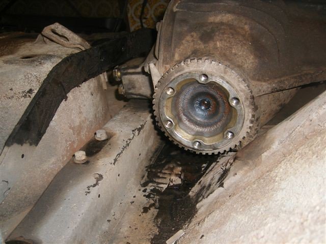

Hoping this thread gets some traction (pun intended). I have purchased a GM diff and it's a bit scary as everything seems to be going okay. Firstly, the weight; only measured on bathroom scales but came in at 74lbs. I think the r200s are 72lbs and I know from my chiropractor that the r230 is 117lbs. So the weight looks good. Secondly, the fit; as you can see from the pictures there are no real dramas at this stage. It looks as though it can be mounted with the axle centerline somewhere between 2"-3" closer to the floor pan than the original 240z diff installation. I'm not too sure about the moustache bar at this stage. It may be possible to retain the original and use a triangular bracket to attach the two vertical mounting points on the rear of the diff (considered as one point of the triangle) to the two existing mounting holes in the moustache bar. This would mean mounting the diff 1"-2" further forward from where it is pictured, creating a misalignment with the wheel hubs, though I understand this is standard practice on the Porsche. It looks as though a variation on the R/T front mount should be possible. The PCD of the bolts on the CV is 95mm and I think they are 112mm on the r230. If it is not possible to have the MM adaptors machined to the smaller PCD then I should be able to get away with using a spacer drilled and tapped to the different PCD's on each side. One thing I noticed is that the CVs are secured only with screws - I have observed how most people seem to use bolts and nuts for this connection. The screws should allow for a much neater adaptor and they could be lockwired or tabbed for extra assurance. Unlikely to be working on the project for the next month but will post an update when I resume. If anyone can see that I've missed something please comment. Thanks. Sorry for the mix of imperial and metric measurements.

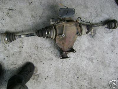

If I can use the GM CVs on both ends it would only mean a shortened axle and some adaptor for the outer end. I'm quessing that due to the hardening or raised splines the axles cannot be actually shortened and that new complete ones will have to made. As GM vehicles are so popular in motorsport down here I'm confident someone will be able to hob up a shortened version. The multiple choice of ratios is, as you say, an exciting prospect.

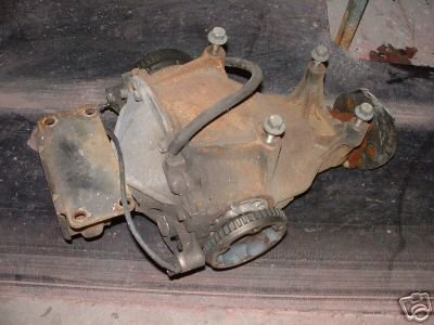

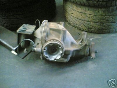

I'm very interested in this thread achieving its original aim. It's very enticing to follow the path made easier by the hard work of others and that's where I was heading - r200, CVs, Arizona Z mustache, etc. The big difficulty we have down here is that LSD r200 diffs taller than 4.11 are non-existent. No 3.54 Q45s, etc. What we do have is thousands of 3.07 IRS diffs that come with the GM LS1 powered vehicles - Commodores, Utes, etc. If you use a donor car it means you can utilise the whole drivetrain from the crankshaft to the outer CVs. I would have thought the diff is used in the States as well and wondered if anyone has considered this approach. I appreciate that it would mean designing a new mustache bar and front mount but has anyone gone down this path? This diff in image #1 is from a pre-LS1 powered vehicle but it looks very similar to that used in the LSI cars. http://cgi.ebay.com.au/STATESMAN-COMMODORE-V8-IRS-LSD-DIFF-ABS-VQ-VP-VR-VS-A_W0QQitemZ250169475493QQihZ015QQcategoryZ102360QQssPageNameZWDVWQQrdZ1QQcmdZViewItem
