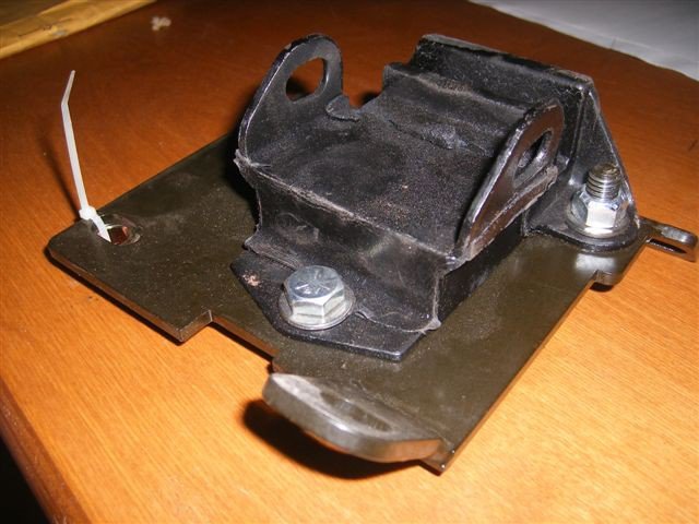

Can anyone tell me where the actual rubber mount comes from that is used on the JCI LHD passenger mount? Thanks -

I assume you mean the driver's side of a LHD vehicle. That may require a second crossmember just for that side. That creates sump clearance issues and also inhibits exhaust space. -

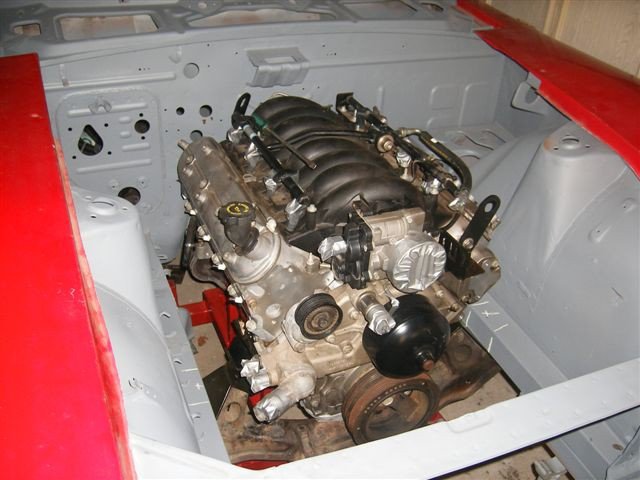

Bear with me on this. I know the JCI mounts take all the hassle out of an LSX install, that's why I purchased the kit. However an Aussie GTO/RHD setup has unique problems, primarily with the exhaust design by having the steering shaft and starter motor on the same side. I dropped the shell over the engine/transmission today to see how difficult the situation is. One option I have is to relocate the starter motor to the other side, see part number AP130B http://www.rodshop.com.au/catalogues/AdaptorPlates.pdf but the configuration of the JCI/Camaro mount combined with the relocated starter motor then creates exhaust route problems on that side. It looks quite feasible to construct on the LHD driver's side a new engine mount similar to the LHD passenger side mount by utilising the forward two mounting holes on the crankcase and the three alternator mounting holes. There is enough material on the alternator mount itself to flycut off the thickness of a mounting plate and still mount the alternator (though that's another GTO problem that may require a complete relocation). If you are still with me I would appreciate some comments.

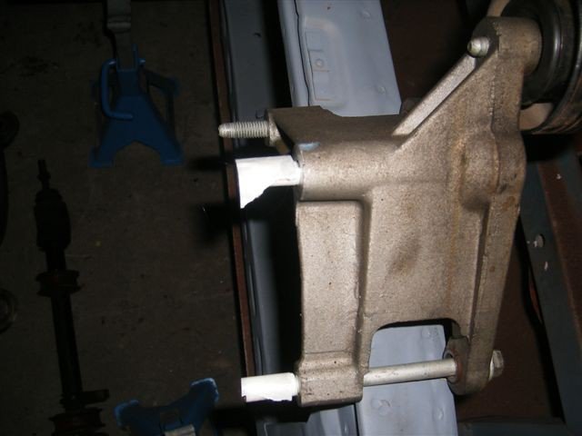

GTO LS1 and Alternator Location
Boy from Oz replied to Wheeler's topic in Gen III & IV Chevy V8Z Tech Board

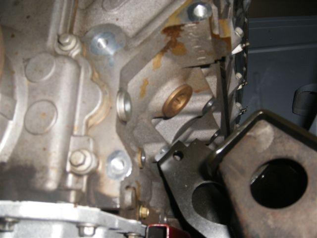

I purchased the oil pan items listed in post #15 on the thread below, unfortunately I'm still a few weeks away from fitting them so I can't endorse them as yet. http://forums.hybridz.org/showthread.php?t=118395 I've noted on my Aussie LS1 that the dipstick enters via the oil pan so I will have to drill the crankcase to fit the corvette dipstick. It may not be clear on the photo of the original pan fitted to the engine, but the dipstick enters on the side of the pan near the front - If you have this pan you soon see what I mean. My LS1/t56 is from a Ute so the GTO may be different. Also, the Aussie fitted t56 transmission has the shifter setback an additional 50-75mm or so. I recently purchased a Firebird short-shifter to replace the original but the alignment is all wrong and the lever is tilted forward when in neutral - haven't solved that one yet. -

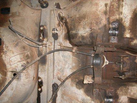

For me, this has been a very fortuitous post. I was just about to attack my old transmission mounts tomorrow. I was planning on removing all of the mount and the extra surrounding sheet metal. I think your approach of just removing the protruding material is a better way to go. I’m sure it keeps some extra strength in that area. I’m always searching for a photo of the reshaping required of the transmission tunnel to clear the reverse lockout. From your photos it looks as though you didn’t need to do that, although I noticed you seem to have given a few hits lower on the tunnel closer to the floor. So is that reshaping only require to install the t56 rather than to have it operate effectively? Can you provide a few more details on that point of the swap. By the way, congratulation.

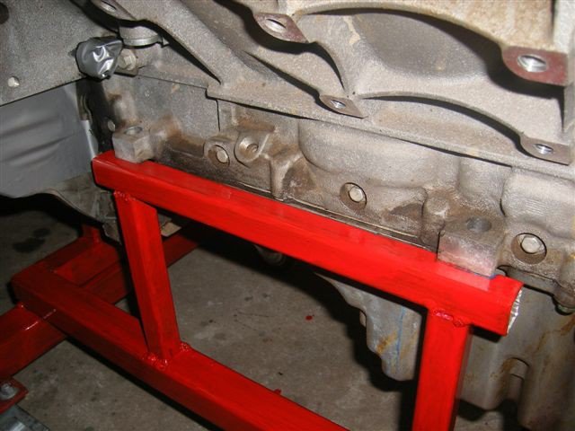

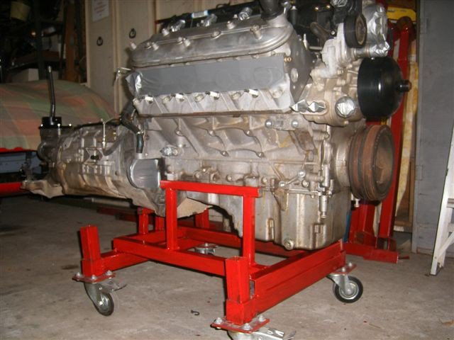

There was the usual bit of trial and error but in the finish I got there. This setup allow removal of the sump (oil pan) whilst on the stand - I have a Corvette one to fit. A trolley jack can slip underneath to lift the engine/gearbox plus trolley or with a block of wood under the sump just the engine can be raised. I haven't parted the items as yet but I don't see any reason why the gearbox cannot be removed and the trolley support just the engine. Just as a matter of interest, I estimate that the centre of mass is around the flywheel area as the the whole assembly requires the gearbox support. -

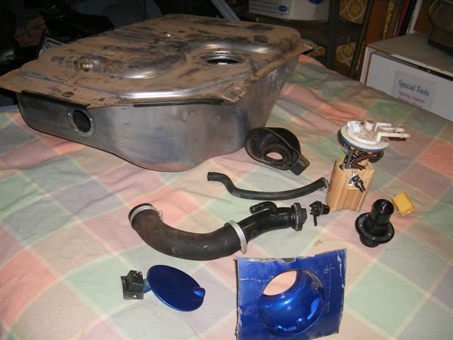

I'm working towards the same concept. My approach is to utilise as much as I can from the LS1 donor car. To that end I have kept all the fuel tank items in the hope I can marry them to an aluminium tank I am constructing. One item is the one-way valve seen in the photo. You may want to consider picking up something like this new or from a wrecker.

An LS1 into a 240Z can be approved under DOTAR's rules. I've done it! I have undertaken a lot of research on this before commencing my LS1 installation, to the degree that I have RTA approval to go ahead. "zed240au" has been a trailblazer in this and I have been more than happy to learn from his mistakes (very few) and to copy many of his innovative solutions to a RHD installation. Top bloke.

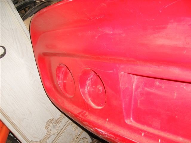

I would agree with that in the case of flat panels and vertical lights. Mine however, has some fairly involved shaping, none of which is to my personal liking and will be modified to a more 250 GTO style. I'm guessing that the larger lights may have had something to do with vehicle regulations rather than merely design preference. I'm just interested to know where mine may have originated. I think a member here, 'Y-Not', has or had a yellow replica with this rear section, and it may be from Thunder Ranch.
This is reportedly a McBurnie rear. While the number plate area is similar, the rest the Kamm depression and the spoiler are different. The lights seem a little further spaced as well. Also your kit does not have the faux vents in the panel next to the door windows like a McBurnie. Looks like it's getting narrowed down to a Stable Autowork (Isabella). Anyone got a rear shot of one? My own kit has Eagle/Alpha front but has the large (100mm/4") horizontal twin rear lights. Does anyone know where that configuration originated? I plan on modifying it to the smaller vertical setup.
I can only suggest it's neither an Eagle nor an Alpha for a couple of reasons. Firstly the leading edge of the bonnet (hood) starts too far back from the triple vents, and secondly the door handle area is not recessed for a Datsun door handle - unless you or a previous owner have modified them. Likewise I don't think it's a Rhino as they appear to also have the longer bonnet. A better photo of the nose might help narrow down the possible make. Also the tail-light configuration might help. My guess is it's a McBurnie (see new link) I might add that I'm more than a little displeased with you, Duke. You know how badly I suffer from procrastination, yet just as I'm about to buy a set of 6" front and 7" rear Daytons you show us a photo of that awesome wheel setup. Thanks ... now I'm again undecided and back on medication! http://www.zparts.com/history/articles/kit_history/articles/3calGTOs2.html

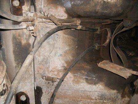

You would never get it rego'd - nor, it the name of safety, should you be allowed to! Look up the design rules; there can be no welded brake components. See Section 5.2, Modification of Components. Second dot point. http://www.infrastructure.gov.au/roads/safety/bulletin/pdf/NCOP5_Section_LG_Brakes_3Feb2006.pdf Remember Mark Webber in qualifying for the AGP - not a weld failure, but brake failure is serious stuff. -
