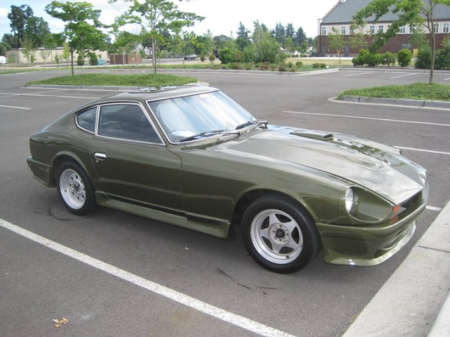

27 bought my car last year 2010 when i got back from afganistan. Ive always wanted a project car, and im prone to Nissans. I owned a 84 300zx for a month or tow till i craped out on me wrtie before i went to Iraq so i sold it. When i came back from Iraq i opt for the practical car and always kicked myself for it. While i was in Afganistan i did nothin but search for a new project car in my free time. So i found my car June 27th came back from Afaganistan July 4th and bought her on July 7th 2010 in Portland, OR. My intial plans were to swap in a RB26 then i did more and more research on the L28 and decided to go with that.
