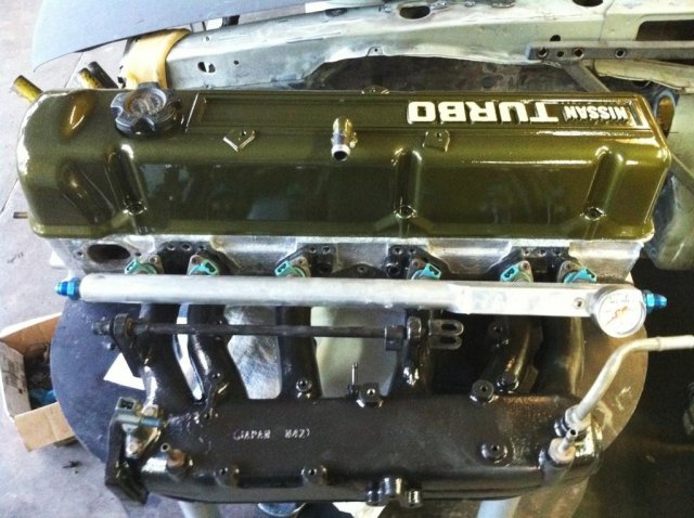

Block: * F54 L28et turbo block * JE Forged Pistons and rings 89mm * Mechart A-Beam Investment casted Stainless Steel rods * ARP Rod Bolts * Diesel Maxima Crank shaft Knife edged lightened and Zero balanced * Nismo Main cap bolts * Genuine Nissan factory Main and rod berings * Nismo oil pump * ARP Head studs * SCE 2mm Solid Copper head gasket with sealing rings * Brand new Front timing cover * New water pump * New Oil pump drive spindle and crank gear * Nismo single groove dampener w/ Nismo front crank bolt * 83 280zx turbo oil pan * all nissan seals and gaskets Head: * P90 Head off 83 ZX turbo * Schnider Cam Lift(In/Ex): .460/.460. Duration(In/Ex): 270/280. * Schnider matching dual valve springs, retainers, lash pads, and rocker arms * Ported polished * 5 angle valve job *New vale seals * Resurfaced and decked combustion chamber and intake/exhaust side * N42 non-egr intake manifold *420cc injectors *JSK Fuel rail w/ Autometer pressure gauge * T3/T4 Turbo Off 82zx 280zx 800 miles since rebuild * 82 280zx turbo outlet without power steering and a 83 280zx turbo outlet with power steering * 2.5" exhaust mid pipe * Oil pressure T-fitting w/ Hard style oil to turbo * zx turbo valve cover * 89 300zx full Engine harness with ECU * 83 280zx Mass air Flow sensor w/intake boot * 83 280zx electronic distributor * MSD boost dependent Spark retard Box * 2.5" thick innercooler Borg Warner T-5 zero balanced flywheel and clutch 3 core MSA radiator Walbro 255lph fuel pump Soon to come: 650cc injectors MS-II ECU After the power station is built i will start to work on suspension along with wheel and tire package Thinking about going with 17x9.5 on the rear and 17x9 on the front OEM CF Hood
