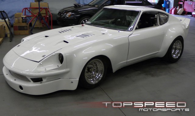

I know we haven't finished the body work or a host of other items, but I had to just bring her home and enjoy looking at her for a week. I'd say she fits right in and holds her own just fine. Matt -

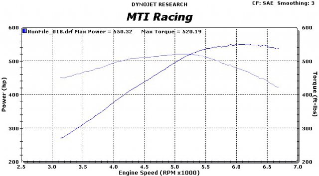

DYNO run went well. She's putting out 550hp with 520 flbs of torque. She Plenty for a 2150 lb track car. We did figure a few things out that we are going to have to change. 1. The oil lines from the ARE dry sump tank need to be re done. I've come to find out that they need to be either level or declining towards the engine. I guess now that I think about it, in Nascar they build the car around the oil lines from the dry sump in the back for that very purpose. Just a dumb mistake but certainly can be fixed. When we take everything apart for paint and body we will then run the line down the tunnel with some heat shield. I take that back, we will run it where it works best. 2. The Walbro fuel pump is not strong enough. We would need two of them. We will probably just replace it and go with a Aeromotive A1000. That of course changes the tune so back to the dyno for a re tune. $$$ 3. We changed the injectors from LS7 to LS9. It feeds it a little better. 4. Other than that, just some tweeking of small items. (Clutch, alignment, tighten some bolts, a few more braces for the exhaust, etc...) -

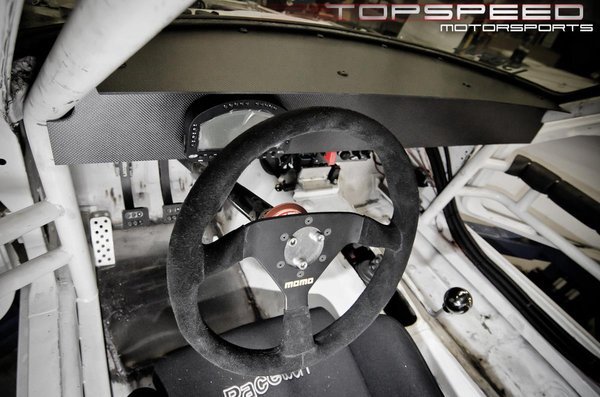

I gotta be honest guys. I probably should alert a physician as I have had a stiffy for over four hours. 4 wheel VIAGRA. Every person who has ever done a long project knows the feeling the first start up of a new power plant. Almost 50 years old and I'm smiling like a kid in a candy store. It energizes everybody involved. We are going to break for Christmas holiday but then we run the brake and clutch lines and install the new carbon fiber dash. We plan on some up the street and back runs to get our fit and finish worked out. On the dyno for some break in and tuning. Then shes off to the bodywork shop for some new make up. This winter is going to be exciting and look forward to a spring 2012 unveiling. I appreciate all the comments, Have a blessed holiday season.......... Matt -

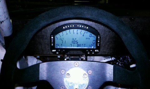

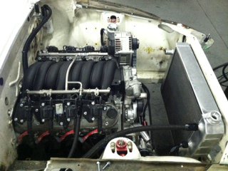

UPDATE..... Custom Griffin radiator with oil cooler just went in. Hoses on order. / All fittings for oil and fuel lines are in. / Tilton pedals are in. / We had a custom bracket for the altenator machined. We re machined it as low as we could get it and it is still is a touch high (when we put the hood on it touches) so we are going to have to put a little "gurney" bubble in the hood to make things fit. There really is no other option. / Had to machine the pulley on the Razor fuel pump to line up the belt. thought it was going to be a big deal but turned out perfect. / We are going to re enforce the frame rails under the floor pans. / Building the bonnet for the fuel cell. / AIM dash display and data with two smarty cams have arrived but not installed. / NACA duct for helmet blower has arrived but not installed. / Decided to install windshield wipers. / We are maybe a week or two from ignition. Probably do a little video as she comes to life. I do have pictures of all the parts I have for sale. Will get those up this week. Really would prefer to do a package deal on most of these items. Engine: Stock L28 short block P90 head, Delta cam, Schneider springs, light port work. Just freshened. BHJ damper 550 RC injectors PT 61 T4 Turbo (Gt35R compressor wheel, P trim .58 hot side) Cockpit adjustable boost Supra in tank pump feeding a surge tank with a Walbro pump. Remember that the wastegate was no good. Could be rebuilt but not worth my hassle. The ECU system was a megasquirt. Personally I hated the system. Drive Train: HKS 10 lb. flywheel Tilton Twin Disk race clutch Late 280 ZX 5 speed (0 hrs since rebuild with 5Th gear ratio change) 3.9 LSD Suspension: Koni shocks front and rear Coil over 500f / 425 r Camber plates Adjustable front control arms Arizona Z adjustable chromoly rear control arms 15/ 16’ front sway bar Wilwood Racing brakes front and rear Wheels and Tires: 3 piece Keizer 15 x 10front / 15 x 14 rear (4 lug) Avon slicks with some life left We should have a few other parts like the diff, drive shaft, fuel cell that are not listed. I want everything to be sold. I even mean the old gauges on the old dash. -

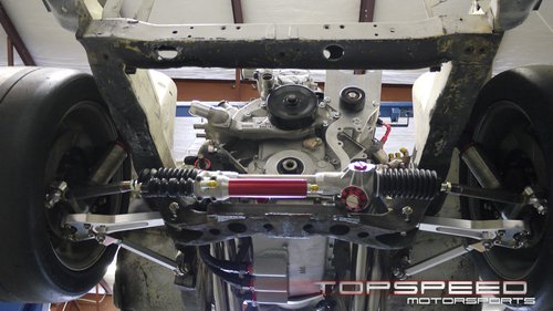

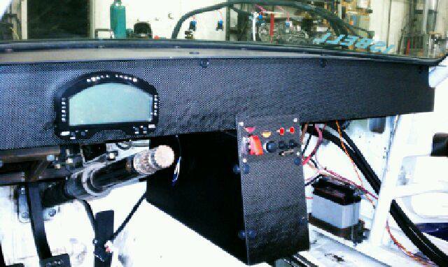

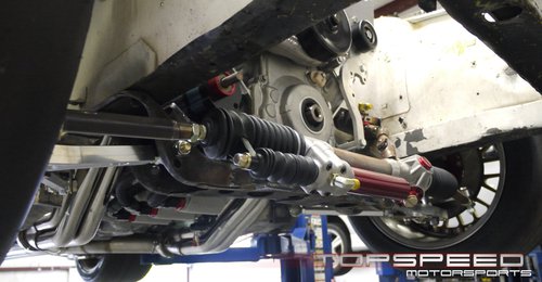

Update......... The Woodward power steering rack is in and looks great. Really think this is something I would have done regardless after the first track session, glad to get it out of the way. ARE dry sump tank is now mocked up and ready for install. We decided to put it behind the passenger seat and go with a small race battery that will be located under the passenger side of the dash. Having the weight of the tank located behind the seats is actually going to work to our advantage when balancing the car. Tilton pedals are on there way and will be installed soon. The custom billit bracket we ordered and waited four weeks on I think is still going to sit the alternator a little to high. We will see. Matt -

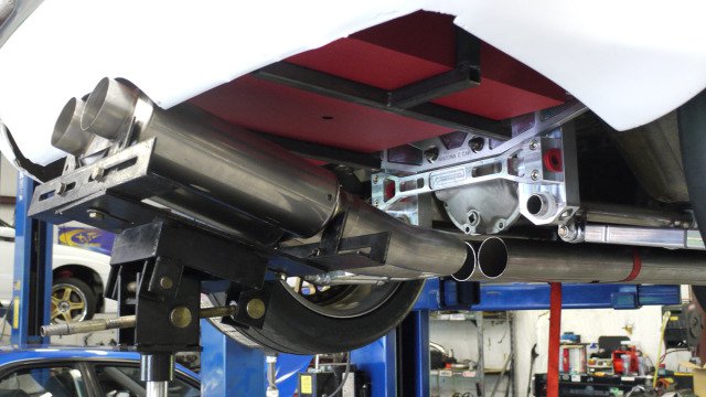

Mocked up the rear exhaust today. Liked it best with the duals coming right out the back centered. Thinking of installing some vortex cone baffles to keep the noise down. I love it loud, but much more strict rules for decibel violations at the track these days. It's still gonna sound mean as hell. Also, this new picture shows the work we did on the box we fabbed for the fuel cell. Arizona Z suspension looking good as well. I will F-glass the rear valance where the stock pipe used to be to clean the lines up. Q-45 rear w/ Carbonetics rear diff in place in as well.
