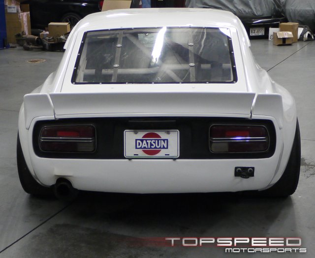

Much better...... That gives me something to think about. I would love to have it attached to the hatch and just open it normally. Fabricating a frame, and it could be welded to the subframe, that the wing / hatch then attaches via pins once it shuts could work. Great idea. I'll run it past the guys tomorrow and see what they think. Thanks for your help, I really think you have given me a solution, even if it is just in theory, that will work and be the best solution to my dilemma. I will keep you updated as to what direction we take. Thanks -

I appreciate your thoughts, as well as any others. If I were to start running enduro the fuel filler tube would be a great idea. I only run in 25 to 40 minute races. That is why I installed the 22 gal cell, so I don't have any refueling needs during a race. I want to be able to remove the rear hatch and not touch the wing. Many people have wings and don't actually adjust the downforce effectively. We are going to test and adjust and I probably will leave it in a fixed position according to the track set up. I also see people with flimsy wing setups that cause more drag than downforce. I am a member of Atlanta Motorsports Park and recently installed a passenger seat to enable me to take people for joy rides. This forced me to install the cool suit box in the rear of the car. Its too much of a pain in the ass to remove the passenger seat depending on if I'm racing or messing around (it's bolted to the sub frame). One more reason for the hatch to be able to be taken off to access the back. -

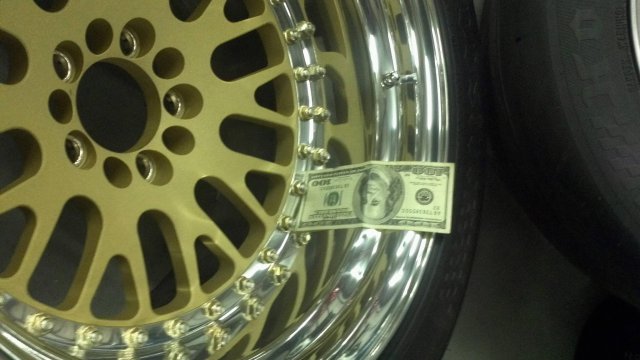

Thank you. I think the black looks great on your car. I wanted to have these anodized gold to give the look of the original three piece BBS snowflake pattern found on most all vintage IMSA GTU cars. I called BBS a year or so ago and inquired about getting a set made for this car as it was my original choice. That particular pattern has been out of production for some time now. They said they could certainly make me a set. All they wanted was $2,500 per wheel. I wanted two sets. I was born at night, but not last night. $20,000 for two sets of wheels, sorry but I think I could find some better options. I remember 30 years ago when you could buy the gold spray paint directly from BBS, I don't think they sell it anymore because of the amount of lead that was in the paint and the EPA made them stop selling it. You could maybe research that and have a simple solution to your wheels. As far as the pics and video... I am installing a two camera data acquisition system, so there will be plenty of video as well as data feedback that could help me, hopefully, as well as others in track setup. Stay tuned.......... -

I am trying to visualize what you are describing. If we mounted the wing to the rear hatch it would not have enough strength to actually work, it would just rip off, unless we fabbed a mounting frame under the rear hatch to weld to. I really think its going to be necessary to go straight to the frame rail for strength. I could see using pins or fasteners that could be removed then the wing taken off to access the back. I just don't like having to remove the wing every time I need fuel. My idea of the rear hatch being attached by pins, then sliding under the wing allows me to make the wing mounts as sturdy as possible and not have to remove the wing just to get in the back. -

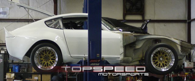

17 x 11 front 17 x 12 rear Mounted the front today. I might need to put in a little bump stop. At full turn a slight rub. I cant think of the last time I ever turned the wheel, maybe in the pits while parking or something, all the way. Easy fix. Was disappointed to learn that we did not receive rear hubs with the AZ z track pac. I would have thought the five lug rear hubs would be included. Why wouldn't they be??? Front hubs were included. Anyway we ordered them from the local Nissan dealer and they should be in tomorrow. Headers on the passenger side are mounted. Drivers side a little more challenging. ALL GOOD PROGRESS..... I have been also involved with a thread over on the "Paint and body kits" under (Race car rear wing and Aero). Any comments are appreciated. -

It took longer than expected but like most good chefs that make you wait on your food.........It's usually worth the wait. CCW custom race wheels are here. Hanging the new suspension and cant wait to hang these puppies and set it on the ground. -

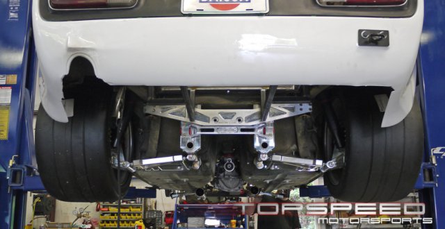

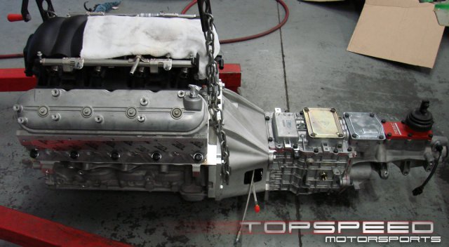

Mocking up the engine (it's sitting back behind the shock towers and looks soooooo pretty), got the tranny mounted. Waiting on the wheels and tires to come in so we can mount the new suspension. The new "Trac Pack" from arizona Z is so much more impressive up close than the pictures do justice. They really make an incredible setup. Made the decision today to install a Tilton Pedal / Brake assembly. We can do away with the master cylinder under the hood, as the new system is self contained under the dash. New 22 gal. race cell just came in and will be in this week. Matt -

Mark, Thank you so much for the pictures. Very helpful....... When you said you had to modify the fender. Just notch out a hair to get it over far enough for clearance? I don't see how that would effect performance but did it conflict with the body/fender in any way. You said if you had it to do over again you would fab a custom tank. Wouldn't that make it smaller and ultimately effect cooling in high output situations? Or would it be the same size but just configured differently to fit the space? Really appreciate your help, Matt -

That's great input. I will certainly take a look at our space very carefully and consider the custom tank. Our first thought was under the passenger dash but I didn't want the extra heat in the cockpit (The firewall is getting well insulated). Second thought was behind the passenger seat but that would have filled the space for the cool suit cooler. The stock battery area is the best place after all is said and done. You wouldn't happen to have a picture of your old setup that I could learn from? Appreciate the help........ Matt -

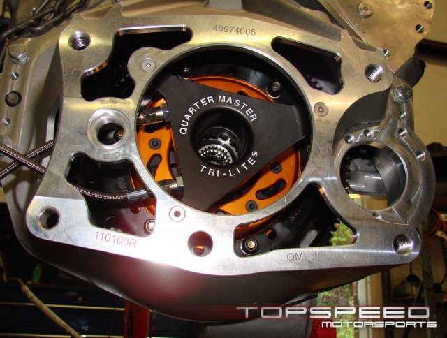

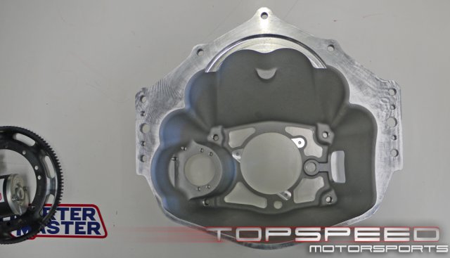

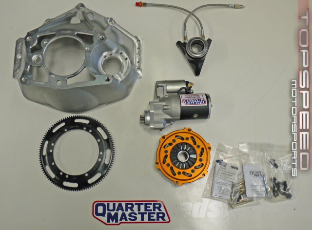

Parts are starting to come in. Nothing like new, right out of the box, clean parts. I've attached a few pics to show progress. Quarter master 5.5 triple plate clutch. It's ultra compact and will allow us to run a reverse mount starter and very compact bellhousing. This will allow us to wrap the headers and exhaust down and around the motor in a much tighter fashion. Here's a view of the bellhousing. This setup is all designed to work together, so there's no need to shim the throw out bearing Tremec TKO-600 Transmission. It's designed to take some serious abuse. Engine should be in by next week. -

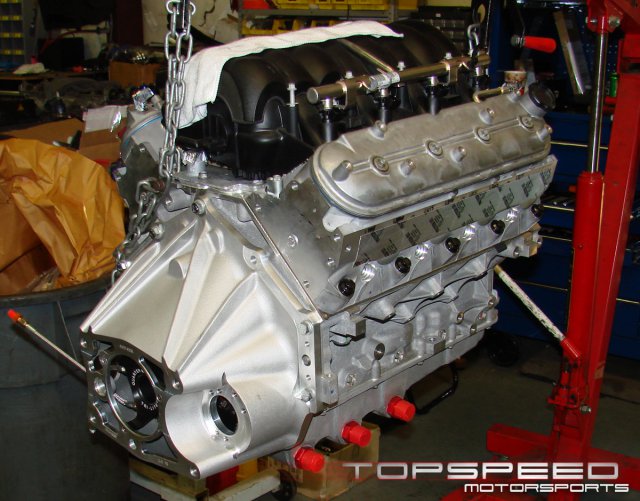

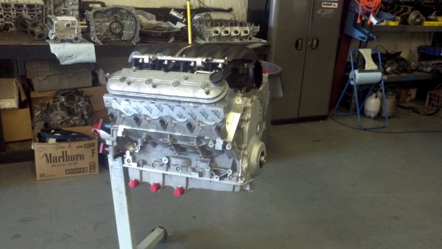

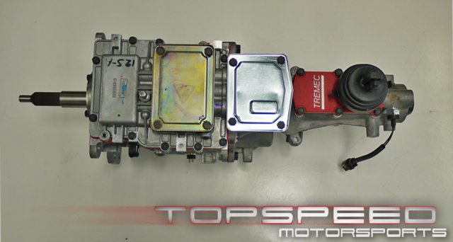

Guy's, Engine is being built as we speak. Cleaning engine bay of just about everything. It should be ready in a few weeks. We are trying to figure a good location for the dry sump system, keeping in mind the balance of the car and heat factors. Transmission arrived yesterday. Getting template for new 22 gallon FuelSafe race cell and cutting that out this week. This is a real fun part of the build where stuff is arriving, it's like Christmas morning opening boxes. The new wheels and suspension are about three weeks out. I will be putting together a list of all the items I will have for sale soon. The L28 short block Turbo engine (minus the wastegate) with P90 head, Delta cam, Schneider springs, light port work, BHJ damper, 550 RC injectors, PT61 T4 Turbo with GT35R compressor wheel, supra intercooler, the coil overs, Koni shocks, 15/16th front sway bar, wilwood racing brakes and calipers, 12 gallon race cell, newly rebuilt 5 speed from a late model ZX (5th gear is racing ratio not overdrive), ArizonaZ front and rear adjustable chromolly control arms (older style, but real nice), Titlton twin disk racing clutch 5in. short throw, HKS 10 lb flywheel, 3 piece 15x10f 15 x 14r Kiezer 4 lug racing wheels with Avon slicks that have a few laps left in them, a custom race dash with all new Autometer gauges. I just got to a point where I wanted to take the car in a complete different direction. If someone was wanting to upgrade their present ride here's the whole package. Haven't thought about pricing yet but will soon. Put the word out. It was putting out 348 rwhp at 15 psi and 408 rwhp at 20 psi on the last track day. I will keep updating pics as we move forward. Thanks guy's, Matt -
