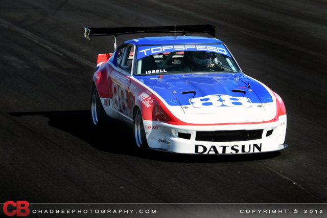

Here are a few solo hot laps, a little more on pace but still in traffic. Matt -

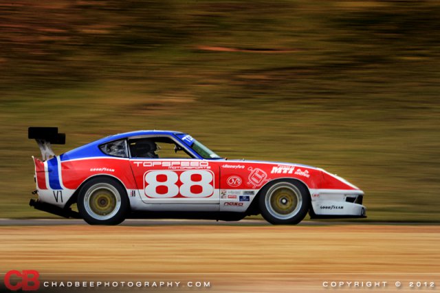

Chad forwarded these to me tonight. He certainly has an eye for beauty. In three weeks I will be at The Z Nationals at Barber MotorSports Park in Alabama, running my car with the famous GTP and GTU z cars of the past, the new 370 Nismo Z's on the continental Tire WC circuit, and some other z's that raced at one point or another. I have Chad going as well and I am sure this will be the shoot that I have been dreaming of. I am hoping that my car is at least competetive on the track with all these factory race developed cars. It will be a good test for sure. I really like the one with the empty track in the background..............it's in the chicane that is inspired by the Nurbergring. Some people have said, was I aware that my front left comes off the ground all the way around the turn. I guess seeing is believing. Matt -

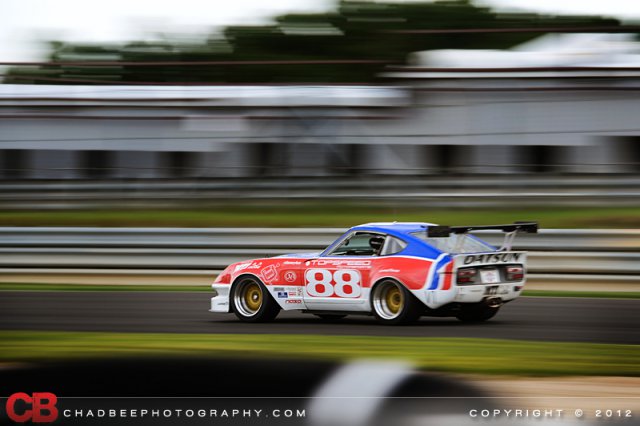

I want to take a second and thank Chad Burnette for all the incredible pictures he takes at all the different tracks in the SouthEast. I know there are a few screen savers out there, well he is the one who should get all the credit. He took this a few weeks ago and I have no idea how this works but the car was going 160mph and in the picture the car is static and the background is blurry. Isnt it supposed to be the other way around??? Very Cool............. If anyone is in the SouthEast and wanted a true professional to do a personal shoot or trackside shoot I highly recommend his work. BTW........He doesn't work for free. Matt -

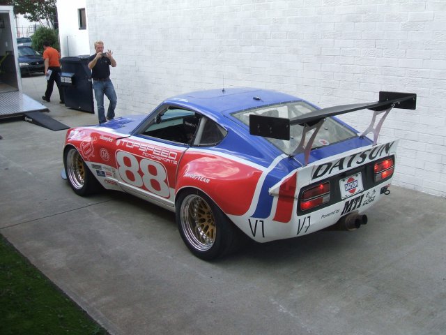

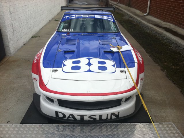

I also wanted to post a picture of her going into the trailer. They say that your aero package is just about right when it wont go in the trailer and you cant get a jack under it. Id say this is either genius or just plain dumb luck. You can probably get a few pieces of notebook paper under the nose when shes going in. I take absolutely no credit................thats just Dumb Luck. Matt -

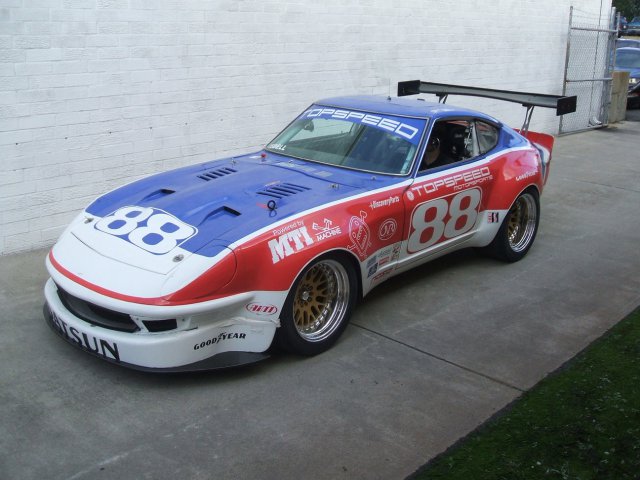

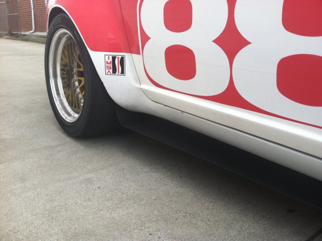

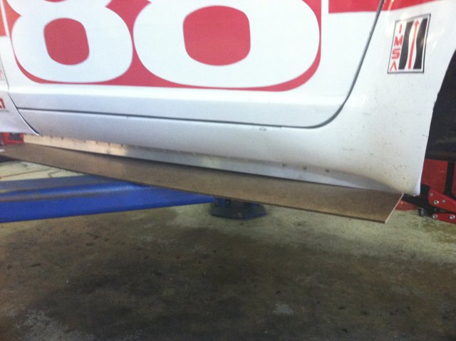

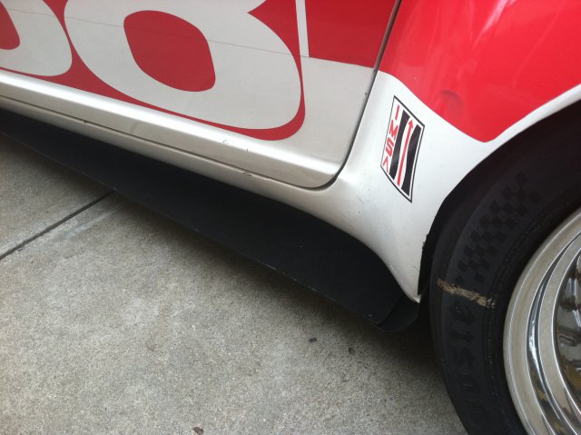

Been working on side skirts..........didn't want to post any pictures until I had a better idea of what we were doing. First picture is just mock up. This is what I'm taking to the track tomorrow. We am going to actually make them bigger as these were designed without the rear wheel on. After we put the wheel on I realized there is another 3" that I can bring it out and have even more surface area for the air to sit on. This is why we dont design with the expensive stuff. We also installed two new hood pins in the middle of the hood as it was bowing up from the high pressure. Very secure now. I'm going to cut a hole in the cowl next week and make a trap door to be able to access the pedal reservoirs. We also put an additional hole in the uprights so be able to adjust in a little more rear downforce. We adjusted the bump steer. The front right had 1" of play left front was pretty bad too. The rear was almost dead on. It is now within a 1000th of an inch in front. You think that make it a little more stable at high speed???? Ya Think......... Matt -

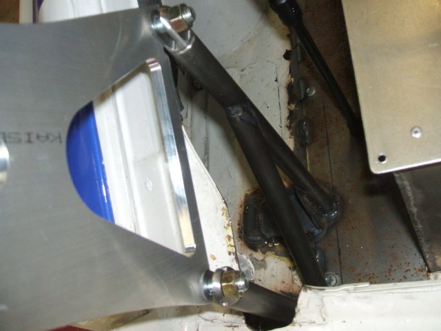

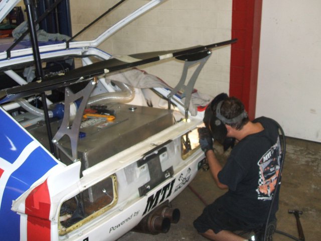

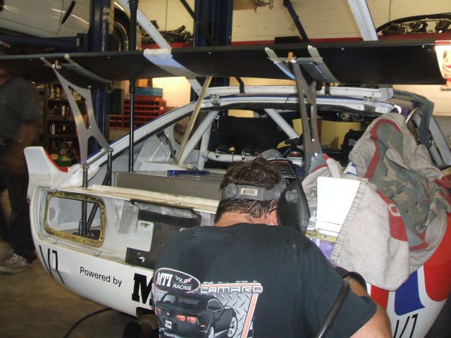

I have the Carbon Fiber dive planes just dont have time before Sat. to put them on. I'll gather data without them and then next week with them. This might be a viable way to secure the wing to the frame rail and it not resrict the operation of the hatch. At least not a major operation to open and close it. I'll let you know how it goes. I have to be very careful as I don't want to push too hard, like I did a few weeks ago, testing the envelope of the new aero. BABY steps are difficult for me. Matt -
