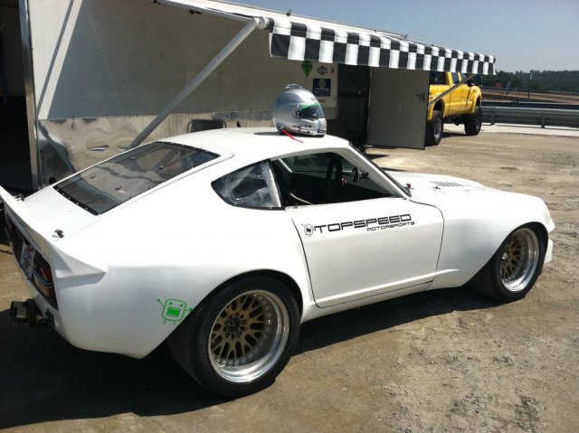

cobramatt replied to cobramatt's topic in S30 Series - 240z, 260z, 280z

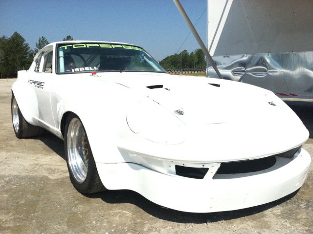

UPDATE: What a long holiday weekend. We were able to take the car to the track and do some very needed setup on the car. After a two year build to finally get her out on track is a great feeling. No major issues. Just had an incredible time all weekend long. Whats really cool is to have her on the grid along with a bunch of new exotics and everybody wants to look at her and talk about the old school ways. -

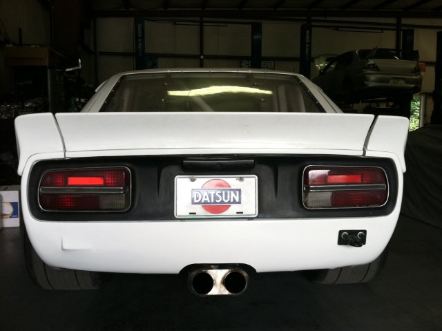

I really appreciate it. Giving credit where credit is due. I dont know if everyone knows you work for TopSpeed. Our race shop. The brake ducts, radiator box, new tail light, exhaust inserts, hood modification, and a host of other items were all done by John. He is so busy working on my car that he hasn't touched his Z in two months. Your car is next............ Thank you for all your hard work and friendship, Matt -

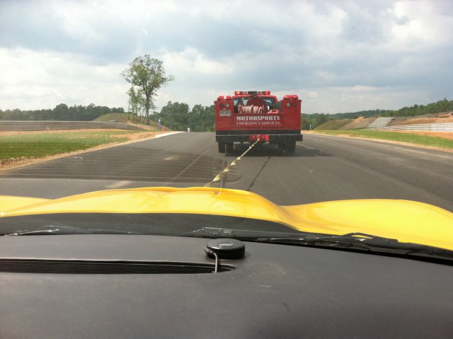

I wanted to also tell everyone how incredible AMP has turned out to be. I have been waiting for over two years to get this track built and it was worth the wait. Very technical. It has a nice fast section but all in all its on off on off on off. Going to be hell on tires. Been up every weekend for practice in a World Challenge Corvette. This weekend will be the first time in the Z. Thought I ought to post a picture from last Saturday that is never good to see but it happens. Blew the O2 sensor out of the down pipe. Happened right at the end of the front straight (at 150mph) in front of a crowd of people. Sounded like a gun going off. The only thing that went thru my mind was........"I hope that wasn't my brakes". Matt -

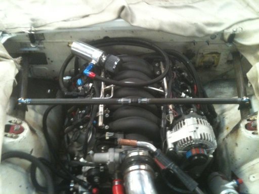

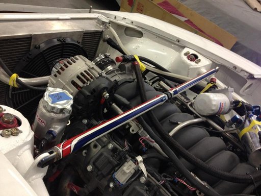

UPDATE: I had a new strut tower brace fabricated. It ties in the shock towers on the new cage bars that we ran through the firewall. They know the paint scheme I'm doing so they got creative and did a little something extra. I think it turned out great. Matt -

UPDATE: Filled in back panel. Old exhaust port smoothed out. This gives the back end a very clean line. Matt -

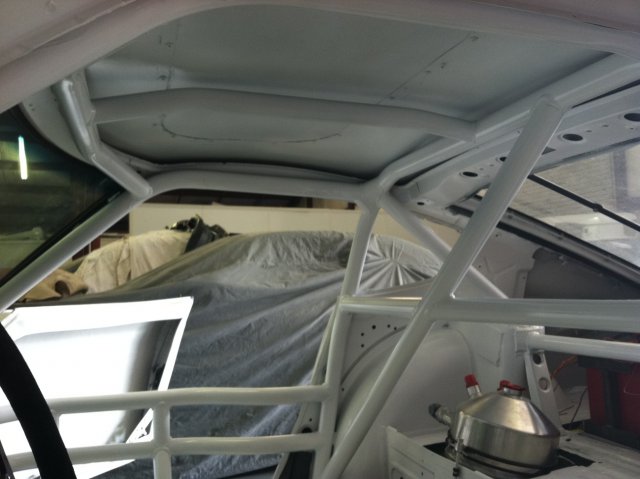

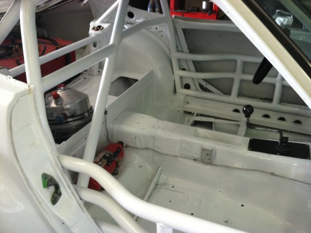

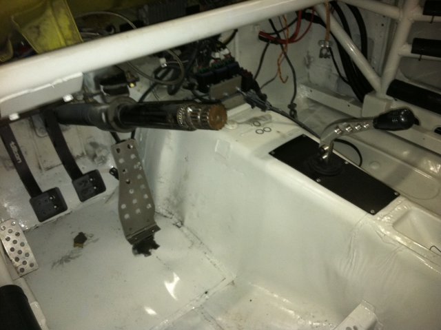

UPDATE: Removed old roll cage and new one, Fabricated by Robinson Racing, installed. Great workmanship and its more roomy. They did a fantastic job in tucking all gaps. Very pleased, even though it was an unforseen setback. Matt -

There is an old saying......If you tell two gearheads that if they spend $2000 on the a few components they will get another 100 HP out of their engine. They will respond "Hell yea, lets do it". If you say hey you ought to spend $800 on a new helmet because the one you have has a small crack in the back of it, they say "This ones fine, its just a hairline fracture". I made a list of items to be checked prior to going to tech inspection just to be sure all was in order. Got a call back saying they had some bad news and was I sitting down........ Lovely........ My rollcage had some fractures in the roof welds. My first thought is, "I know enough people and could get it through tech fairly easily". Now you see my reason for the opening comment. Two ways of fixing it, romove the roof or tear it out and start over from scratch. I opted to have Robinson Racing fabricate and install a new cage. It is much nicer than the one I had. We went through the firewall and installed front and rear strut tower braces. In the end it is not only much safer but adds to the strength of the car. Now we have to re-run all the oil lines, breathers, catch cans, etc... I have these mature moments of clairity that actually surprises even me. I dont think I am getting any wiser, I think I'm just getting older. The opening of AMP is this weekend and I was so looking forward to going. NO CAR. The solution is that I have rented a World Challenge Corvette. I dont know if its cheaper than anti depresants, but its a hell of a lot better for the soul. Also please follow our car (GTR) this year in the TIRE RACK One Lap of America. It starts in a few days. We won overall for the last two years. Wish us luck. TopSpeedTuned.com Matt -
I feel your pain. Was going over a few loose ends and making track debut (shakedown) this coming week, not really hot laps, anyway checked off some minor things to pass tech. Then I noticed that the welds in the ceiling of the roll cage have hairline fractures. Since I wasn't in the mood to tear the skin off the roof I had the old one removed and a new one installed. The guys at Robinson Racing did an incredible job on the new cage. I'll post some pic's over on my thread. I now have no car for the opening of AMP for members this weekend. I decided that I needed to get out so I've rented a World Challenge Corvette just to get some seat time. That's pretty desperate........... Keep your chin up. I also wanted to talk to you about the new battery........When we installed the no weight race battery in my car I had to keep it on a trickle charger ALL the time and it really didn't have the amps to restart the car if I stalled it, and in the pits with this clutch its pretty easy to stall. I dont want to spend $800 or more on one of the no weight high - high end ones. I was just thinking that I had to go with a red top. It might not have anything to do with it, but try your old (optima) battery and see if it helps. Matt

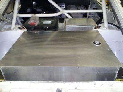

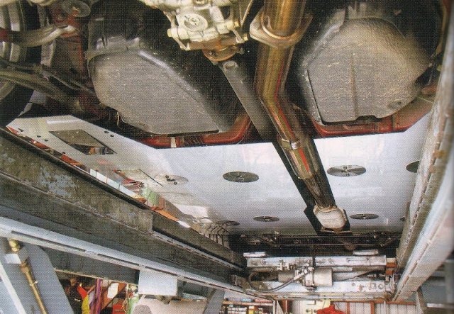

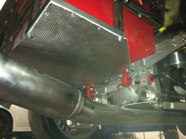

UPDATE...... 1. Ive decided to wrap the car instead of paint it. Talking to a few guys about that now. 2. We have completed the fuel cell and oil tank surround with lightweight aluminum and it looks great. (photo attached) 3. I did some seat time and found out the power steering had no feedback. Our logic was that the more rubber on the road the more assist you need. WRONG....... We ordered a new pump with much less pressure and it seems much better. It had a larger pully so we had to get a new serpintine belt, which actually has better give. The other was real tight on the tentioner. 4. The Razor oil pump was leaking from the seal being oinched so we had to rebuild it......It was brand new. 5. Boxing in the radiator as we speak in the G-nose. 6. Atlanta Motorsports Park is opening up this next week for track time. They just sent out an e mail that they are going to keep all cars with slicks off the track for possibly up to two months. They dont want to tear up the track. I'm wondering if they consider my Hoosier R6's slicks? They are DOT approved tires. That's gonna suck if I can't even take it to the track I've been waiting for over two years to open up. I do have other events to attend but I was looking forward to setting up the car there. Damn.... 7. Got the new front and rear sway bars installed. Spent some time with Scott Pruitt up at AMP this past weekend. He has plenty of experience with Z cars. He won the 24 hour at Daytona in one, more than I'll ever say. He told me of when he was a kid his brother and he had a 260 that they tubo charged and would terrorize the neiborhood in it. He has alway's loved the form of a Z and it didn't hurt when he said he loved what I had done with my car and would love to drive it. That would be cool to have his data in my car and then compare my times against his. It might be hard to ever achieve what he can do but it would be cool to see the cars potential in the hands of a seasoned professional under race conditions. All for now........ Matt -

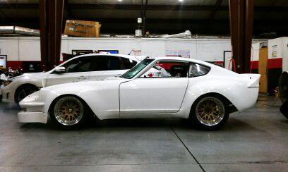

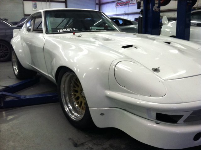

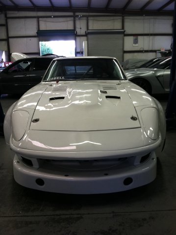

Took the day to assemble the front nose of the car. Over a year ago we molded some carbon fiber head light covers. I still need to work on them a little and I ran out of rivets. (Bad thing is...I can't find the box I had the glass ones we made the molds from. They were expensive as hell and I've missplaced the damn box). Got the Air Dam on and all the Z tabs in place. I was really worried about how flimsy it seemed prior to installation. After brackets and all were in it's solid. Very surprised. I had to cut a small section of the hood out to allow clearance of the LS7 altenator. I plan on doing a very small "Gurney Bubble" to cover it. I can't even see it from inside the car so I was happy about that. I'll take the trailer tomorrow. I have an appointment to get the alignement done (Grand Turismo). We got a sheet metal bender at the shop to assist us with the Fuel cell and oil tank cover/surround to meet regulations. It will make the job so much easier and look seamless as well. Took a few pictures. She's a sexy beast............. Edit: Sorry.........I forgot to downsize the picture first. -
