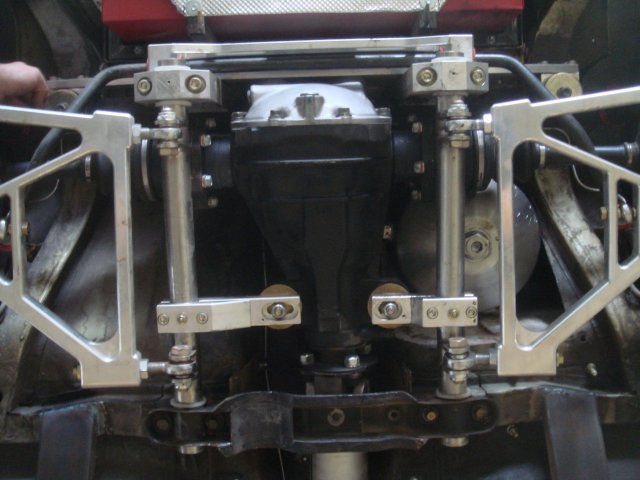

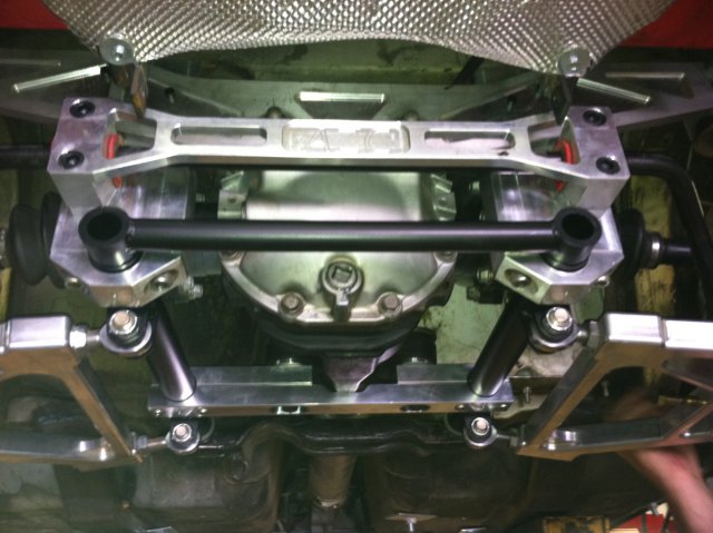

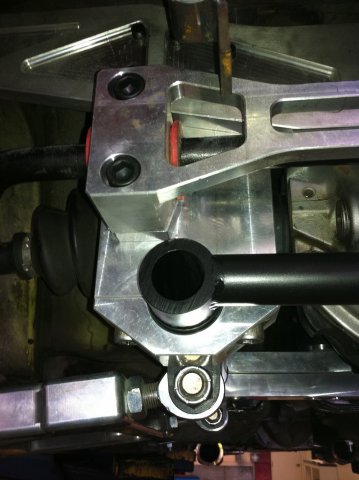

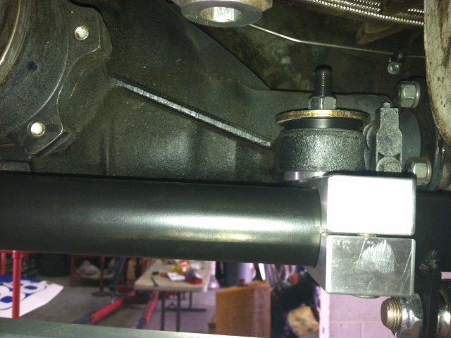

Here are a few other pics that show how we tied it all together. Note how the Mustache bar is now one with the lower control arm mounts. We had to actually re port the holes in the sway bar mount after we squared up the new rear end geometry. It is square to a 1000th. The sway bar mount, that we machined some 1/2 inch spacers that you can see in the pics, was off so my only conclusion is that the set up was not square from the beginning. If it was the holes would have lined up. The spacers correct the geometry of the sway bar that was offset by increasing the wheelbase. Next week we are going to take everything we learn at the track this weekend and go from there. I am excited beacause what I thought was a real downforce issue and was planning on scrapping the three piece IMSA tail for a wing could have been influenced by the fact that my cars rear end was moving all over the place due to the old set up design. I would love to be able to keep the three piece tail for period correctness. Its about the only thing thats actually vintage so I'm hangin on to it....... Matt -

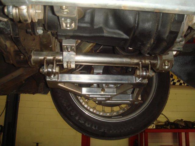

I have attached a few pictures of the re design and new chromoly thicker tubing used to brace the lower control arms. We have basically boxed the whole apparatus to create a square set up. This is far better than before and will not move around. We have also used spacers behind the sway bar mounts as the geometry of the sway bar was way off. We actually plan on going to a complete hiem joint set up and lose the old school type bushings. We are just trying to get her to the track tomorrow for the weekend races. One of the biggest things we did was make the mustach bar and the mounts as one. They were completely independent of each other before. My guess is that Dave at Arizona Z never intended for this set up to work with a car putting out anything over 400 HP, much less 640. We will try this set up and I will give feedback after this weekend. I feel like this is a huge step in the right direction. More info to come......... Matt -

I have posted a few pictures of the damage incurred in the rear suspension during last track day. We are going to basically re engineer the set up. Actually we are going to re machine the lower control arm tubes that mount the arms out of a stronger material. Stainless is not the answer. I do not want to act like the set up is bad and that Arizona Z did a bad job in the design because this particular car calls for a different set up and the fault lies with me 100%. We needed a starting point. One that was an improvement from basic stock set up and thats what we got. This would be an incredible set up if you were upgrading a stock rear end. As you can see from the pictures the torque of this car has really bent and distorted the geometry of the control arms. We have a solution and will work towards that. I am cheating a little because I dont have tome to do all the work necessary to fix this 100% by this weekend as I have a Vintage event at Road Atlanta so we are going to repair this set up and just get her track worthy. I see this car actually getting better at a much more rapid pace now that we are actually on track and putting her thru the paces and retrieving the data. As we progress with the re design I will post all pictures and progress. Matt -

Jon, I will have pictures up tomorrow evening of the damage. When we took the torque/stress out of the diff the control arms seemed to relax which still means they are weak. They were just under a ton of bind when everything else shifted. We actually had already modified the Arizona Z setup in small ways. One main thing is we drilled up through the lower control arm support and put bolts through the mounts that kept the mounting bracket from turning and shifting under cornering g's. That worked but the lower control arm mounts/brackets are toast. They are bent badly. We are going to remove them and machine some new ones out of much stronger gauge steel, cromoly, or something. We haven't gotten that far yet so we shall see what works best. We will also need to fab some re inforcement brackets that will keep the rear end and the control arm brackets together. So under heavy torque the rear end doesn't put all the stress in one place on the mounting bracket. The other thing we have learned is that the stock pulley off a ZO6 is too small and is made of plastic, which melts in this set up. This is the second brand new alternator I have spent. We are going to increase the diameter of the pulley to slow its speed down and machine it out of billet. If that doesnt work we are going to have to change the pullyes and go with a tooth belt drive set up. Took a look at the Aero today while everyone was giving their opinion. I wanted to keep the appearance of the Vintage aero three piece tail for personal reasons. After a few highspeed sessions at VIR and AMP I have decided to go with a wing set up. Its the only way to actually make the car semi safe. The original three piece tail worked fine back in the day but this application is going to require a different approach. Someone mentioned that I need a new patch on my race suit that says "test pilot". I'm no Chuck Yager but it put things in perspective. We are going to fashion a full splitter up front, most likely out of CF. We are going to have to fashion some screening in the mouth of the G nose as the radiator box is working fantastic but is creating a ton a drag. We are also looking at creating some undertray panels. They would also extend out at the rocker panels and smooth the air flow to the flares. There is a NASA event at Road Atlanta the 15th -17th. Our goal is to have all the necessary items addressed and ready to to get her back out on track. We are going to order all the other items and address them as they come in. Thats a lot to do in a week. Lets get busy.............. Matt -
