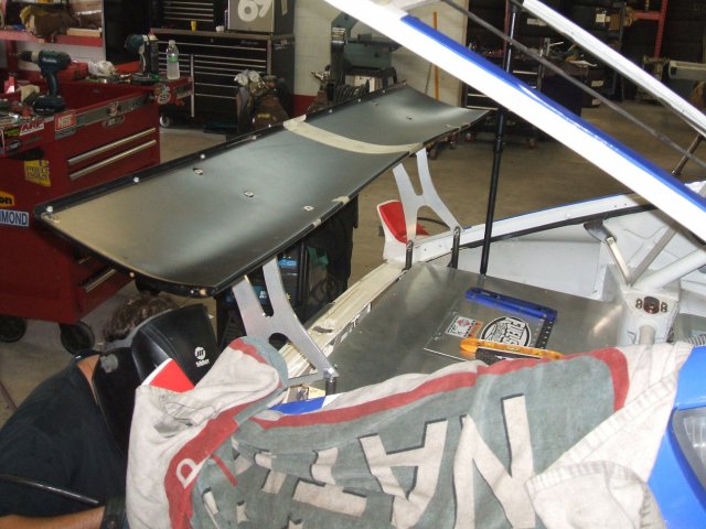

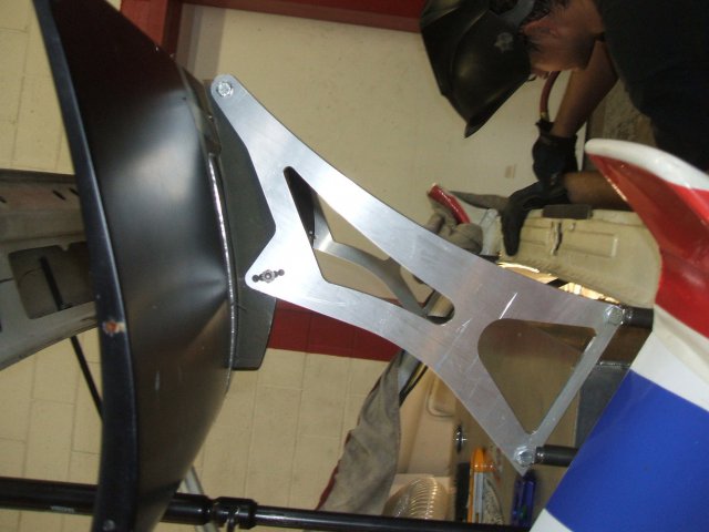

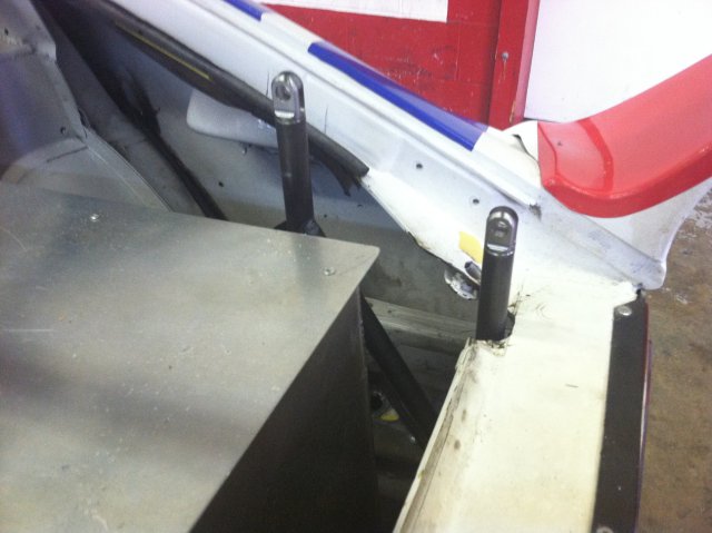

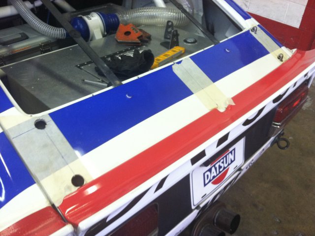

  1. Its always nice to race for a shop that has their own machine shop and cnc machine on site as well as a mechanical engineer to input the design into the machine. Magically out pops a shiny new upright. As you can see the wing is taking shape. Tomorrow we will install end plates and the pin system to secure the wing when the hatch is closed. I gotta say..........Damn. I also like when a project takes shape that I had very little to do with besides the original concept. Letting people do their jobs is a wonderful thing and for a control freak like me it is rare. Matt

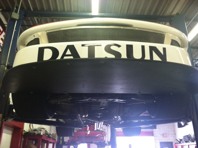

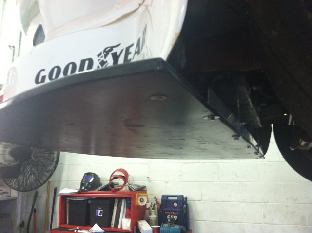

  2. We have studied the effect of the lip on the splitter on our corvettes. Here is the skinny. When you have a 2" lip, like the one on the Z you get great downforce and you can still get it in the trailer without having to turn the shocks 6 times and put pucks in the springs or take the nose off the car. A 4" splitter works better but you cant get in in our out of the trailer without removing the whole nose piece. When we race I have a pit crew with me and they assist me greatly with everything possible. The majority of the time I will take a car to the track with me my tool box and a trailer. I have to try and make things practical. If we were running in a professional series and had the $$$ from major sponsors and all that jazz.........you get the picture. I am starting with a wing that we had on the back of a World Challege Corvette. It is a 60 inch Carbon Fiber static dyhedrial wing. I've attached some pictures. The wing does have end plates, their just not attached in the picture. I just laid it up and took a crappy shot of it. It is actually a very nice wing. The size is just right as the width of the car is comparable. Ive attached a few pictures, probably prematurely, to show how the frame for the uprights are being developed. What we are doing, as the pictures show, the chromoly supports that will be welded to the frame rails, they will protrude from the holes in the hatch, see picture. There are some small billet attachments that the wing will attach via heavy duty billet pins. The wing and uprights are mounted via bolts to the hatch and by removing the pins you can open the hatch for access. This is actually going to be very sturdy, obviously it has to be. When we build a splitter or wing our rule is that you have to be able to stand on it for it to work. The front splitter passes the test as it can support my weight. The wing should but...........like I said these pictures are probably premature. I just wanted to show what we were attempting to do. I will be removing the three piece IMSA tail and I am trying to find just a little 1" lip that fits on some other car and I can retrofit to the back of the Z. (Any ideas would be welcome), I need something to keep the air from tumbeling behind the car. My wind tunnel guys know exactly what we need but we just dont have enough time before this weekend to get it. The three piece IMSA tail has served me well and more than likely I will sell it for a resonable price. Let me know if there is anybody intersted. As well I have a widebody YZ race car front end with the quick release air dam. I had the fiberglass all re inforced so it is very strong. Since you can still buy these brand new, remember mine have been fitted and will go slightly cheaper. I also have a set of rear IMSA flares still in the box. These are from the Frizelle Z molds. I was going to use them but had already figured backspacing on the CCW's. I really dont want to buy 8 more CCW's to change the offset. They are from Brian at z car customs. All for now, This is getting interesting. Matt

  4. Thank you, I was waiting for your comments and I mean that in a good way. As you know more than most, this is new ground and I want to try some different things to try and acheive the best results given our benchmark. I think this is a good start and with the addition of the rear wing, I am testing on track Saturday. I am also having another professional driver do laps in the car so we can compare notes and data from the AIM system. The data aquisition system is going to play such an important role in that it shows exactly what is going on and comparing it to the data that we have without the aero will show our gains...........or losses. Matt

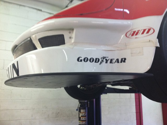

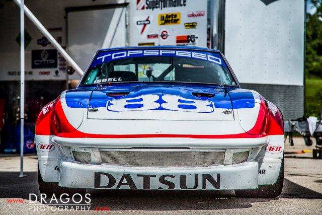

  5. Here is another shot that gives an idea of the new profile. and before you ask why the white tape that looks like crap. I just haven't replaced it after the last race. I do that to fill all gaps and to secure the fittings. I redo it before each outing and the faster I go the less you notice
  6. I love it when a plan comes together. I dont get too excited over things usually but this is something I am floored over. I cant wait to test it this weekend. We have, as I mentioned in a previous post, leveled the front air dam to accomodate a front splitter/undertray. The splitter is now in place and looks incredible. My expectations have truely been exceeded and I dont have a problem saying that there is not another one like it. Notice how the splitter trey's out at the corners to accomodate the air laying on top. This also will make it marry into the side skirts that will come in phase three of the aero project. We have started the rear wing and uprights but I will wait to post pictures when we get more done. For now we have one BAD AZZ SPLITTER...........I hope you all concur. Matt

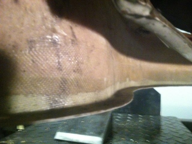

  12. This week we are fabricating a front splitter and undertray in Carbon Fiber. I wanted to document the steps we are taking as this is kind of uncharted. I have seen a few people try and I applaud their efforts, I just feel as if we are approaching this in a 100% function and application over something that looks cool. I have a few guys that have spent a lot of time in the wind tunnel and they are spearheading this part of the build. After our last race at Road Atlanta, where we did quite well. I noticed that there was a lot of time being lost approaching the esses and how other cars around me utilized a much higher downforce setup to their advantage. The Datsun is in an unlimited class so the build rules are minimal to say the least. I love the way the car looks with the three piece IMSA tail and from a historical point it pains me to change it in any way. I however want the car to reach its ultimate potential and to do so is going to require the front splitter, some side skirts for the air to lay on and a 60 inch rear wing. I am just about the only car in the entire group of 40 cars I race with that doesn't have a giant rear wing. Step one has begun and we have taken and cut the front air dam to make it level from one side to the other. We then took and molded a lip in fiberglass for the CF splitter to attach to. We are in the process today of attaching the undertray to the bottom of the car. The next step is the wing. I'll post pictures as we go. Here are a few of the lip we made on the backside of the airdam. Matt

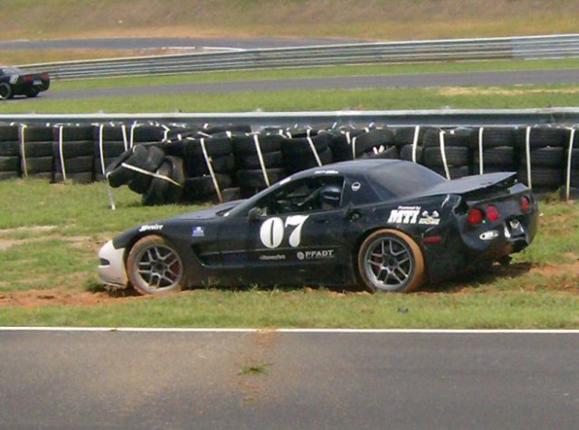

  14. I was having such a great today until I went into the tire barrier at 150MPH. Long story.............and I should have known better, just pushing a touch too hard. Went and got the Datsun at the shop and gonna get back on that horse that threw me tomorrow. I'll just fix the Vette back better than before, but what a buzz kill. and I didnt think the entire course was paved. Did they just do that this year??? Matt

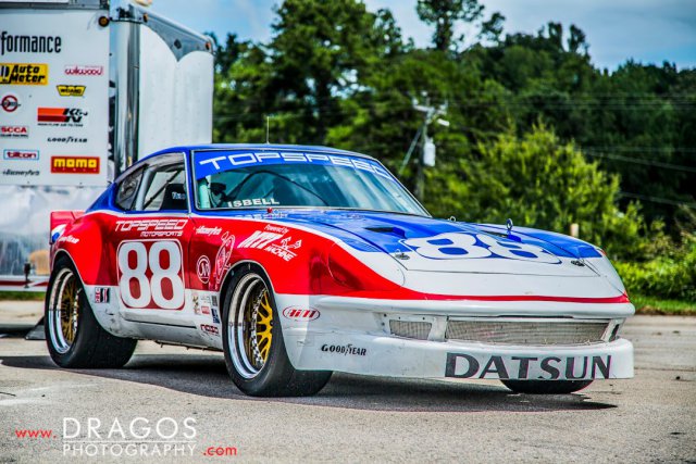

  16. I thought I would post an interesting shot that a photographer did of my car and my Tonka truck at the track this past weekend. I dont get many pics of my daily driver......... I'm no photographer, but I love the lens effect this guy has. It makes things look like candy. Matt

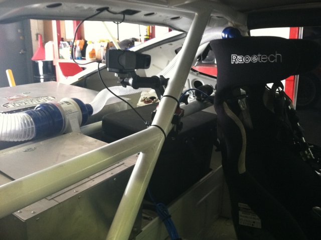

  19. The helmet blower is great. After trial and error I have ordered a little item that I think you will agree is necessary. The silicone fitting that attaches to the top of my helmet is molded and constructed with a bend in the fitting. This is for helmets that have the helmet fitting on the side of the helmet. My Stilo has my push to talk on one side and my hydration on the other. I use a top mount blower attachment. I am having cool suit send me a straight, rather than angled fitting, because it hits the roof of the car while driving. The other fitting will iliminate that problem. Just a thought.......... Matt

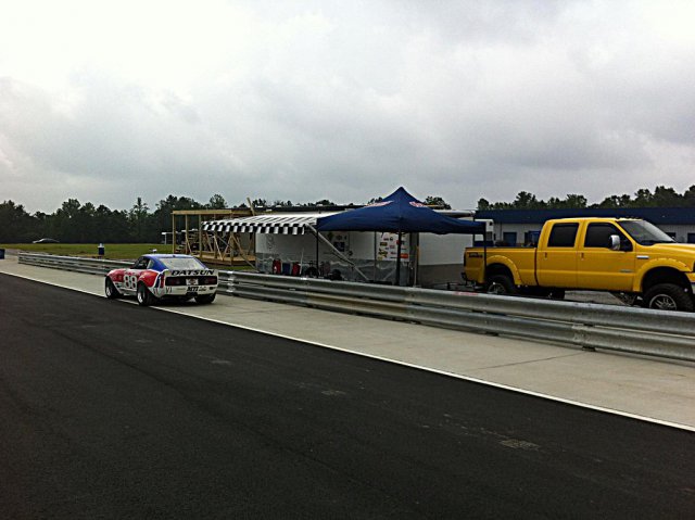

  24. What a wonderful day at Atlanta Motorsprorts Park. The threat of rain, I guess, kept everyone away and I never complain about having the entire track to myself. Love it when I can set up shop right on the grid. Anybody out there that doesn't mind $250 for the day, hit me up and we can take your car to the track and get your skills on. I dont belong to any Z clubs or anything but I wish I could get a SouthEast Z group together for an outing. Next Vintage race for me is at Road Atlanta August 4th and 5th if anyone would like to come out and see the car on track. Matt
  25. Mark, Thank you for the comments and we will meet in the near future. Your input has helped over the course of the build. Attached a picture of the new helmet blower and smarty cam.
