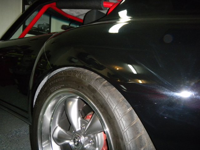

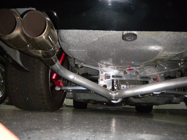

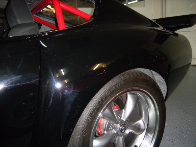

here are a few as it sits in the garage at night. not very good detail as it is black. the angled line visible in the quarter is a clear bra i had installed to protect from rock chips
i would be glad to explain the process as best as i am capable. i started off with a complete GTO rear tub. (great cars) but, as i wanted this to be more in line with what i had in mind, i opted to close up the rear body gap between the rear quarter and the top of the tire. my brother (hes the body man ) was kind enough to endulge me. we cut the rear tub into sections , seperating the sides and the rear panel apart. my brother decided that it would be easiest to order the tires and wheels i wanted to run on the car and then mount the quarters to match the shape and size required.i installed american racing wheels 11 x17 with 315/35/17 tires.then with the tires on we set the quarters in place and refiberglassed and bonded it to the vehicle. at that time we also shaved and shorted the quarters so the rear panel could be mounted flush the to original rear z panel. i have a 1000 pics of the entire process beginning to end.its late here now, but i will snap a few shots and post them right now. if anyone is interested further i can take better pics later and post. i might add that we did install coil overs and completely replace all the stock suspension so we could fine tune it when we finished. i wanted 1/2 inch gap between tires and quarters when finished as well as have the inner fender wells fiberglassed in and finished so we could paint and clear the entire underside of the car. it turned out better than i had hoped for and i have been thrilled to drive and show this car .we showed it at Motorsports west coast nationals a week after we finished it and won first place in modified class...
just in case anyone is interested i am posting a pic of my 74Z it has the rear GTO section. although we did fill in the ducts behind the rear wheels, lower the kits mounting points so it sets lower to the rear tires, shorten the rear body panel about 6 inches so it is flush against the stock rear body panel....
