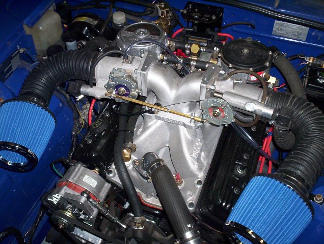

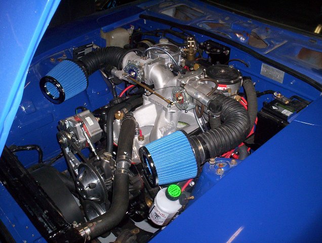

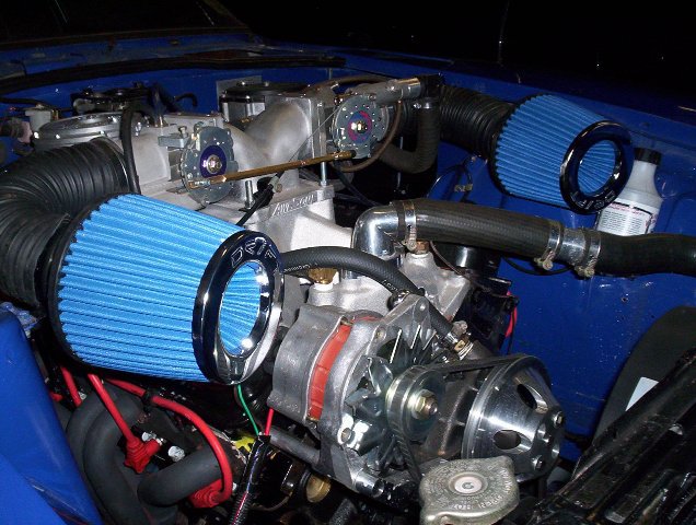

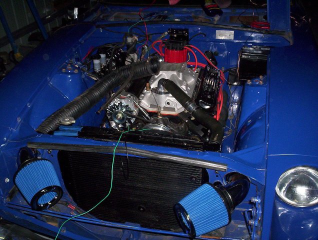

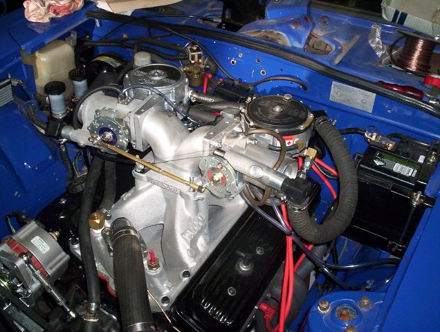

	Crusher, the filters are connected that way just for the dyno tune. I will be running them down to the front of the radiator, later on. Cygnusx1, thw wheels are an Aussie brand called Simmonds. They are a three piece wheel and make custom offsets. Guys one of the main reasons i went for gas research was to pass the emissions laws. When i was talking to the engineer before i started he stated unless its a current engine as in the latest ADR,s then forget about passing. I would of had to go an fuel injected late model chev and my wallet isnt that big. So with the LPG, i pass emission easily, i can rebuild an old chevy small block which saves me big time. I dont need cats, and the thing costs me more than half the price to run. Mike, i am currently running 9.6:1 comp but later a blower is planned. Should be expecting around the 400hp mark.
	Thanks guys, the color i picked myself its just called blue violet and the crane is a darker color but the cheap camera didnt pick that up. As for the gas research, i ordered the parts from the main rep who is based in Brisbane. Go the the website and call the 1800 number you will most likely get Denise and she can advise you on cost and waiting time. They are currently flat out and a wait for parts is on the cards. Price, for a twin system i cant see much change out of 2 grand. I already had a single setup from a previous engine and i bought the extra parts i needed and the extra parts being: converter carbie (matched to ur power rating) manifold linkage and bracketery. was just over $1100. try http://www.gasresearch.com.au Hope this helps. Graeme

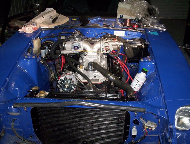

	ok some more pics! Radiator is in and have made some brackets for the pod filters. Waiting on a call from clark rubber to get some new air intake 3" piping. brakes are bled and battery tray fittted with a layer of thin rubber in it for the battery to sit on. I am making the battery leads and re-routing the wires as neatly as possible. Still waiting also on the twin gasresearch carbies and convertors. Back to work tomorrow so the process will slow a bit. I cant wait to hear it though! Graeme

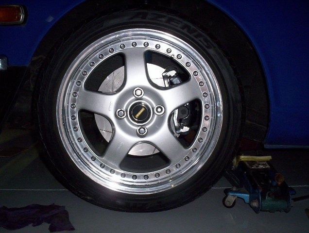

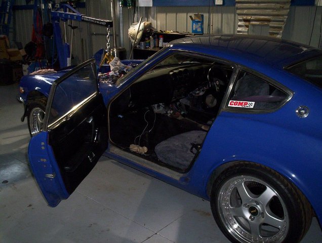

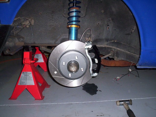

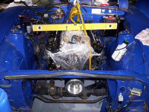

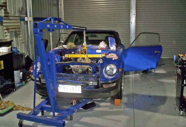

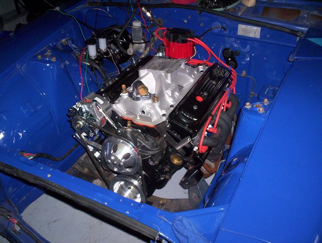

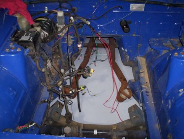

	In the first pic i am about to tackle the rewiring. The voltage regulator and ballist resistor will be removed with other unwanted bits and pieces. Second pic the engine is in, notice the lack of wires now and also the 1" master cylinder for the brake upgrade. Third pic, 300 mm vented slotted rotors with pbr claipers. Fourth pic, a trial fit with the Simmonds for clearance.
	  Aussies please help-chev installGraeme replied to nicedat's topic in Gen I & II Chevy V8 Tech Board yeah good idea Pete, i have the supra box behind mine. I got the conversion off "THE GREAT ROD". I used a universal throttle cable that worked fine for me. For the engine mounts i used the standard datsun with some 10mm plate to set them back and another block of alloy for height. I will try to find picks for you. Graeme
	Bartman, just 15 minutes down the road is a chevy engine importer that have an extensive range of new chev engines. They even sell the LS7 new. I put the exhaust manifolds on today and made some brackets to keep my leads neatly in place, i am totally enjoying myself hehe!!!

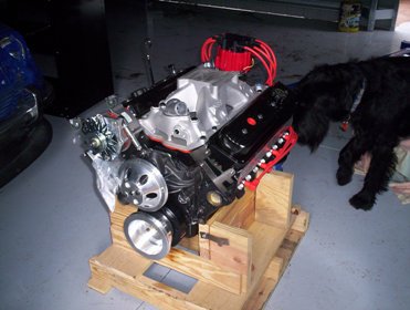

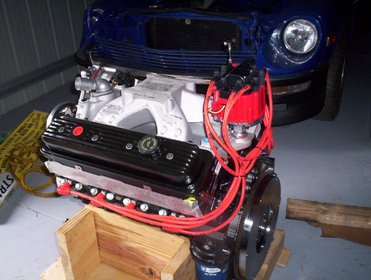

	Finally i picked up my new crate motor!! 400 hp roller cam roller rockers single plane manifold, HEI. I will show my progress as i put her in! Graeme
	  Aussies please help-chev installGraeme replied to nicedat's topic in Gen I & II Chevy V8 Tech Board Hello and welcome, i made my own mounts and got the engine sitting as close to the firewall as possible, its also sitting a little lower than the jtr. i made the trans bracket too. i had my engine in and out 10 times to get it right but well worth it. Just make some.
