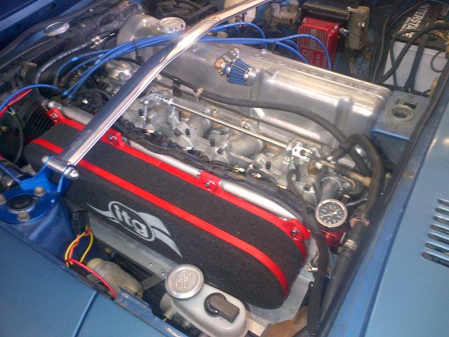

I have a 75 280Z. 6 throttle bodes, stock fuel line from the tank to the motor, 1983 280zx fuel pump, running 43 psi I heard the noise while driving, kinda random but I can make it do it by driving slow in 4th gear. It almost sounds like a bad universal joint. I put it on a lift, with me in it revving the engine at different RPM's Charley said he could feel the noise in the fuel line. Have you ever heard a water line with air in it? "water hammer" Thats how he described it. Have you ever heard of this? Do I need a bigger fuel line?

I have a 75 280Z, it has a n42 with six throttle bodies, the old throttle linkage ties into the new (see attachment). When I try and give it just a little gas it has a stiff point that keeps it from being a smooth acceleration. What throttle cable would work on this setup? Please do not cross post same post in other forums. Thanks
